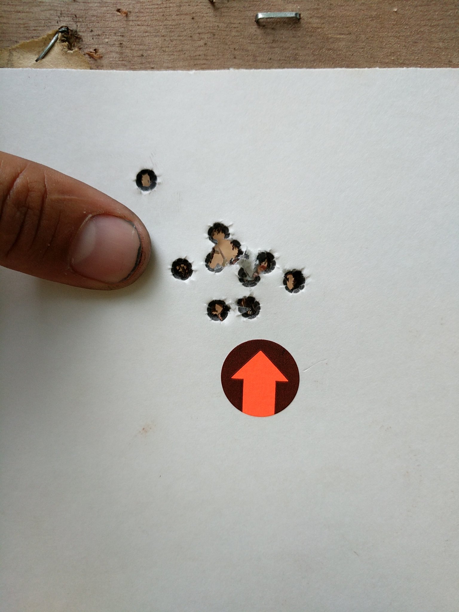

Gonna try and find some sort of accuracy, as my 55gr Nosler BT and 50gr VMax were grouping like they were shot out of a spoon with RE15, 4895 and CFE223....
88 ELD seated 2.230"
26.1gr CFE223
CCI400 primer
Once fired Fired Federal Brass bumped .002
2797fps SD of 12.7 fps
Chrono: 7 shots
10 shots from copper less cold bore. First 5 shots are high left and bottom around the outside. Next 5 are cluster in middle. .75" Dots
100yds -next 5 shots
388yds - 9 shots , played with bipod pressure and lost 1 high and one low. Not sure about low left...1" dot.

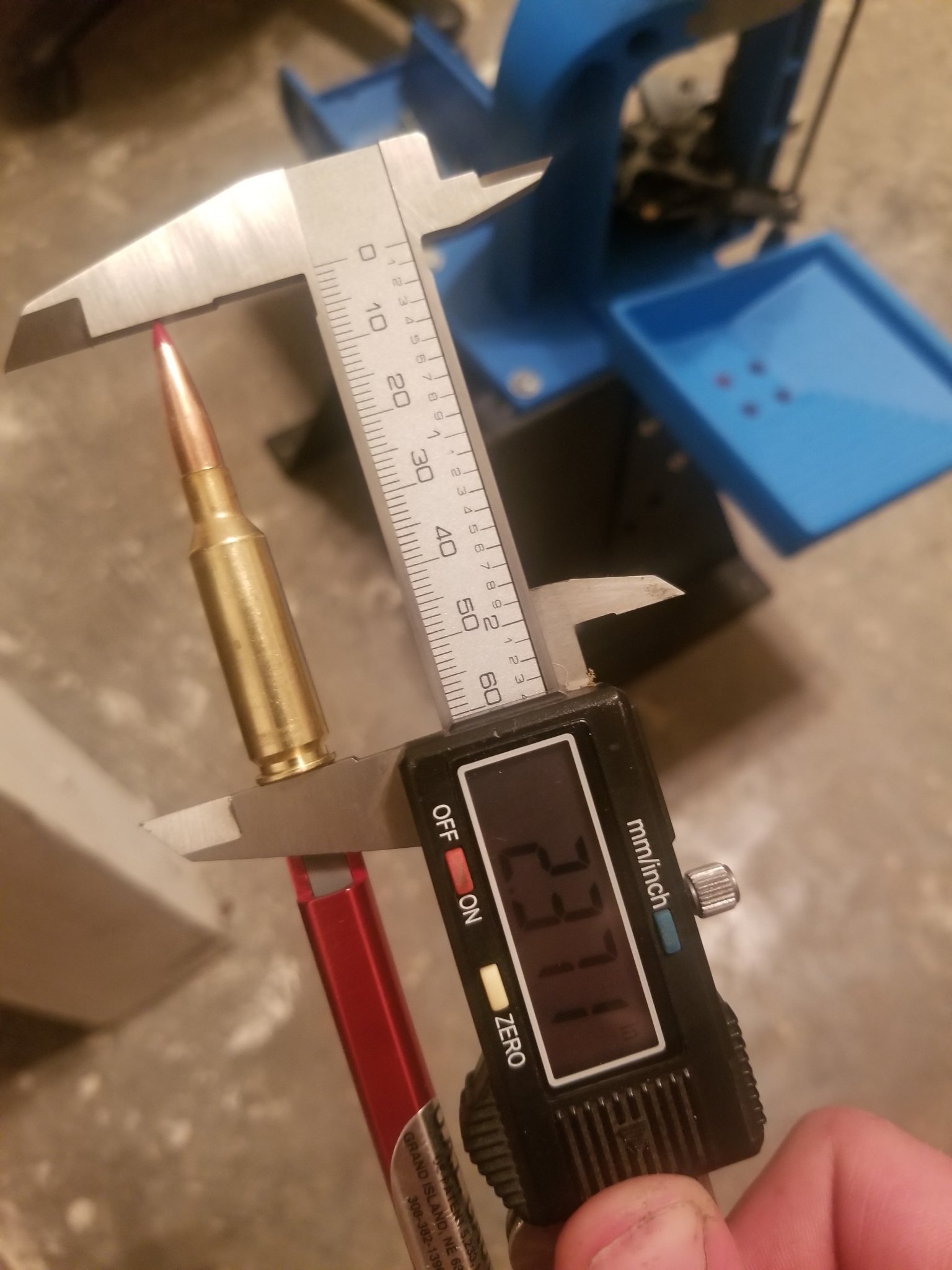

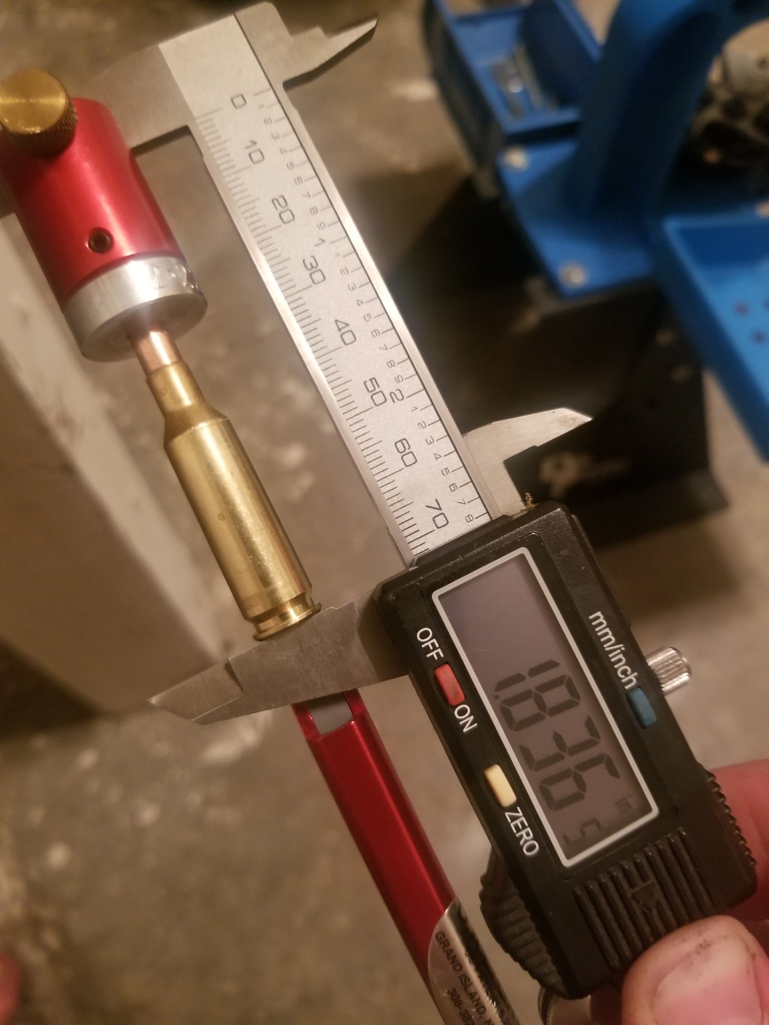

I just finished putting my 224 Valkyrie together. I got the Rainier 18” Rock Creek barrel with the +1 rifle length gas port. I got everything to load for it, but will be shooting the factory 88 ELD first. This thread has some excellent data and many thanks to those who have shared it.
To those with Savage barrels limited to mag length bullet seating:
I measured from bolt face to lands and came up with an average of 1.835. Called savage and spoke with two customer service reps and told them I had a barrel that was reamed out of SAAMI spec. They asked what caliber, and after hearing it was a Valkyrie, they asked for the rifle serial number and emailed me a shipping label. They said any Valkyrie rifle with headspace or freebore issues they want sent in and will do whatever needs to be done to get it back to spec.
I told them (in other words) I didn't want to waste my time sending it in if it wasn't going to get a new barrel cut to spec, and was told that it will come back to me within spec with an average turnaround time of 3 weeks.
