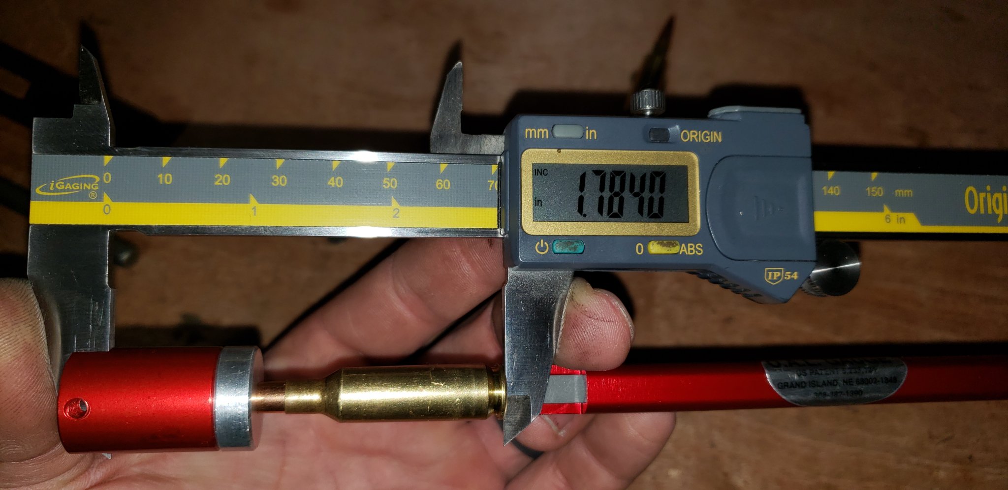

Does these measurements seem right to you all? Is this the "good" saami spec on the chamber, all I can find measurements on the www is for smk's? Just getting into reloading and trying to learn, I took a 3/16" wooden dowl rod and put it through the muzzle to the bolt face, marked the rod at the muzzle, then stuck a 88gr into the chamber and kind of played with the bullet to find the lands and once I did I marked that. I then measured with a caliper and came up with these measurements.
base to ogive on 88gr eld-m's: ~1.766"
COAL with the base to ogive measurement: ~2.320"
COAL with the base to ogive measurement: ~1.766"
I think you've transposed a number... or gotten the definitions of the two measurements youre descibing mixed up a bit. Your first measurement makes sense; the second does not. See below for description and pictures of measurement.
Base to Ogive:
COAL
Base to ogive refers to base of cartridge to ogive of bullet. For that, while your measurement of 1.766 seems close, no two measurements with different tools will necessarily be the same because the diameter of the ogive measurement tools may be different. Also each lot of bullets can have slightly different variations that cause COAL to be longer or shorter even for same base to Ogive measurement.
COAL is "Cartridge OverAll Length" which is the entire length of round (base to tip of bullet) and the word "ogive" should not be referenced as that would be "base to ogive" (your first measurement.).
For reference, 88 ELDM's are touching lands in my chamber as follows:
Base to Ogive (Touching lands): 1.784"
Corresponding COAL loaded to touch lands: 2.337"
My loaded rounds are B2O: 1.718" and COAL 2.271"; -.066" from lands a.k.a "jump".
Note: my barrel has 1500+ rounds through it and has grown forward about .010" since new.
Base to Ogive:
COAL
For reference, 88 ELDM's in my chamber is touching lands measure as follows:
I'm sorry I had made a mistake...I fixed it now
Ok, so based on your measurements and my corrected measurements, those are very close, awesome! Are you shooting a bolt gun or AR?
I figured since the COAL that you was loading was a .066 jump load, that is a FINE looking rifle though! Mines a bolt action so in one mag the 2.320" is all I can run, but other than that I could take and adjust the freebore length and load longer yet.
I actually ran mine at 2.305" for the first 1000 rounds but the seating depth to hit best accuracy from my rifle was about .020" from lands. Unfortunately, I can't Chase lands any deeper so I worked backwards and found that 2.270 is nearly as good.
When I rebarrel or build bolt gun, I'll probably have freebore and throat cut for the 88s to be seated touching at 2.280" so that I can stay seated closer to lands for most of barrels useful life and stay well under mag length. I loaded a few for single feeding at -.005 and -.010 both of which shot great.
