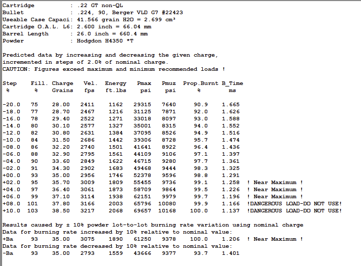

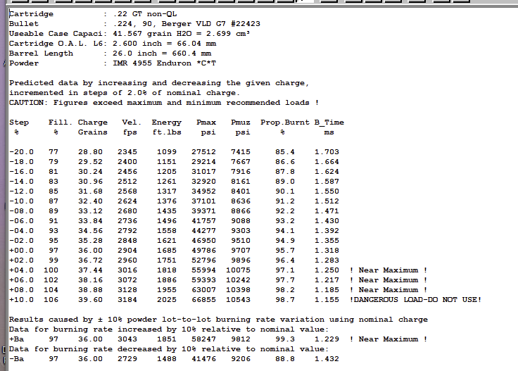

Not sure what bullet you're planning on running, but here's what QL is estimating for 4955 with a 90gr VLD loaded to 2.6" OAL.

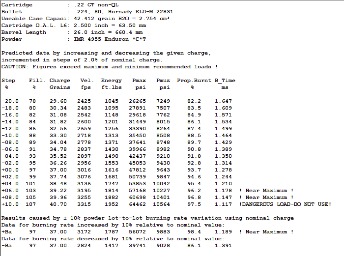

For something lighter, here's data for a Hornady 80 ELD-M loaded to 2.500" OAL:
Note: I don't have my 22GT brass yet (it should be here tomorrow) so I'm using 44.90gr for case capacity which a few other people have measured.
QL's powder test table estimates that 4955 isn't the fastest powder for the 22GT, but it has a good case fill vs pressure relationship and the case won't be too empty if you load conservatively under max pressure nor excessively compressed if you load near max pressure. If you have 9# of 4955 left and aren't worried about chasing max velocity I'd load some up for testing.

The burn rate of 4955 looks too slow to achieve max velocity with the 85-90s, it hits max pressure at a slower velocity and isn't burning fully compared to more ideal powders like RL16 or RL26 which will produce higher velocities at the same pressure because the powder burn rate is different and better suited to the heavy for caliber bullets. It's just not a matter of case fill, 4955 will likely be at or above max pressure with a mildly compressed load (106% fill) but still be below your 3100-3150 target velocity.

I was thinking the case fill versus percentage of powder burned meant it was too bulky not too fast burning?
It's a burn rate and pressure curve issue, not just fill. Fill is more of a guideline; you don't want to use a powder that leaves the case too empty as it might have inconsistent ignition, nor do you want a powder that's so compressed it results in inconsistent seating depths, and crunching the crap out of the powder with a heavily compressed load can break it down into smaller pieces which will alter the surface area of the kernels and can change the burn rate characteristics which can result in weird pressure spikes or increased SD/ES.
For instance, from the tables above 38.16gr of 4955 is 102% fill, yields 59.4ksi pressure and 3072 fps, and it isn't fully burned by the time the bullet leaves the barrel. Even if you altered the density of 4955 to make it more dense per grain (so you could physically pack more in the case) but maintained the same burn characteristics and overall energy content per grain of powder you still couldn't safely put more in the case to reach a higher velocity because it would be at max pressure; the burn characteristics of 4955 just aren't ideal for that case and bullet combo, it hits max pressure before achieving your targeted velocity.
On the other hand, if you use RL16 and adjust the charge to the same 59.4ksi target pressure it takes 35.76gr of RL16 which is 95.8% fill but QL comes back with 3158fps.
4955 is slower than RL16 based on Hodgdon's burn rate chart (RL16 is #129, while 4955 is #145.) Based on the QL data the 4955 burn characteristics aren't ideal for the 22GT even with 90s, so even with a near max pressure load of 4955 the estimated velocity is slower than the more ideal powders at the same or even lower pressures.
Oddly enough, at the same target pressure of 59.4ksi QL estimates the fastest powder for 90s in the 22GT would be RL26; using 41.6gr which is a 101% fill it's estimating 3250fps at the same 59.4ksi pressure as 4955 and RL16 above. What's kind of odd is RL26 is even slower on the burn rate chart than 4955 (RL26 is #157) but obviously the burn and pressure characteristics are different as the estimated velocity with RL26 is much higher. RL26 really seems to be the speed king in many loads that use heavy for caliber bullets, provided there's enough case capacity for it.
QL allows you to quickly "test" a bunch of powders in your case/bullet combo by specifying a target pressure and max fill percentage and it returns results sorted in order of velocity. I usually like to have it run that powder database test around 52.5ksi and 105% max fill. I haven't messed with Gordon's reloading tool but I'm guessing it would have a similar feature.

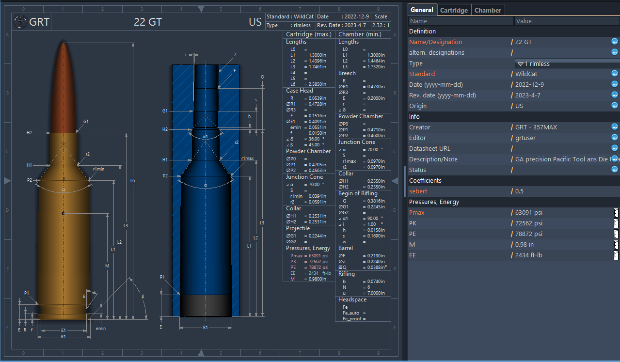

If anyone wants to build 22GT in GRT, this may help.
Start with 6GT in the cartridge builder & then modify with the dimensions shown here.
I used the GA precision reamer print with .169 free bore. Alpha brass. Seven twist, & .219 bore with 6 groove.
Check h2o of a once fired case, & adjust if it's a little off.
I tried to figure out how to export the file, but it must be a bug. If I save it & then try to open it gives an error???
This has been giving me pretty close estimates for the 5 powders I've tried.
Reactions: netcat
