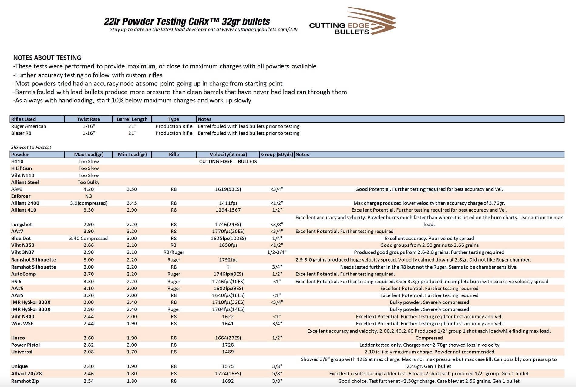

They just released a preliminary list of tested powders for the 32gn bullet, there are quite few options.
Wonder what powder and how many grains work?
The recently published the testing results they did. Here is the image. This was on the 32 grain bullets. 1:16 twists

The BC is so low on the 32 what is the point? Maybe can create a more consistent load?
I think the point is to have a bullet that can be used by everyone who doesn't have a faster twist barrel. Whether it's worthwhile is a good question.
The cost to reload with the 32 grain bullet is $70 for the bullets and pre-primed casings -- or $17.50 per box of 50. That's a lot of money for reloading ammo for which there is little published evidence for it being at least equal to similar costing factory match ammo from any of the big three ammo makers.
It would have to shoot better at 100 yards for it to supplant similar priced factory ammo. If it can't do better at 100, would it do better beyond?
No one knows until these are live and we have been able to work with them. But if you can shoot a 32gn pill at 1600fps that will be significantly flatter than a 40gn pill at 1080fps (close to 10 feet different at 300 yards), and it would still be supersonic at 100 yards.
Will the lower BC/greater wind drift offset this? Will it really transition to subsonic gracefully? Can you really run it successfully at 1600fps? 1450 fps?
Or even more basically, will the quality of the primed brass be good enough to get enough usability/consistency to realize any benefits at all?
But it sounds like it will be fun to try :)
