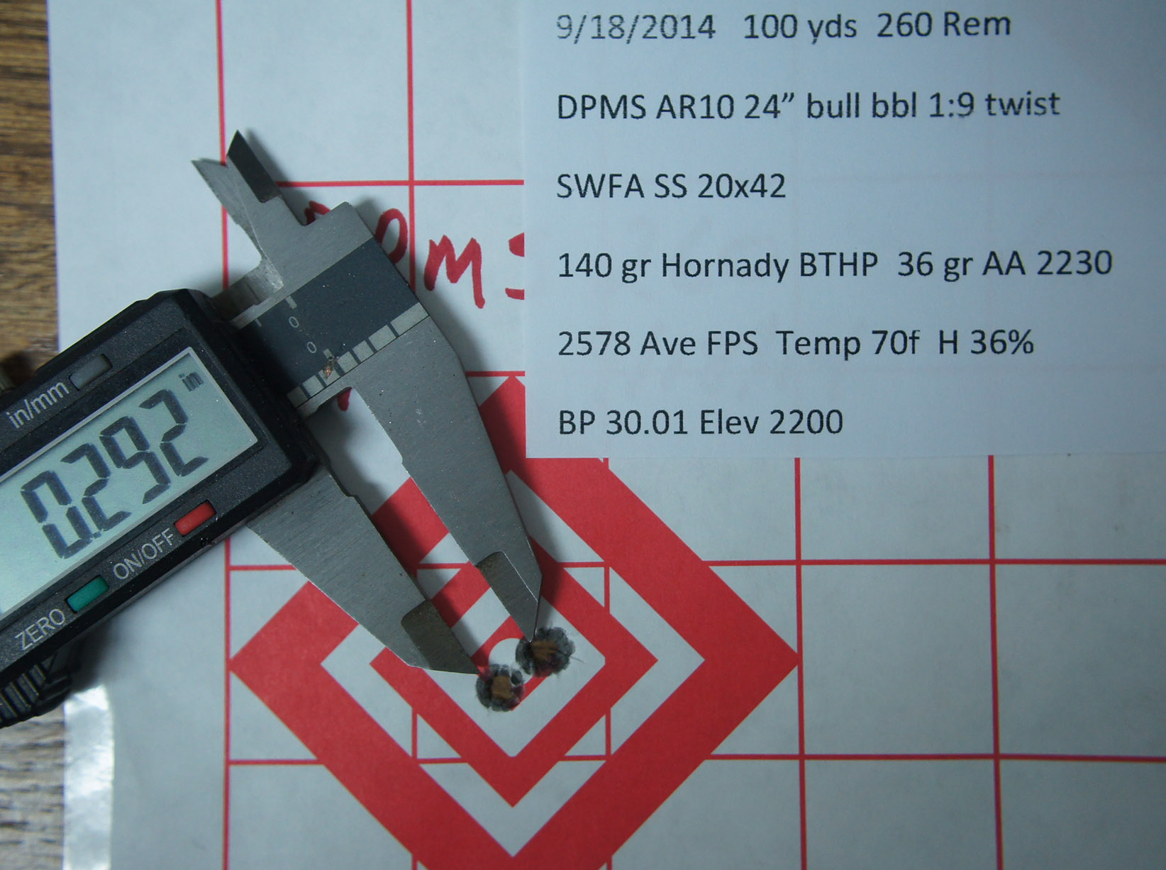

Went out yesterday to re-zero the rifles because I demounted the scopes to adjust for proper eye relief. These 3 shot groups are off a bench rest. The DPMS AR10 seems to be out shooting the Savage 12 bolt gun.
I also measured bullet drops with a 100 yd zero. The DPMS doesn't drop nearly as much , 3" @ 200, 13" @ 300 , 46"@ 500, The Savage drops 13"@ 200, 28"@ 300, 74"@ 500. Identical loads and twist rates. I'm going to go out for 500 yd groups next week.
