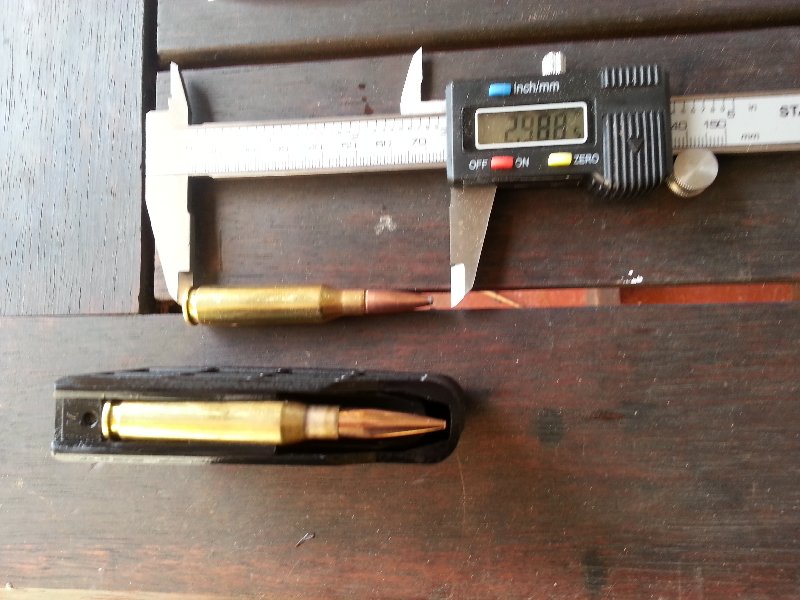

COL @ 2.960"
Speed 2808 avg with 12 shots. 11ES / 5 SD. It's super consistent and have only shot it to 700 yards so far, and is holding under half MOA easy.Super impressed with H4831 so far. Varget and H4831 has been really top performers in my rifle.

I cannot fathom why you guys load to 2.8 oal - almost no rifle does not allow you to get much closer to lans. My two savages criterion and shillen in 1/8 both allow me to run all 140 class bullets at 2.85- 2,9 range. Now if for some reason you bought a short action with way short mag capacity, then it makes sense but nobody except ar/fn crowd need to shorten to book listing of 2.8. I get 2850-2880 fps on all the 140 class bullets with no pressure using a variety of powders ( vit 550, imr4350, n160 are great for this bullet weight). lighter bullets can use varget or rl15ish powders. I would never tolerate a meager 2600 or 2700 speed out of a 260 in the 140 bullet range. Then again I barrel my own savages with good quality barrels ( not sloppy chamber) and know they are not factory slop headspaced. Remember improperly headspaced chambers can show pressure signs on brass. if I could only get 2650 range in the 140 bullet, I would buy a headspace guage and see what is going on. And my barrels are 24" and 26" varm contour. Not ragging on you guys but anyone who thinks book velocities are what to expect does not know what they are doing and might as well buy factory ammo. The most accurate book for me seems to be the nosler one, but even it is around 100 fps slower than what I can easily achieve.
