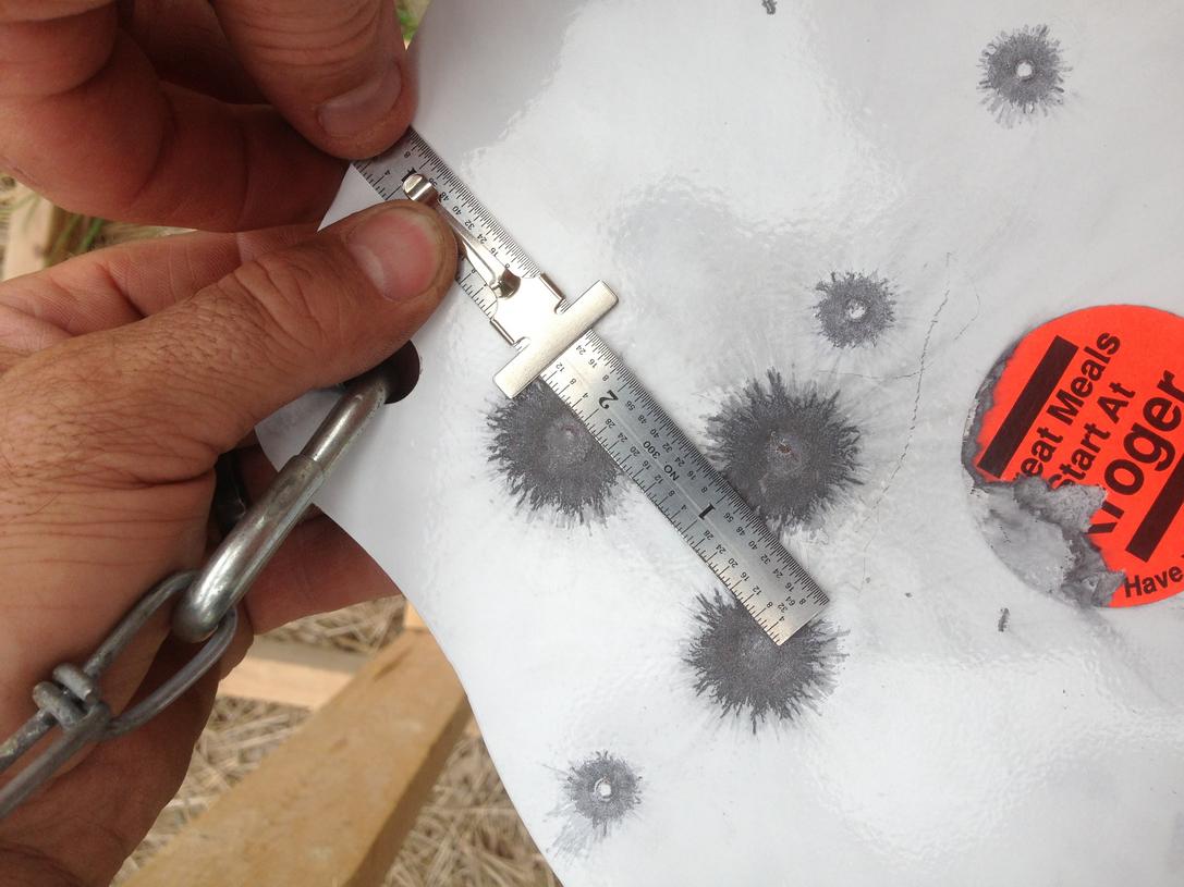

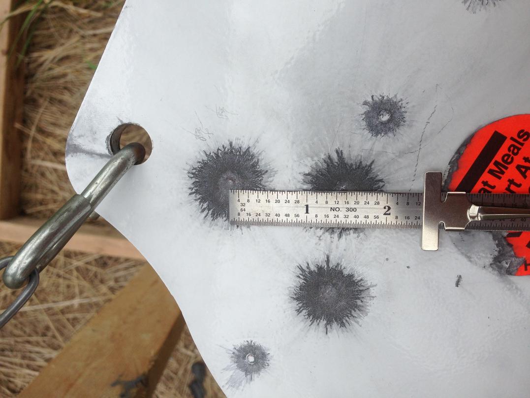

Shot this group with my Savage LRP 260 at 453yds, I shot the two closer shots (1.5" apart) and a friend fired the 3rd, 3 shots- 2" group. 43.1gr H4350, 2.850 oal, 142gr SMK, 1x fired Lapua brass, CCI 200 primer -2825fps Av
