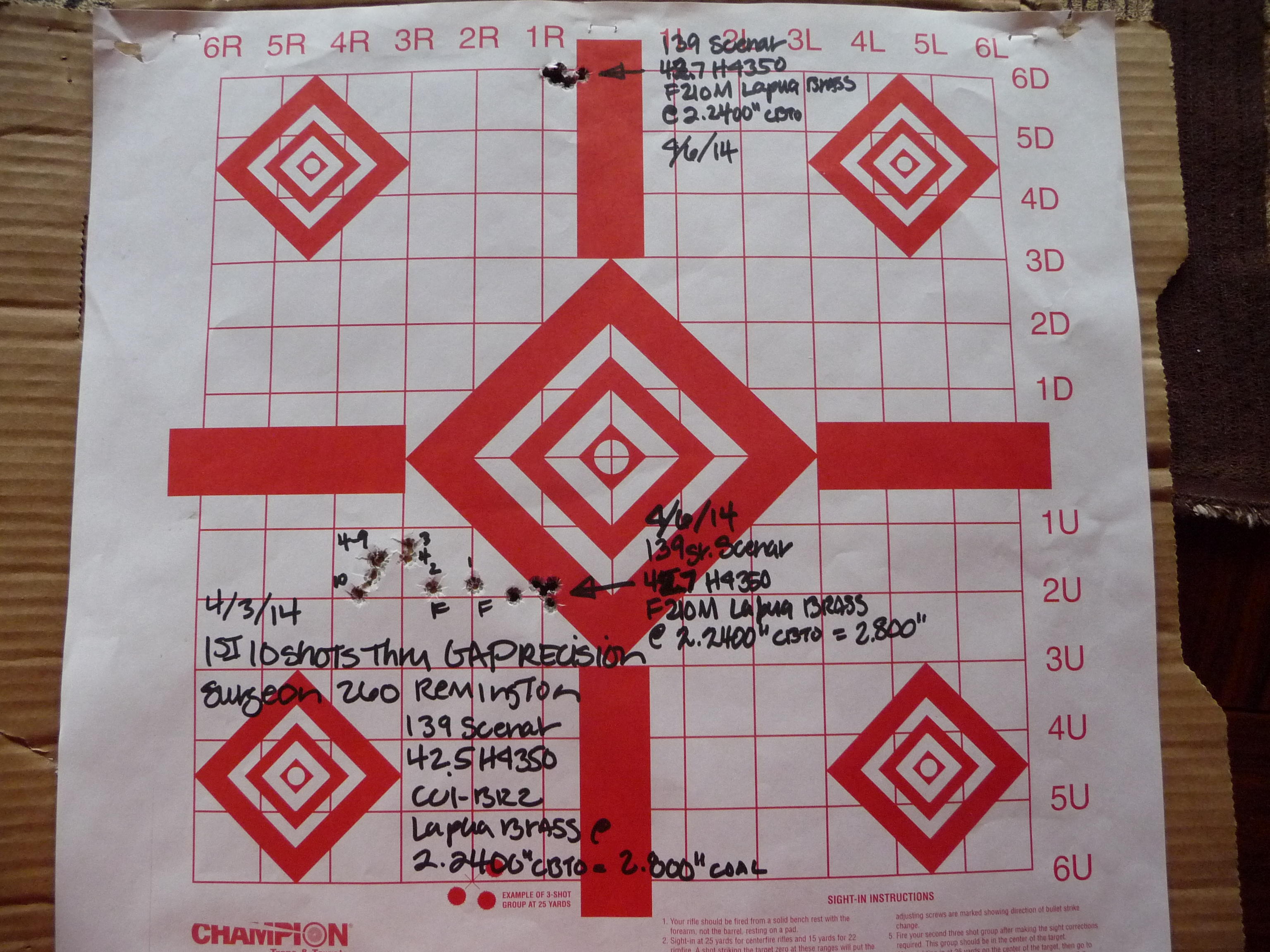

Here's a quick work up on a used GA Precision 260 Remington George put together himself on a Surgeon action I just acquired two weeks ago. It wears a 24" Bartlein R5 1:8.2 twist MTU barrel in an A1-3 McMillan stock.
First 10 rounds through the gun were:
139 Scenar
42.5 H4350 (two different lots, one was over a decade old, the other was from 2006).
CCI-BR2
Lapua 260 brass @2.2400" CBTO = 2.800" COAL .0175" off the lands.
Velocity 2725@ 20' using an Ohler P35
ES: 19 SD: 6
The next 10 were the exact same only using 42.7 grains and a F210M primer, which really tighten up the group a bit. I had only looked down the bore to sight this gun in so hence the reason why they are so far off to one side of the paper. Not sure how I messed up the round count written on the paper, but I did? Either way it is 5 shots into a decent group once the gun settled in.
