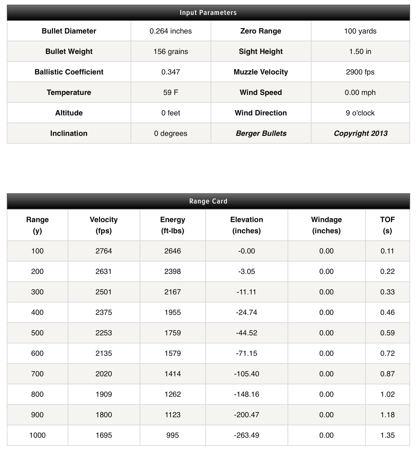

Is 2850 a realistic number for 156 out of a 6.5 PRC? I'm getting 2790 from a 26" 6.5CM.

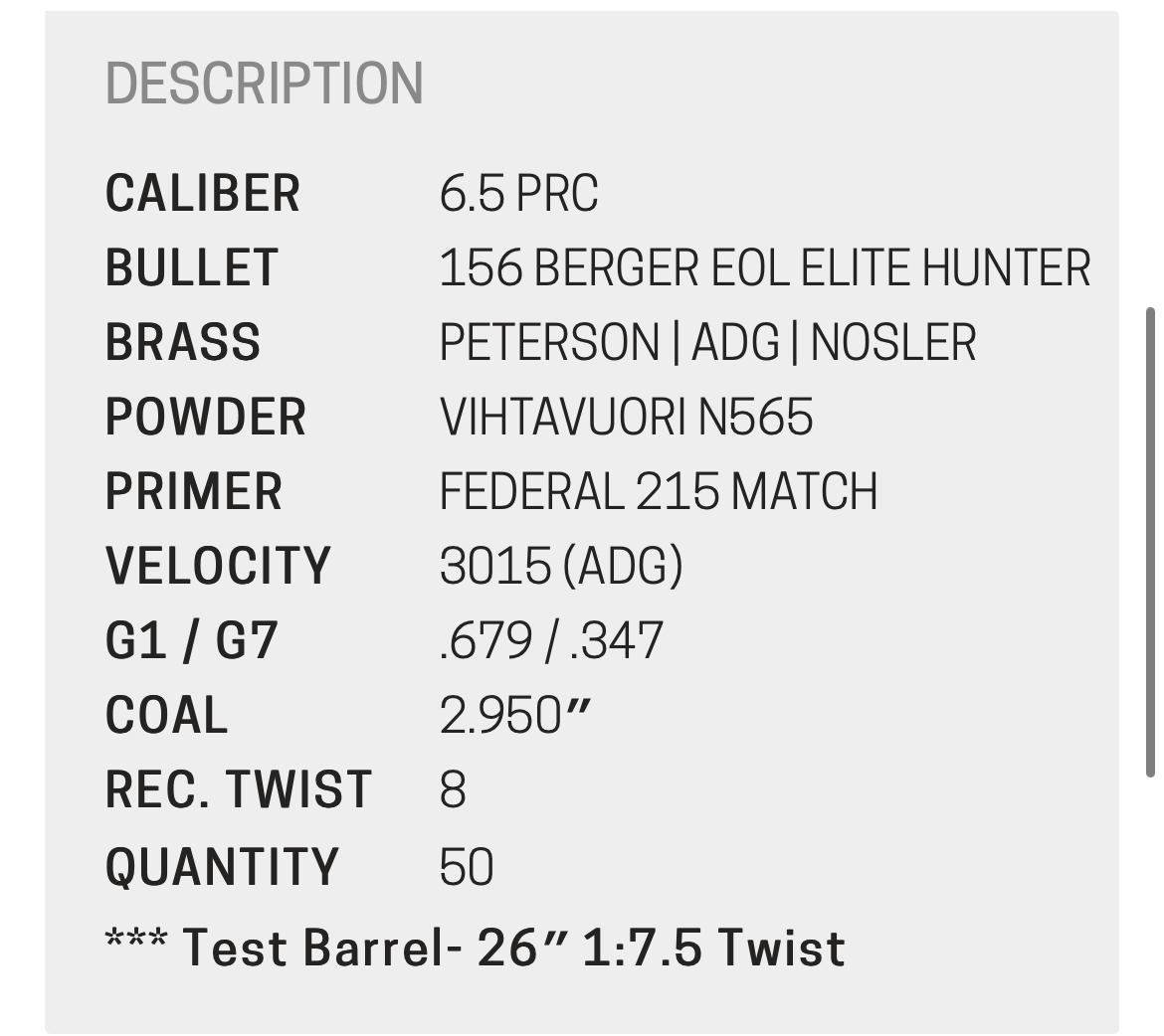

From most accounts I’ve found that’s really slow. My 6.5 PRC shoots the 156 bergers at 3015 with N565. 24” barrel.
Not the exact same bullet, but you're likely above max chamber pressure. N565 is listed as max 2707 fps from a 24" barrel with a 153gr a-tip. VV data is pretty conservative and the bullet has a different bearing surface, but even UR, who tends to have "spicy" loads, maxes out around 2922 fps with a 24" barrel, 156 EOLs, and 56gr of N565: https://ultimatereloader.com/2021/06/27/ultimate-6-5-prc-hunting-load-berger-156-elite-hunter-n565/ and based on past load data from them, it is also likely above SAAMI specified chamber pressure.
I think 2800-2900 range is probably a safer bet in the 22-24" barrel length range for 6.5 PRC w/ 156 EOLs and N565.
Pressure is fine. No heavy bolt lift. No swipe marks. Primers are fine. I do not put a lot of stock in the load data from VV. N568 is listed as being capable of producing faster loads than N565 is with those bullets yet from research I pressure out along faster with N568. One thing to note is not all barrels are equal. I have two rifles chambered in 6.5prc. One shoots faster than the other. I’ve seen data from guys shooting that bullet faster than I am with with the same powder but more charge and with RL26. The websites are great for data but they aren’t hard facts until you test them yourself. That’s why people should work up loads. Different components matter as will.
