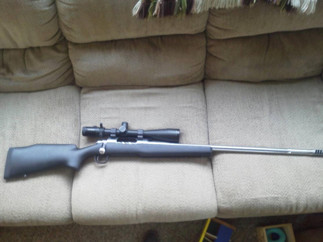

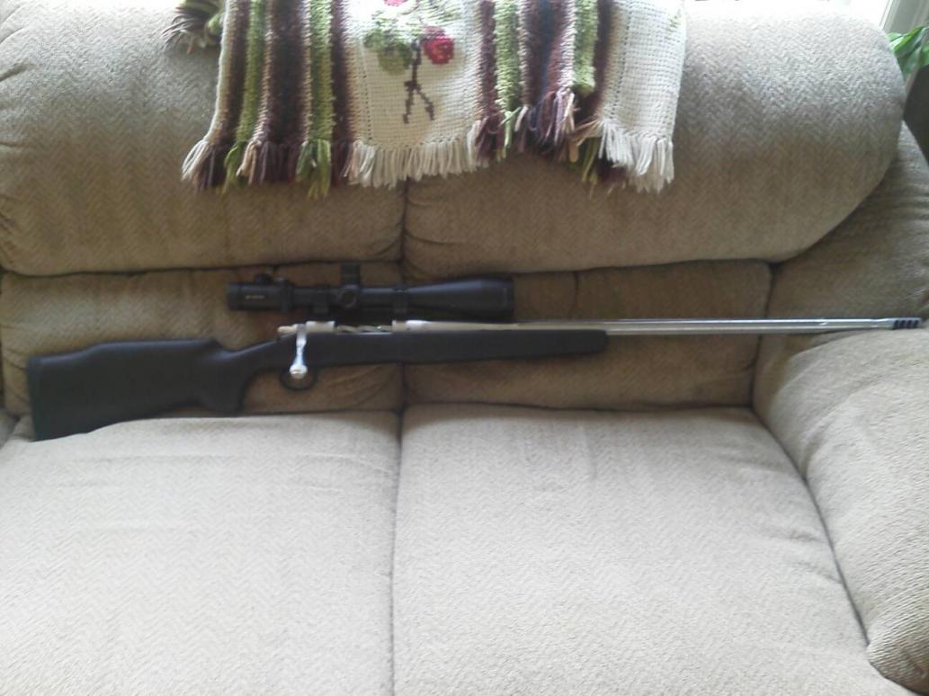

Would love to see pics of this gun.
Thanks Doug

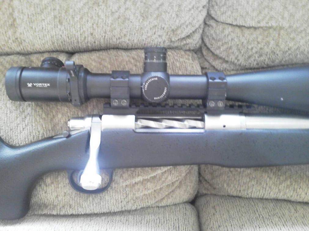

That is a fine looking stick! Is that a remmy action or a custom? What is the OAL will it fit in a standard long action or be better in a cip?
It's a semi true'd 700 action. Action lugs and face true'd up... PTG bolt and factory BDL bottom metal. Still have to open up the feed rail to allow the case to load. Overall length isn't even an issue with loading. I loaded these to 2.670" from the ogive which is actually less than my 280 AI.
Mike
Sent from my C771 using Tapatalk 2
