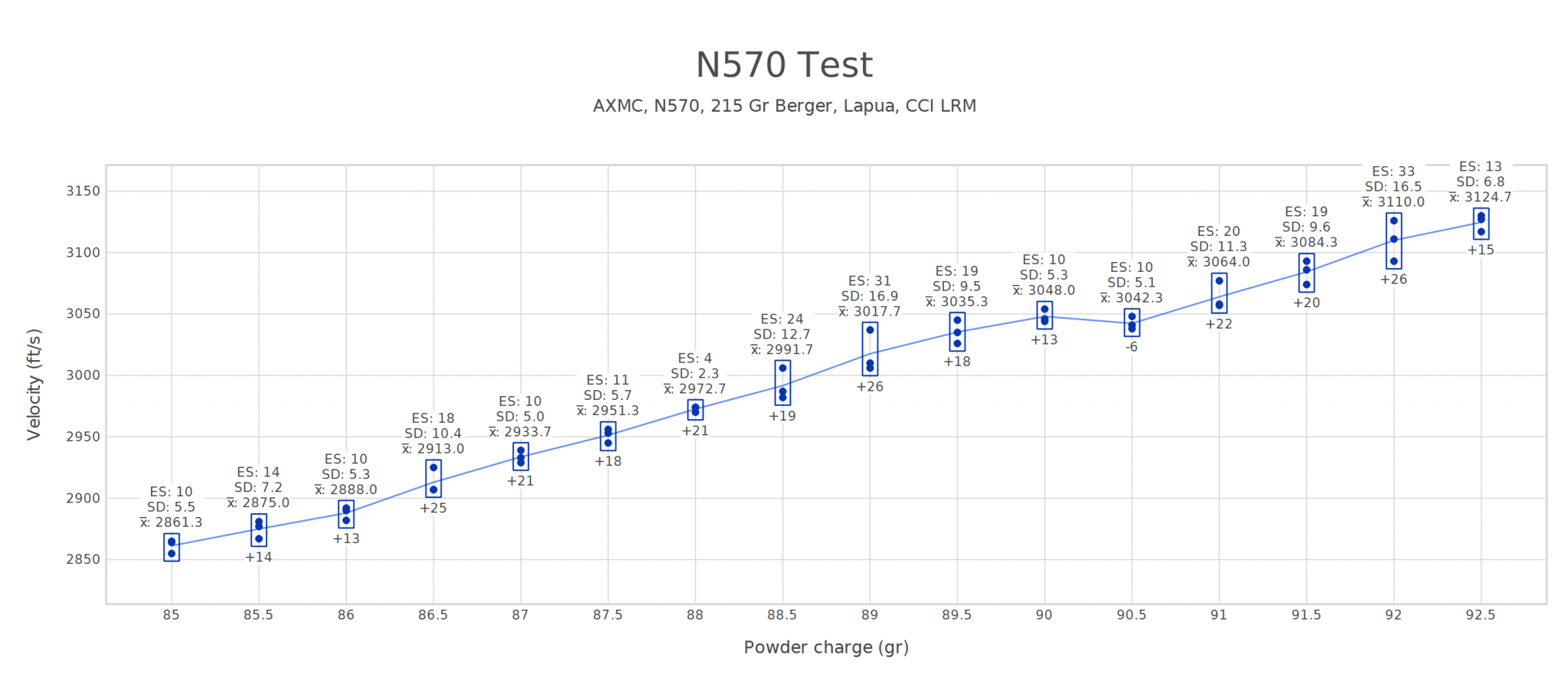

Started to do some load testing with N570. Don't know if I want to go any higher, not really getting any pressure signs just yet, but I know it's getting close. This is 2 weekends of data. Need to play around with the seating depths next time out.
i'd run 90.5 and call it a day
