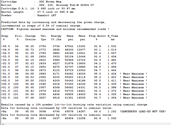

Thanks, that’s reloader 50 from alliant was looking to see if there was difference with Hodgon h50bmg. @Kopfjager1 thanks for the max. That’s too slow. 😞
I just did load development with H50bmg I’m my 300 norma Improved. I started at 88 grains and got 2750 FPS went all the way to 96 grains at 3150 fps and still no pressure signs but it’s going to take a drop tube to get any more in the case. This is by far the best powder I’ve tried out of Retumbo, US869, H1000. I know N570 is the best but it’s fairy dust to find.
Reloder50 works too, I ran 230s up to 3050 in my 26" barrel, gets a lil crunchy tho, I tested rl33 too and it'll work but I don't remember the numbers. My barrel been shot out for 2 years, getting the new one cut now, it'll be a 23" 9tw rem varm for hunting.
I've been using 91.5 with RL33 and I'm getting 3050 out of a 27"
It’s probably the best powder for performance with this cartridge, so I guess the case fill is…great? Sure, they’re big kernels, but they fit.
They big, but dense. They weigh like 0.08gr per kernel. I rememeber using a razor blade to cut them in half to get my exact desired charge weight poured by the auto trickler lol.

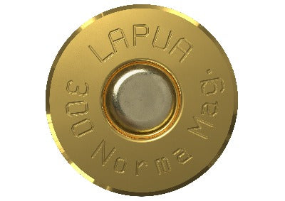

Just received my new 300 norma brass. The necks come .3465 I'm guess going to have to run a .338 bushing. But waiting on shell holders and I will run them threw mandrel and load a dummy to see. They seem very tight necked. Got barrels dropped off and action is at smith's so within the next 3 weeks it should be done
Reactions: Balor
Midway has good prices on lapua 300 Norma brass. I'm posting it here so I won't be tempted much longer haha.

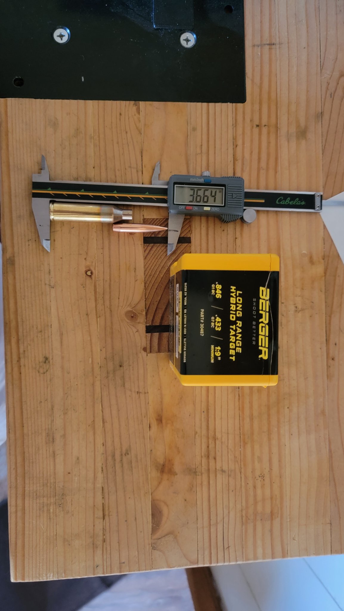

On another note, manson reamer at .2148" freebore should work just fine with the Berger 245gr LRTH. Both brass and bullets seem to be popping up lately.
