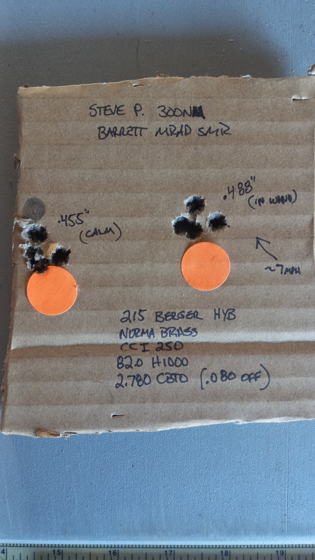

Hey gents, hoping someone can help me out here. I couldn't find what I was looking for in the last few pages.
Forgive my lack of knowledge on the 300NM. I've got my buddy's MRAD SMR with me for a bit, and was messing with it today. I'll be working up a load for him, but he did leave me a box of factory Norma Match with the 230gr Berger Hybrid.
Ho-Lee-Fuk. His rifle hammers with that load. I only shot it at 100 and 385 from my porch today, but it cranked out a half-minute group at 385 (2").
I'm no longer interested in trying to develop something new, but rather sleuth the factory load. I've got all the measurements...but it is using 86.3 - 86.4gr of a powder that I am unfamiliar with. I'll attach a crappy photo of it.

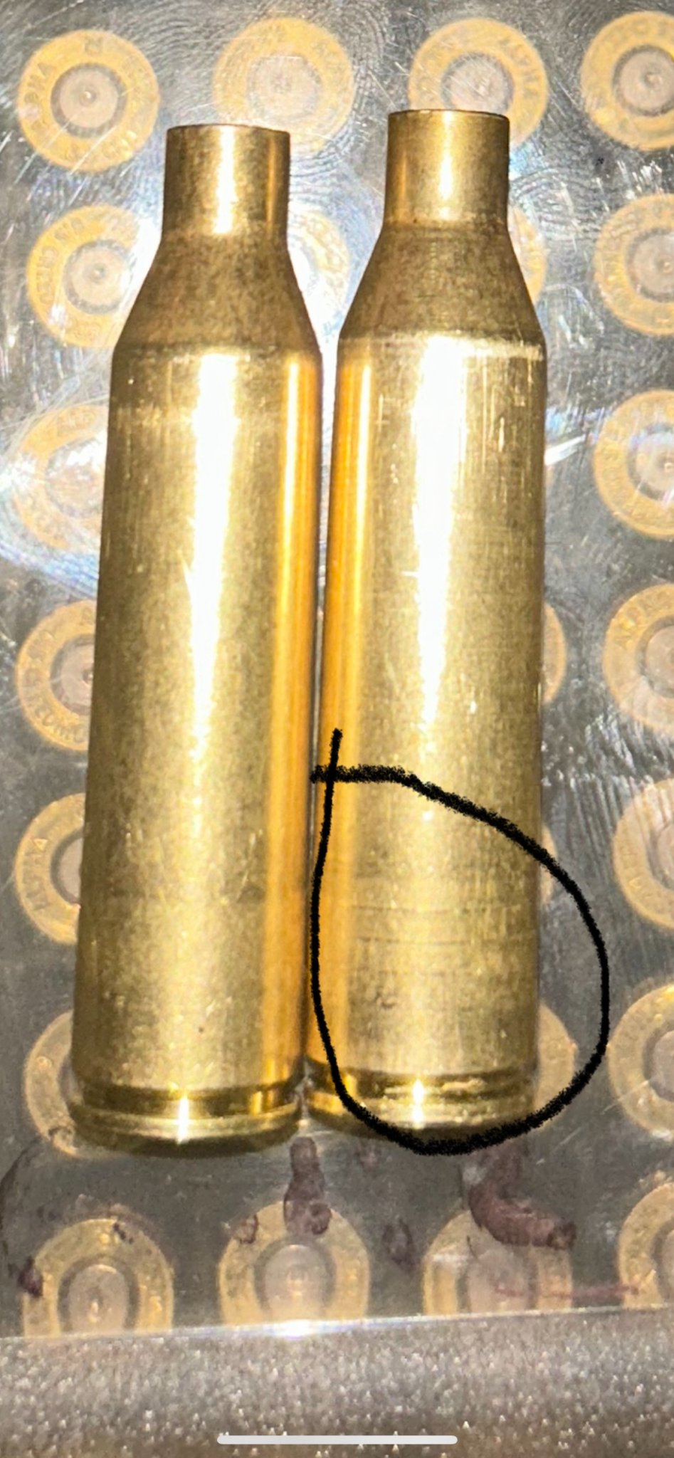

Was hoping to get some help diagnosing my Norma build.
I've got 18 rounds down the pipe and 2 light primer strikes.
The firing pin channel did have a tiny bit of crap in it so I cleaned that out.
Headspace:
Zeroed on go-gauge
Fired brass +.003"
Virgin brass -.0065"
Primers are seated -.008" (on primers that didn't ignite) CCi 250's
This was all measured with calipers so take it for what it is. Is this where my issues are? Or are these numbers inline with what you guys are seeing?
Reactions: Balor
What kind of trigger do you have? Way back in the day, I would get light primer strike with a Timney trigger. Turns out the sear engagement was off on the trigger causing this issue.
Your brass is growing near 0.010" and your seating primers 0.008" deep. I'm not surprised you're getting light strikes. Lapua brass shouldn't be 0065 short of gauge, then ur Smith cuts to go +003? Headspace sounds a bit deep. Stop seating your primers -008, only go to flush or max of -002 until your brass is formed.
Reactions: Balor
That's kinda what I though with the tolerance stacking. I cut the chamber but didn't think it was long but the numbers don't lie.
The headspace isn't a big problem other than the fireform pains. Lapua is tough stuff and likely won't be fully formed for a few firings. Primer depth will make a difference on consistency of ignition.

I just chambered a barrel and set headspace to my current lot of Peterson brass. The other 300nm I have on hand is chambered by Bartlein with an identical reamer and headspaced to the gauge. That barrel is .010” deeper than the one I did.
Saami was recently released. The 0.455 shoulder headspace datum line has a 0.010 range. Seems a bit excessive. If I were chambering a new 300nm barrel I'd prob use a new piece of brass as go, and chamber 0.003 deep of that.

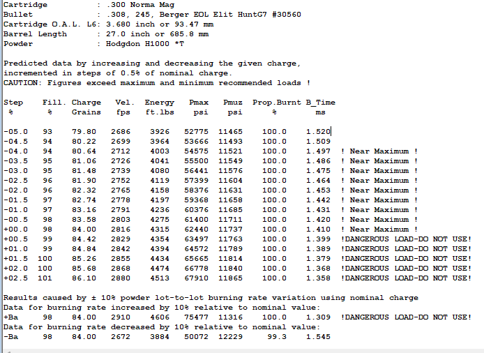

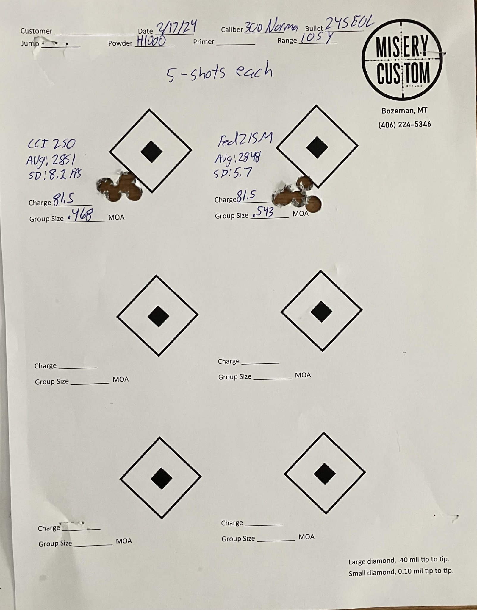

Ive looked all over the internet and can't seam to find anything on 245 eol bullets in a .300 norma with H1000. Seems like most guys are running N570. I have a couple jugs of h1000 and would like to stick with that if possible. Does anyone have any loads they would like to share with this bullet powder combo as well as velocity they are getting? I'm using Lapua brass. Thanks
H1000 works great with the 215 gr. bullets but it's a bit to fast for the heavies. I can't find N570 so I've been using H50bmg and Staball HD(same burn rate as Retumbo).

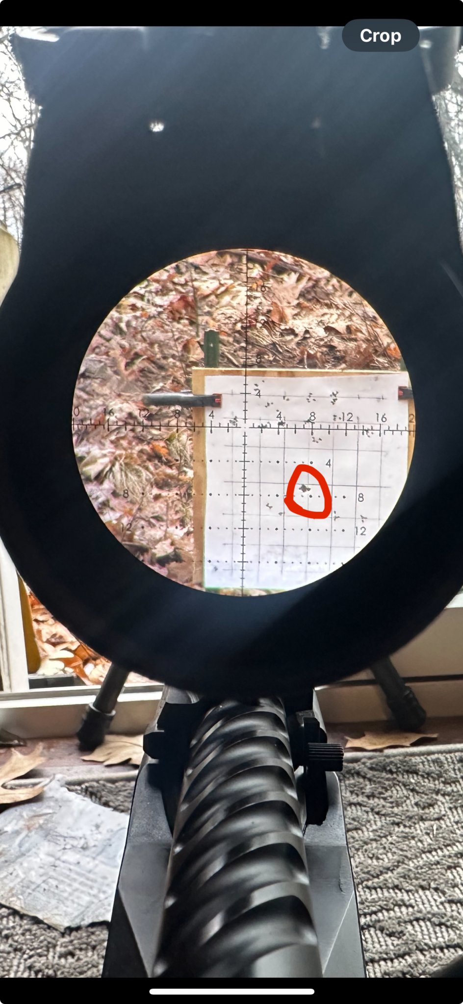

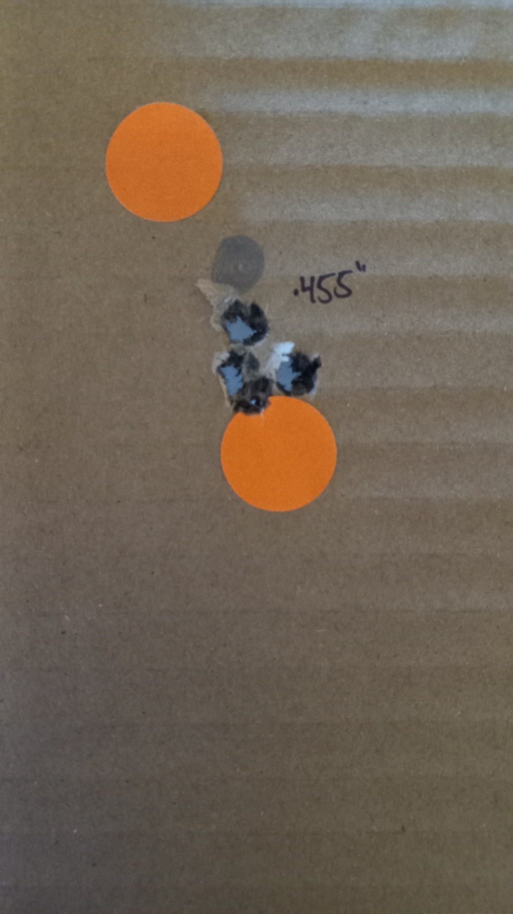

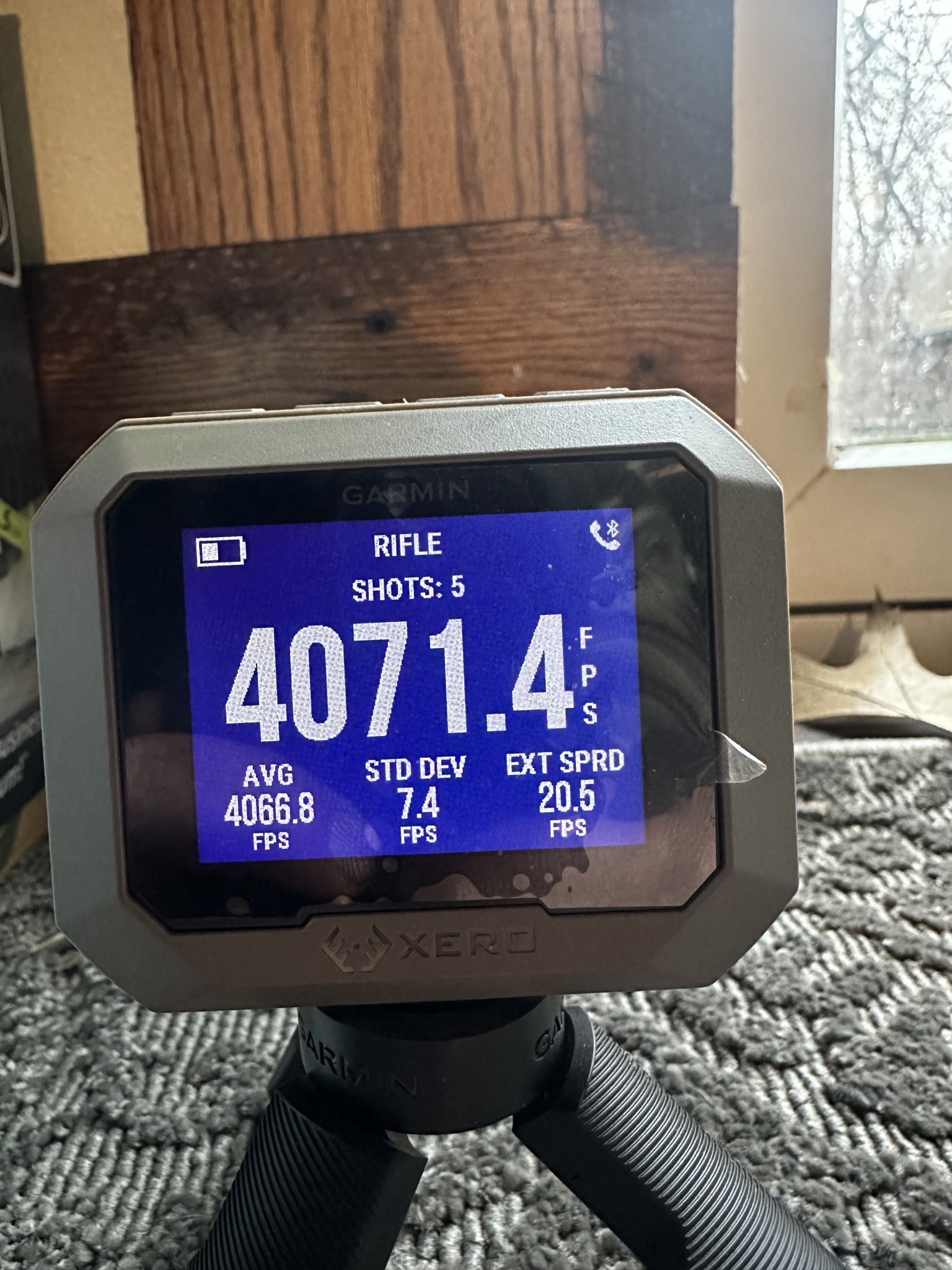

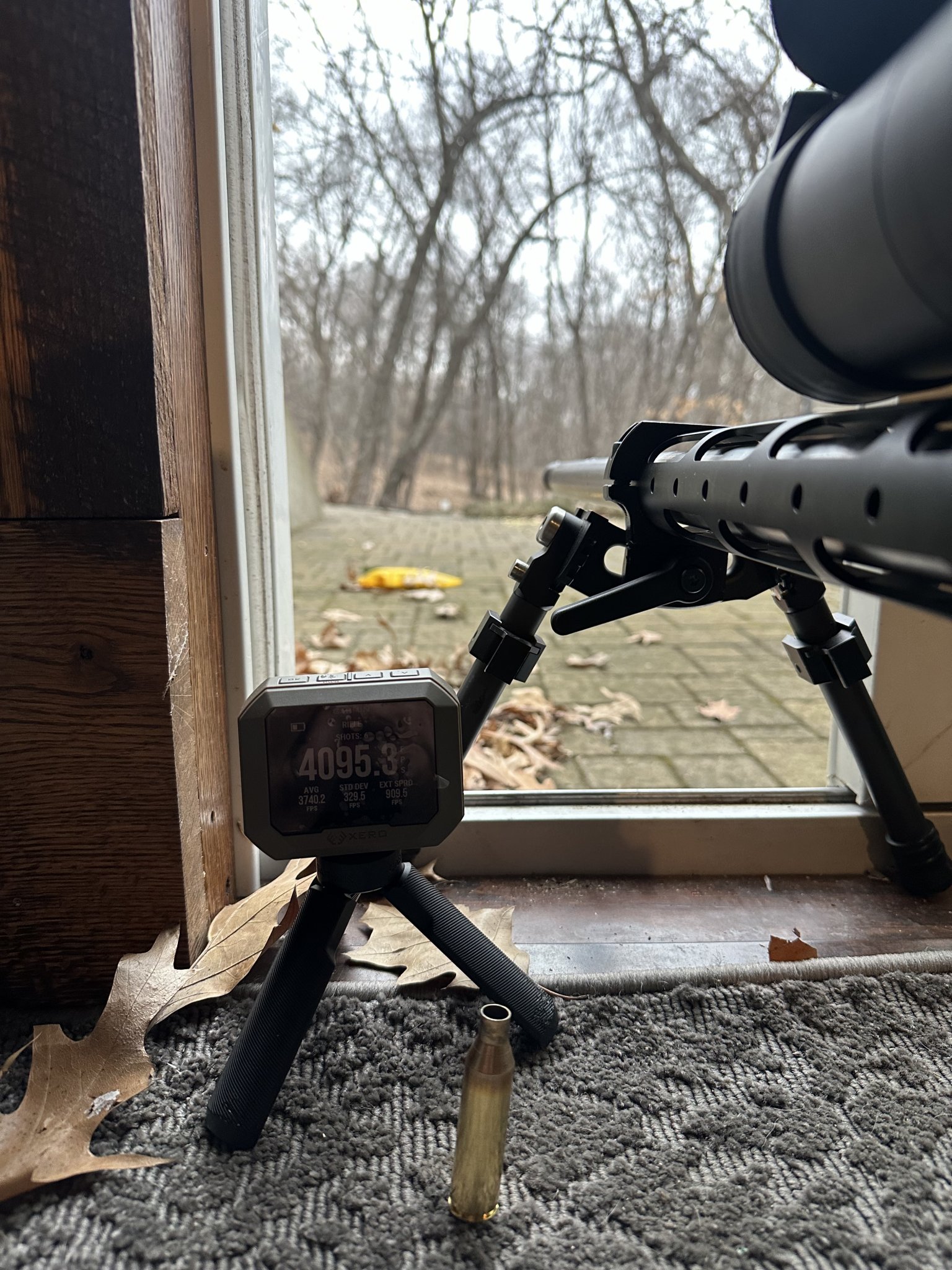

Just started playing with my buddy's 300NM. It shot great with factory 230gr Norma stuff, but all he had for supplies when he dropped the rifle off with me was 215gr Berger Hybrids and H1000. He has 230gr Hybrids and N570...but that doesn't help when you don't bring it 😄.
Anyway, just did a few rounds at 2.800 CBTO (.060 off), and worked my way back in .010 increments. I used 82gr of the H1000 as a safer starting point with CCI 250s. Third group showed promise (100 yards) at 2.780 CBTO.
I grabbed my inertial puller and hammered the next set out before re-seating at 2.780. I had to take a break, but got back this afternoon to test fire again, and was happy to see this despite the wind picking up a little.
I'm still cautious, but I'll try this at a bit of distance and see if it continues to hold up. I also need to get it over my chronograph and bump up charge weight until either the accuracy goes away or the velocity gets to where I want it.
It's a good start
