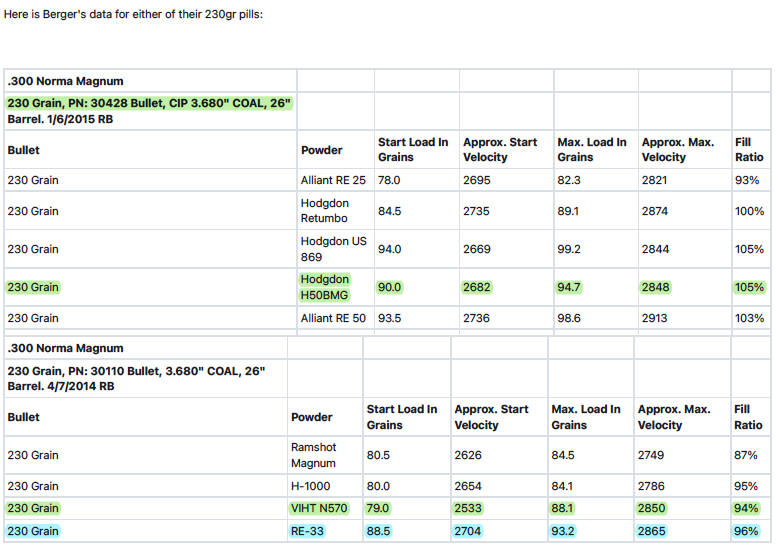

From Berger, use at your own risk!

The Berger data is known to blow primers even at the starting load

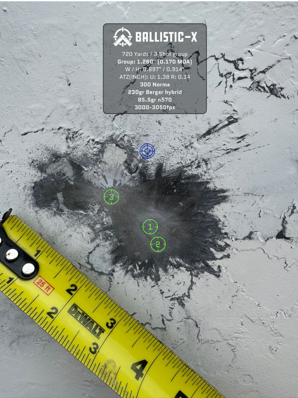

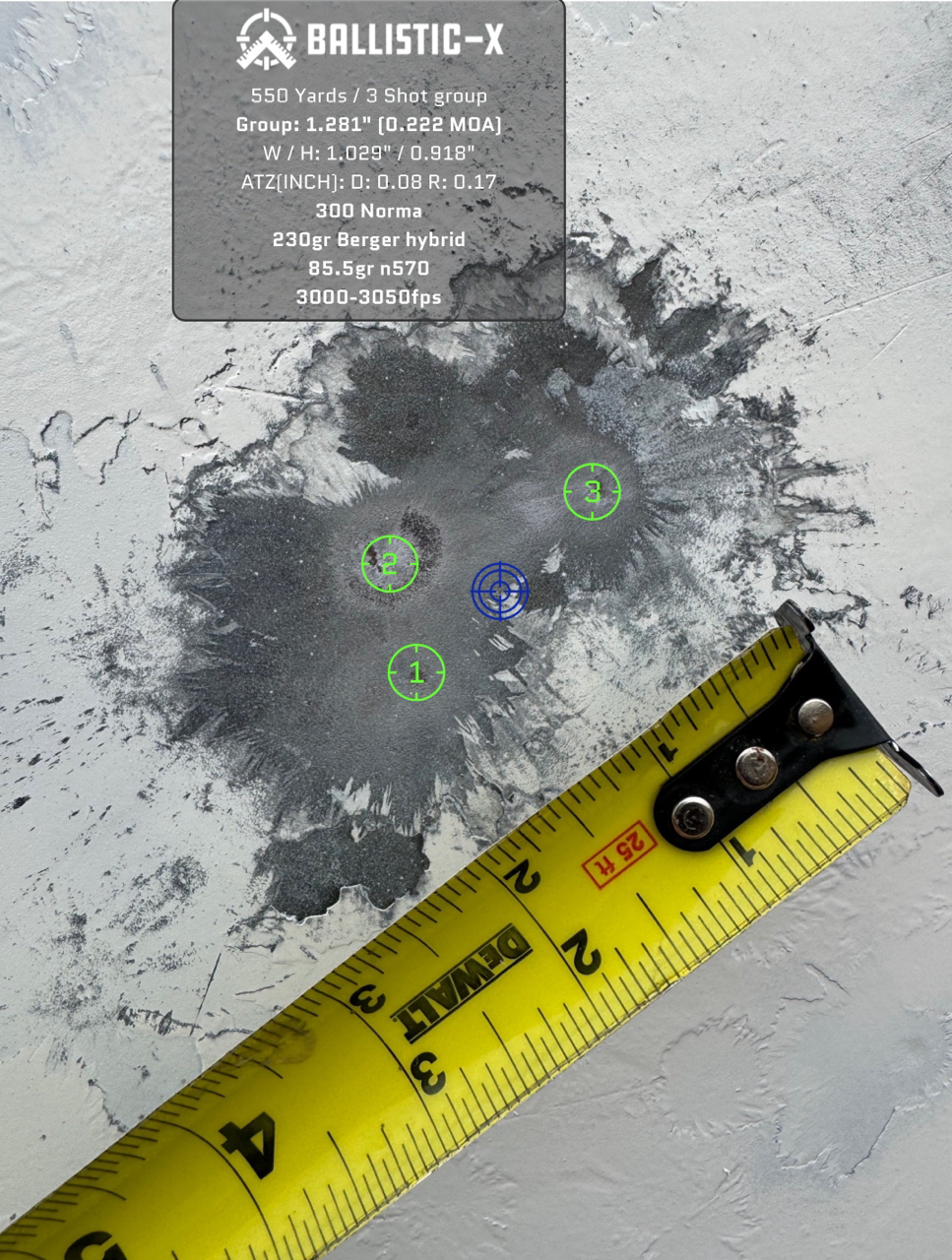

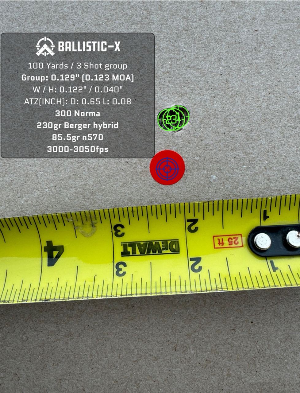

We both got higher velocities with N570, I think my friend was getting around 3050 through a 32" Bartein with no pressure signs, but the temp sensitivity was a deal killer for both of us.
