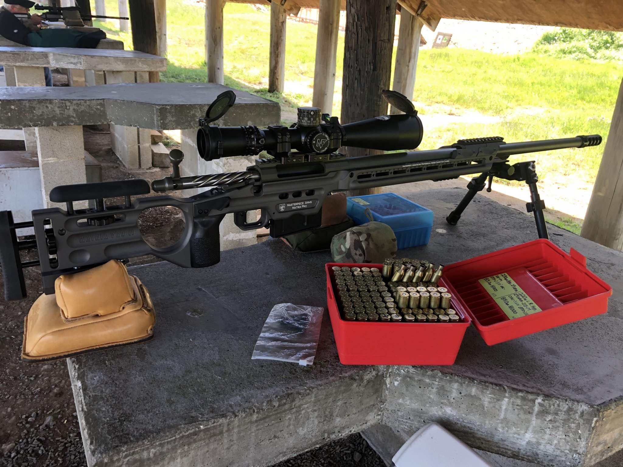

One quick test at 385 today on the load from two posts above. Only four shots. Looks like it is holding up though right at a half minute or so for all the grouos so far. I dialed 1.3 and still hit a touch high (measured scope height is 2.9"). Perhaps this is doing a touch better than the 300WM - velocities I was suspecting with only 82gr H1000.
Either way, I'll shoot it at 655 in the next week or two to finalize as well as true velocity. If it stays the same, I'll load the rest of my buddy's components up for him and call it good.

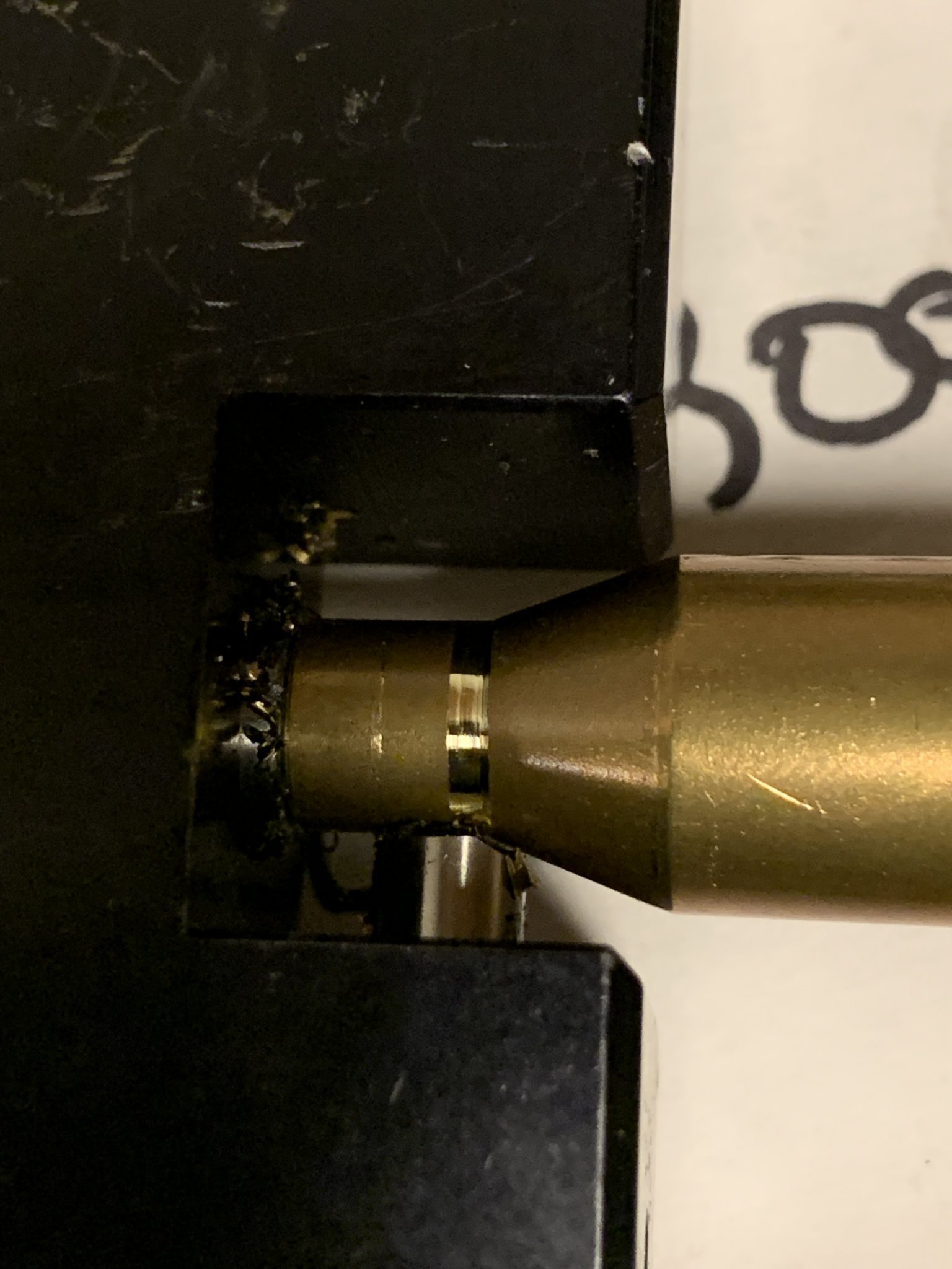

If you are having trouble ejecting that brass it is likely due to a bad spot in the chamber. From what I see in the picture it is likely just from the die.
Clean the inside of the die to be sure you haven't gotten a little dirt or carbon build up in there and see how brass looks then.
Overall, unless it is causing a problem with ejection, I would not worry about it. Some of what you see is very normal.

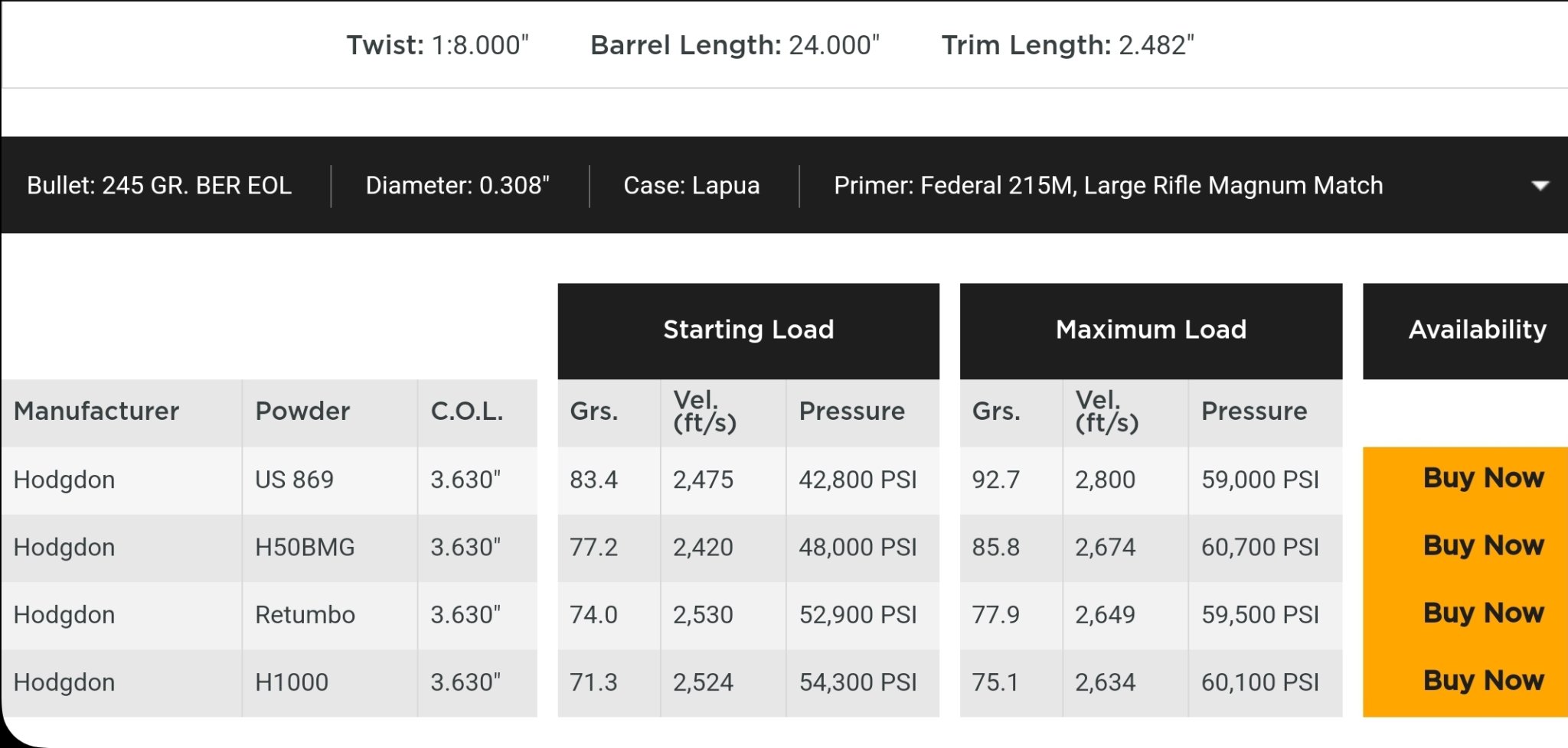

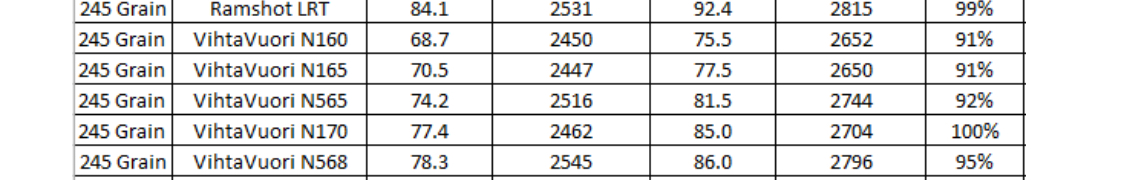

Since I couldn't find much info on 245's and H1000 I figured I'd post up some results to help others who may be interested in that combo. This was from a remington varmint contour 8 twist 28" long on a lightweight hunting rifle.View attachment 8364386
Much appreciated posting these results, I just dumped money into the EOLs prior to reading about H1000 vs. N570 for heavy pills. I have H1000 on hand, have the same barrel specs except its a heavy rifle.
Curious what your seating depth/die combo is?

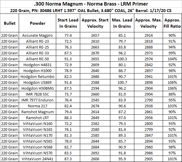

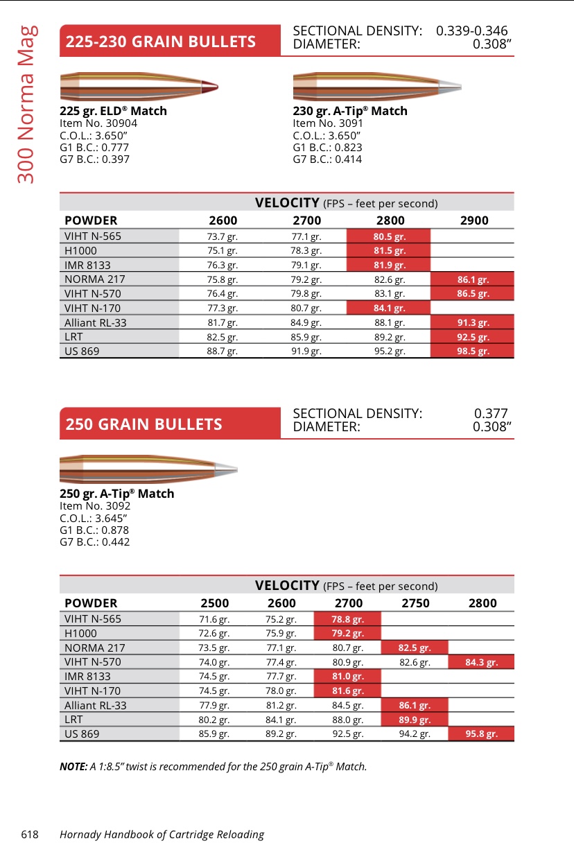

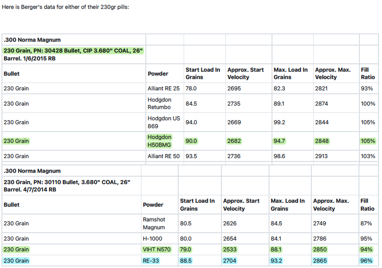

What’s everyone’s thoughts on n568 with 245’s 30” 1:9? Anyone have data?
Tried h1000. Getting pressure down to 79g
You're better off with 568. Ive been wanting to try 568 but I'm easily pushing 245s W/N570 @2930 tru a 26" with exceptional precision. My ladder took me to just past 3K but the node was at 2930.
Also consider N170
Reactions: Balor
That
That's 4 grains over Hogdgon H1000/2217 load data, you should really be using Retumbo/2225 or H50BMG/2218 if you want to use ADI manufactured powder. Only the 50BMG data goes that high on the Hodgdon site, 2 steps slower. Where did you get your data, that's way out?
