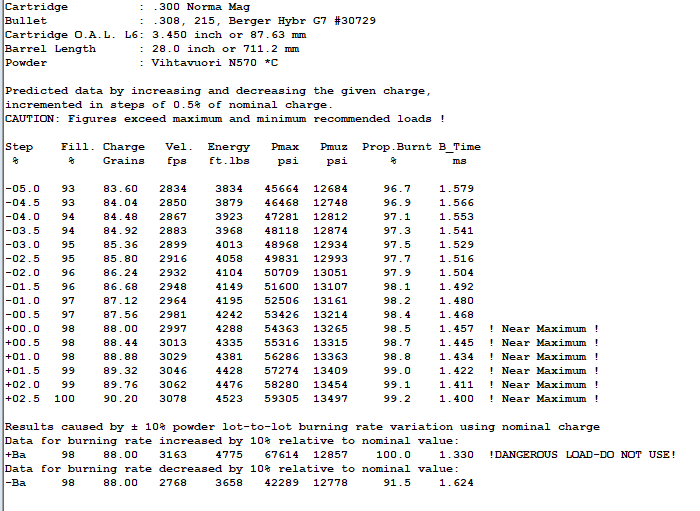

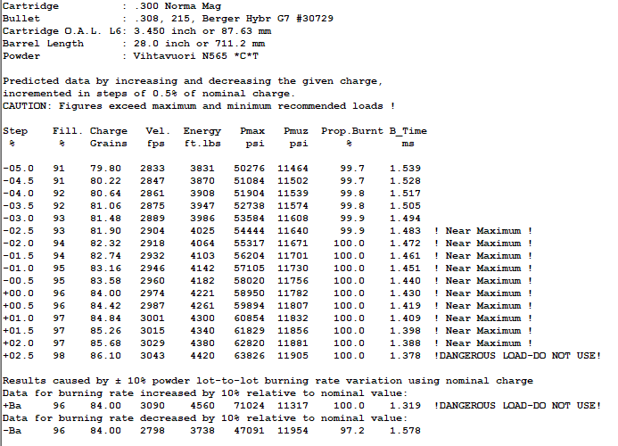

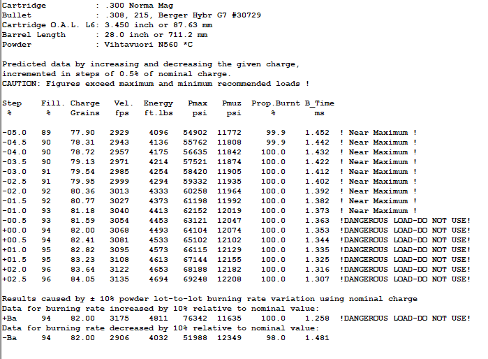

I believe N565 was the direct result of what VV liked about N560 and N570 and tried to combine those attributes into a more stable powder for military applications. I have seen less speed and more consistency with it then N570,
Yeah I love n565 it's very consistent and stable. Just not as much speed as n570 but I've grown to accept it. N568 should be worth 50 to 75 feet more
I have a 300 PRC coming and have N565, N568, N570 and H1000 on hand to try with 245 Bergers. My guess is N565 or H1000 will be what I end up.
It's a shorter barrel so it may need a faster powder than Retumbo. And If I can get 2700-2750 out of it, I'll be happy. If what I have on hand doesn't give me what I want, that will be the next option.

N570 is the optimum powder for performance in the 300 NM but know the price to be paid. I would recommend cleaning at shorter intervals than you may be used to, it definitely seems to help with consistency.
Ballistic-X-Export-2024-09-22 16:55:12.773805.png
Ballistic-X-Export-2024-09-22 16:55:55.131932.png
Ballistic-X-Export-2024-09-22 17:07:49.595608.png

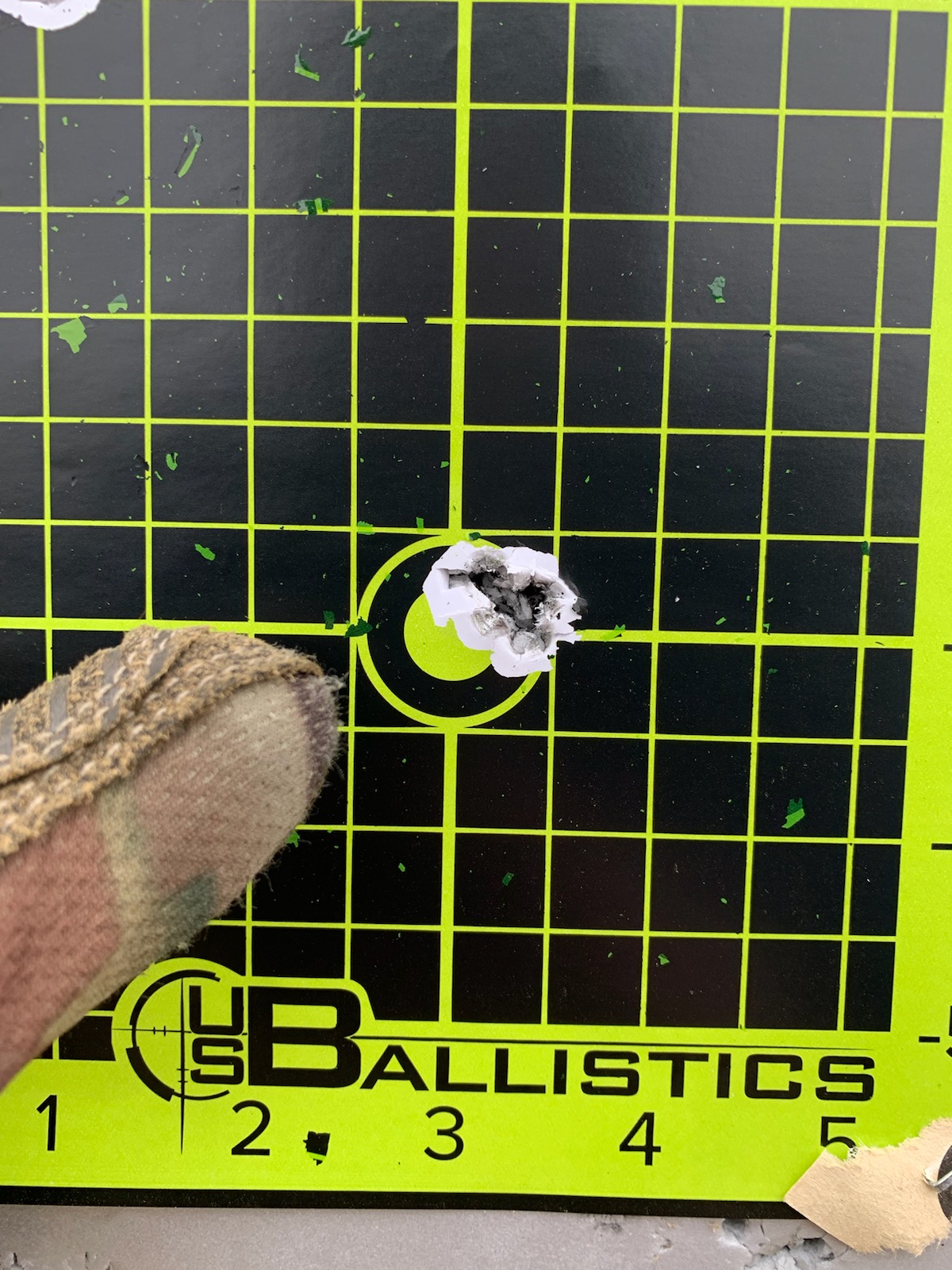

Just finished development of my new 300 Norma Magnum load. Average 2760 fps, ES 15, SD 5 over 30 shots. Confirmed in weather 30-45 degrees at 4k elevation. Barrel is a 8 twist 27in Bartlein on an AXSR with TBAC SR brake.
245 Berger LRHT
77.6 Hodgdon H1000
Federal 210 primers
Lapua brass
Jump is .02
Pic shows 10 shots at 100 yards.

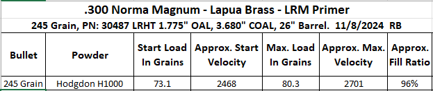

Been shooting 245g LRHT and they are awesome. Shooting a few fps over max velocity but 5 grains under max charge at 75.04g h1000 according to data Berger emailed to me:

Well, the ES and SD are hard to argue with, but I have the same rifle/barrel (but with an Ultra 338 Gen 1 on the end). I haven't shot the 245s yet, but the factory Berger 230 load was right at 3000fps to begin with. Later lots have been around 2940 avg. All to say, 2760 seems awful slow, but I haven't hand loaded for it yet. My loads in the 27" AXSR 300PRC are 78.1gr Retumbo running 2895 with a 230 Berger, and the 338NM (same case as the 300NM) with 88.1gr Retumbo running a 300gr Berger at 2742. Accuracy is similar to yours with all of the above. Also, it is true that Retumbo gives better velocities with the heavier bullets than H1000, so there's that too. And, you are doing better on MV than their data for the 245 shows, even at that load. I will be developing a 245 Berger/Retumbo load for the 300NM soon, but based on how it shot the factory loaded 230s near 3000, I'm hoping for something around 2900 for the 245s.
Reactions: Balor
I agree it sounds slow and a different powder would be better. I used what I had and got a deal on the 245s. I tend to err on the side of brass life as our hobby is increasingly expensive. My tests found slightly heavier bolt lift around 77 and that’s my sign to chill out.
Reactions: taliv
All great decisions, and with that ES and SD you are way ahead of the game vs a higher MV at their expense. I was just surprised you got into pressure at that MV. I may be seeing the same thing when I get there shortly. I was just extrapolating from what I got out of the 230s.
