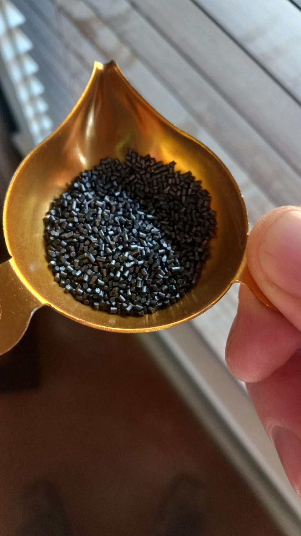

I'm no longer interested in trying to develop something new, but rather sleuth the factory load. I've got all the measurements...but it is using 86.3 - 86.4gr of a powder that I am unfamiliar with. I'll attach a crappy photo of it.
Anybody have an idea of what powder it may be? Obviously the charge weight narrows it down, but i dont have any magnum powders on hand other than H1000, and it definitely isn't that.
I've left the deconstructed round apart so that I can dump the powder out and compare.
Maybe N570??
Any insight is greatly appreciated.
Diggler, it's Norma ammo, therefore as mentioned above, would look at a Norma powder. Identifying powder visually is probably not the best way to approach this. That being said, the Vihtavouri powders for 300 NM (N170, N565, N568) I'm familiar with are not as uniform as your picture. Diameter fairly consistent, length and clean cut ends not so much.
And why would I even know this? Because I have an Ingenuity Trickler and conversed with Paul in trying to find the correct disk for N170. In our conversation(s), he indicated Vihtavouri powders, at least in that series are not all that consistent. I defer to his knowledge and my observations.
Reactions: diggler1833
I appreciate the help gents.

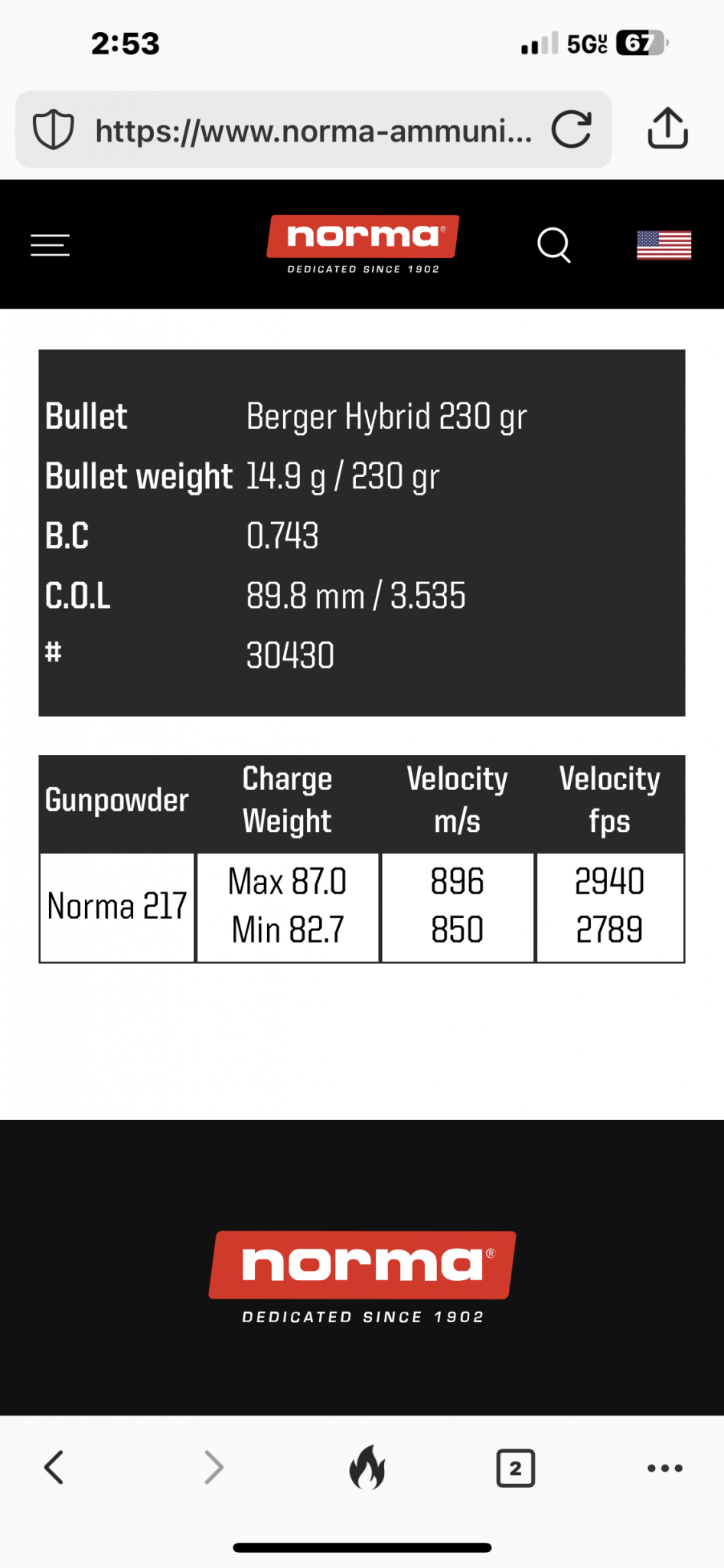

As far as I know, Norma powder is no more. I already tried to find some 217 as it made the most sense. Powder Valley, Midsouth, and Midway no longer list Norma powders, and there are threads dating back a couple years on other boards stating that Norma is gone.
So either Norma is using a proprietary blend not commercially available (absolutely possible as their advertised velocity is pretty hot), or they have been using something from another company.

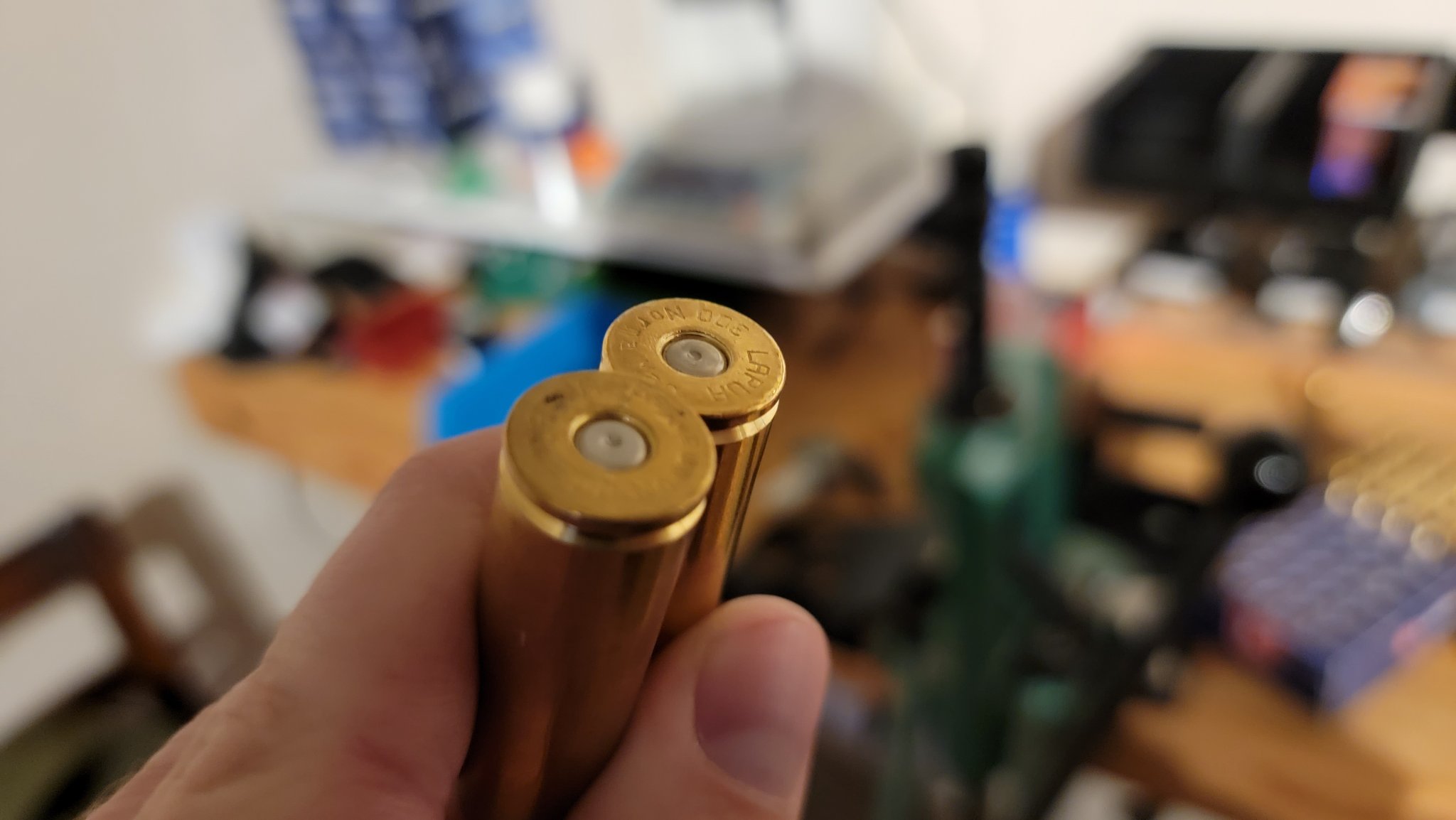

Was hoping to get some help diagnosing my Norma build.
I've got 18 rounds down the pipe and 2 light primer strikes.
The firing pin channel did have a tiny bit of crap in it so I cleaned that out.
Headspace:
Zeroed on go-gauge
Fired brass +.003"
Virgin brass -.0065"
Primers are seated -.008" (on primers that didn't ignite) CCi 250's
This was all measured with calipers so take it for what it is. Is this where my issues are? Or are these numbers inline with what you guys are seeing?
Reactions: Balor
What kind of trigger do you have? Way back in the day, I would get light primer strike with a Timney trigger. Turns out the sear engagement was off on the trigger causing this issue.
