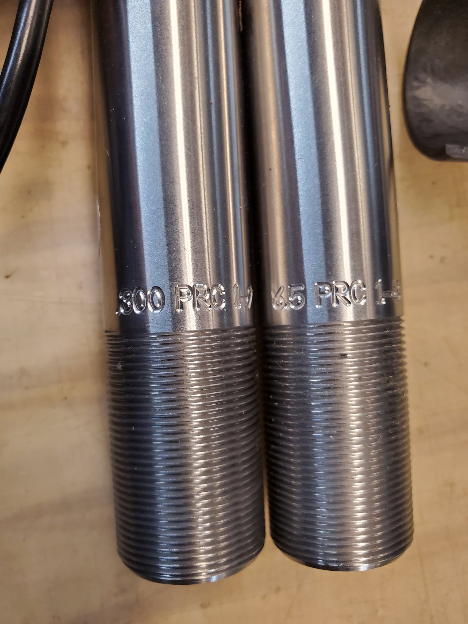

I’m in the process of convincing myself that I need a 300PRC barrel for my Desert Tech. Wanting to go with a 22.5” barrel to keep things compact and save a little weight. Thinking I should be able push a 210 VLD about 2850 to 2900 fps using RL26. Does that sound about right. Also thinking I could go with a heavier bullet if I want which should be fine for hunting. I have other barrels for the DT and other rifles to fill other needs so I’m not looking for the 300 PRC to cover all the bases. Any comments or suggestions would be welcomed.
My question to you....are you sure they sped up? What I'm trying to ask is....did the barrel speed up....or with the changing seasons.....is it warmer outside now than when you first started shooting it? I've shot in conditions recently at 15F and 70F....and the speed difference is measurable.
Im in South Texas. Biggest temp swing I’ve shot in all winter was only 30 degrees high and low so far this winter. Also using H1000 for the PRC so I wouldn’t expect it to be that temp sensitive. Maybe 10 fps over 30 degrees at worst. Most of the days I’ve shot have been in the 60 or 70’s. Gotta love Texas. ?
I should have my 22" 300prc hunting rifle done in a few weeks. 22 seems to be the compromise length between weight / length / being handy / speed. RL26 gets these pills moving quiet a bit faster then H1k without the pressure. I am going for 2850-2900 with the 215 berger. With the speeds I'm seeing in my 26 and 27 inch tubes I have very little doubt that it will get there. I will run the TB Ultra 7 or maybe the 5 on there also. So muzzle blast is something I'm not worried about.
I'll update the thread in a few weeks after I get some rounds through it and record the velocities. The 22" 6.5 PRC that I have shoots the 156 bergers at 2900 without issue, so I hope to get the same 2900 in the 300prc with the 215s. It will hammer elk if that's the case.
@Jmcmath is also building a shorty hunter. Think he doing 21" but he can correct me if I'm wrong.
I’m also building a 300 PRC hunting rifle. Almost an identical Remington sendero clone, with the exception its a bartlein 9 twist 5R fluted 28” barrel chambered with a custom shorter throat 300 PRC reamer by Dave Tooley ;)

Thanks all for the replies. That would be awesome, i also run a Ultra 7. I happen to have a 22.5" 6.5 creed barrel, so now i think i might try a heavier bullet and RL 26, typically shoot 140 VLD's with H4350 or RL16.
Anyway i look forward to everyones results with the short barrels.
