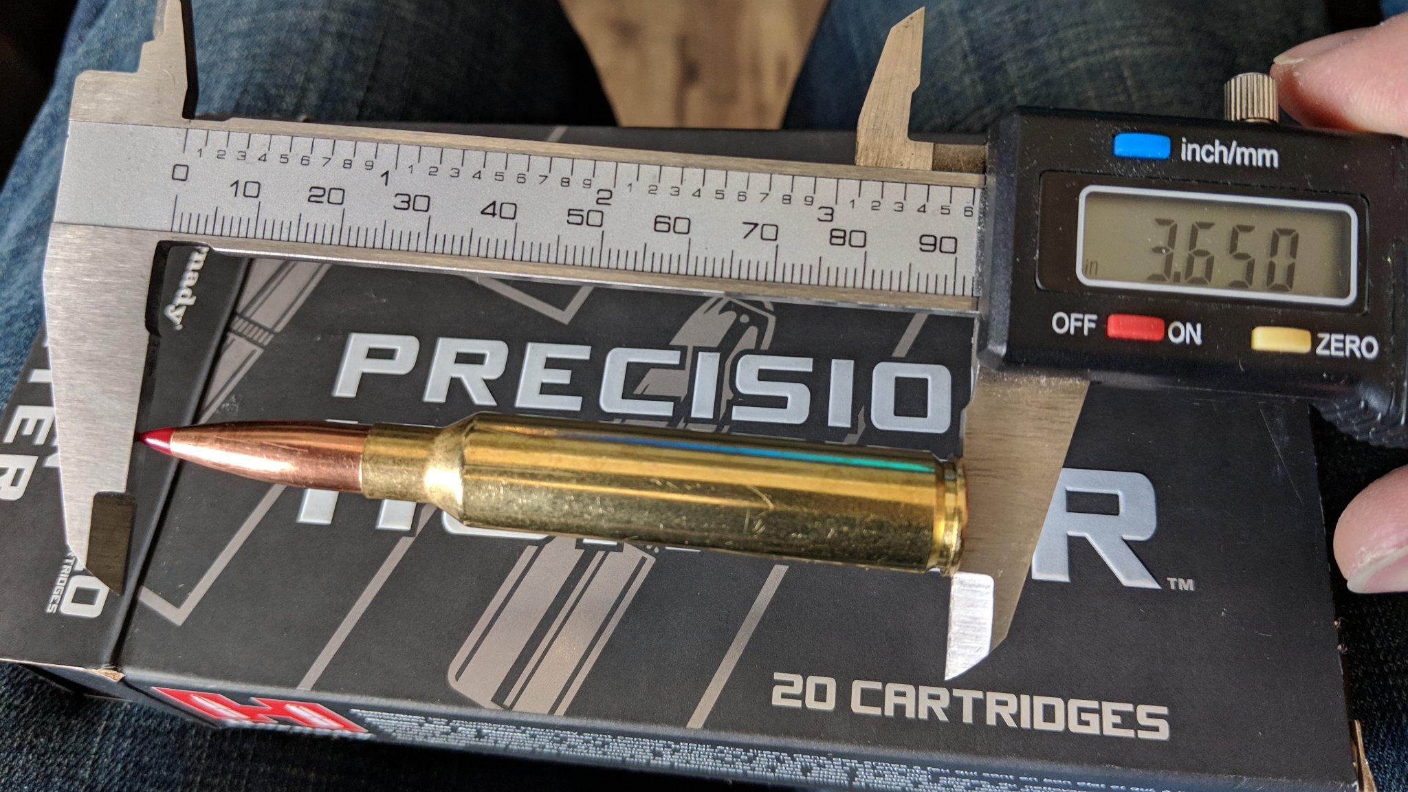

Anyone know what the COAL on the hornady 212 eld-x factory loads are? I am starting a build on a tikka action with an mdt chassis and the only aics mags they accept (according to MDT's site) have a max coal of 3.56 which eliminates the 225 loads :mad::mad:

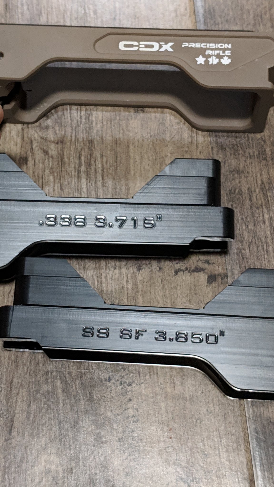

Looks like your outta luck with the 212s also. Need at least the 3.775 mags that take a COAL of 3.675 to run the factory ELD-X. I went to the 3.850 mags so I can make both Hornady offerings work.

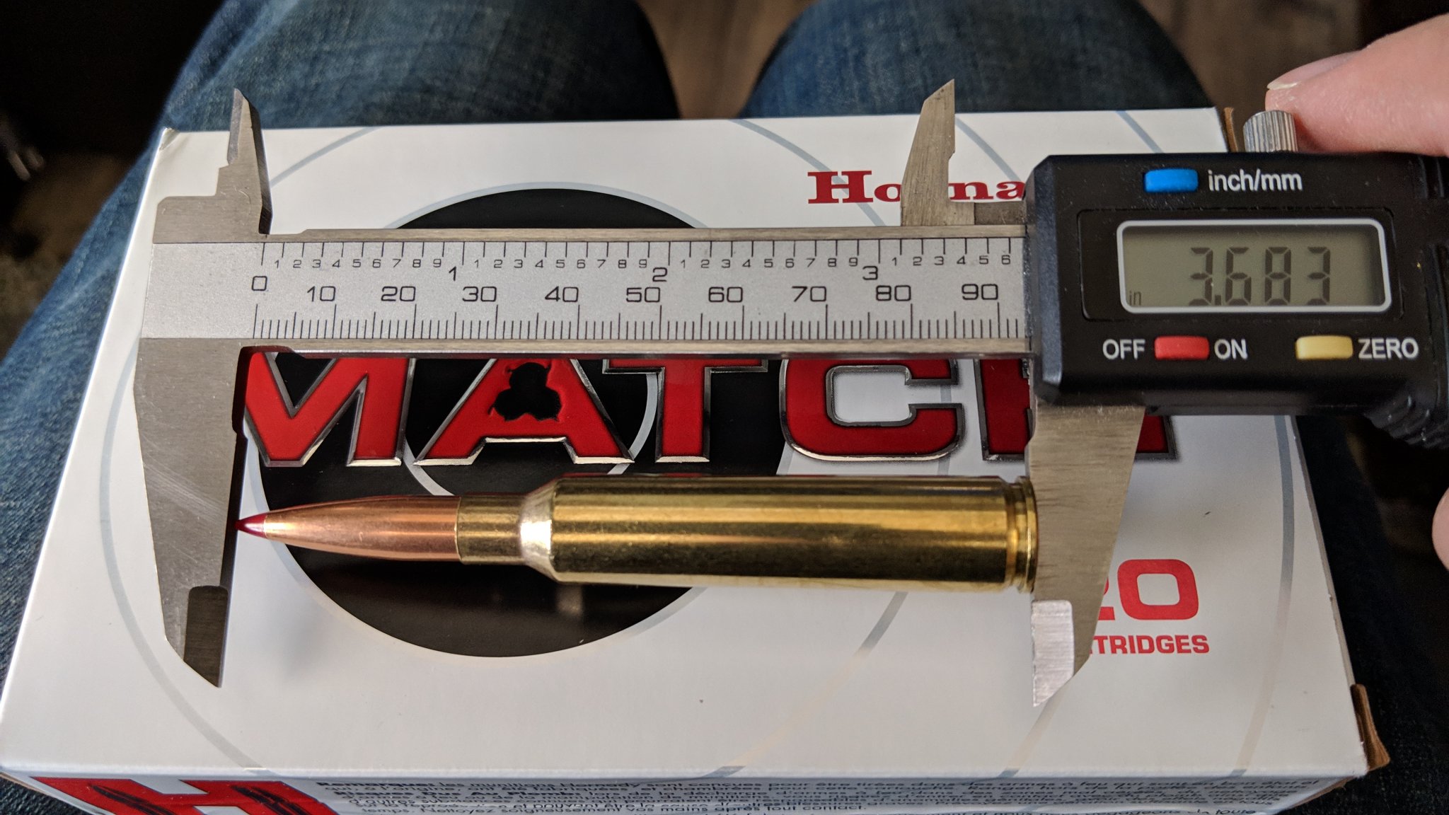

3.650" on the 212 ELD-X.
3.683" on the 225 ELD-M

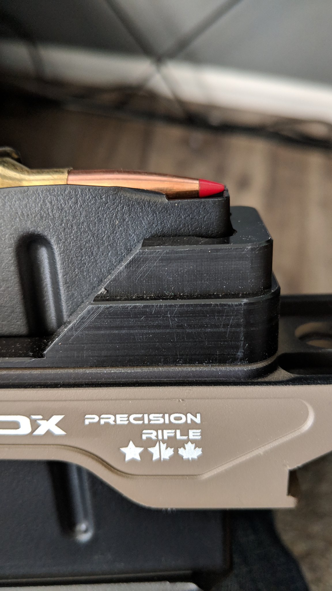

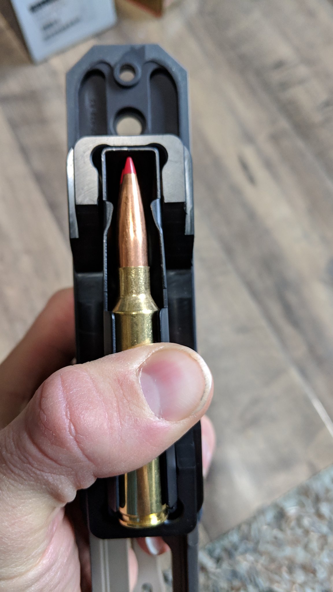

Here is a pic of it in a 3.715 accurate mag with a COAL Max of 3.615. As you can see, the 3.650 eldx round does not clear.
Thanks for the info. Bummer news considering I don't know of any tikka chassis/stock options that are compatable with CIP mags. And I don't really want to put together short handloads for it.

Looks like Accurate Mag makes a 300 Win magazine at 3.850 with an internal of 3.750 which I was not aware of. Fixes the mag issue as long as the action accepts it.
Funny, I was reading about this mag length stuff today and it made me just now lookup the 300WM magazine that I had ordered when I planned to build a 300WM. Looks like I stumbled in to ordering the right one:
"Accurate-Mag AICS Pattern Single Stack Magazine, 300 Win Mag 5 Round, 3.850" Length"
$80 at midwestgunworks.com
(I have it in a KRG Bravo stock/chassis and mag works great)
Looks like I'm all set once I can get the barrel, headspace gauges, and some ammo or brass.
Correct. This is what we have been saying but maybe not came across easily to understand. The CIP 300 win mags are the 3.850 mags. So you need the CIP bottom metal. Accurate makes these mags. So does a few others. MDT, Savage, AI, etc.

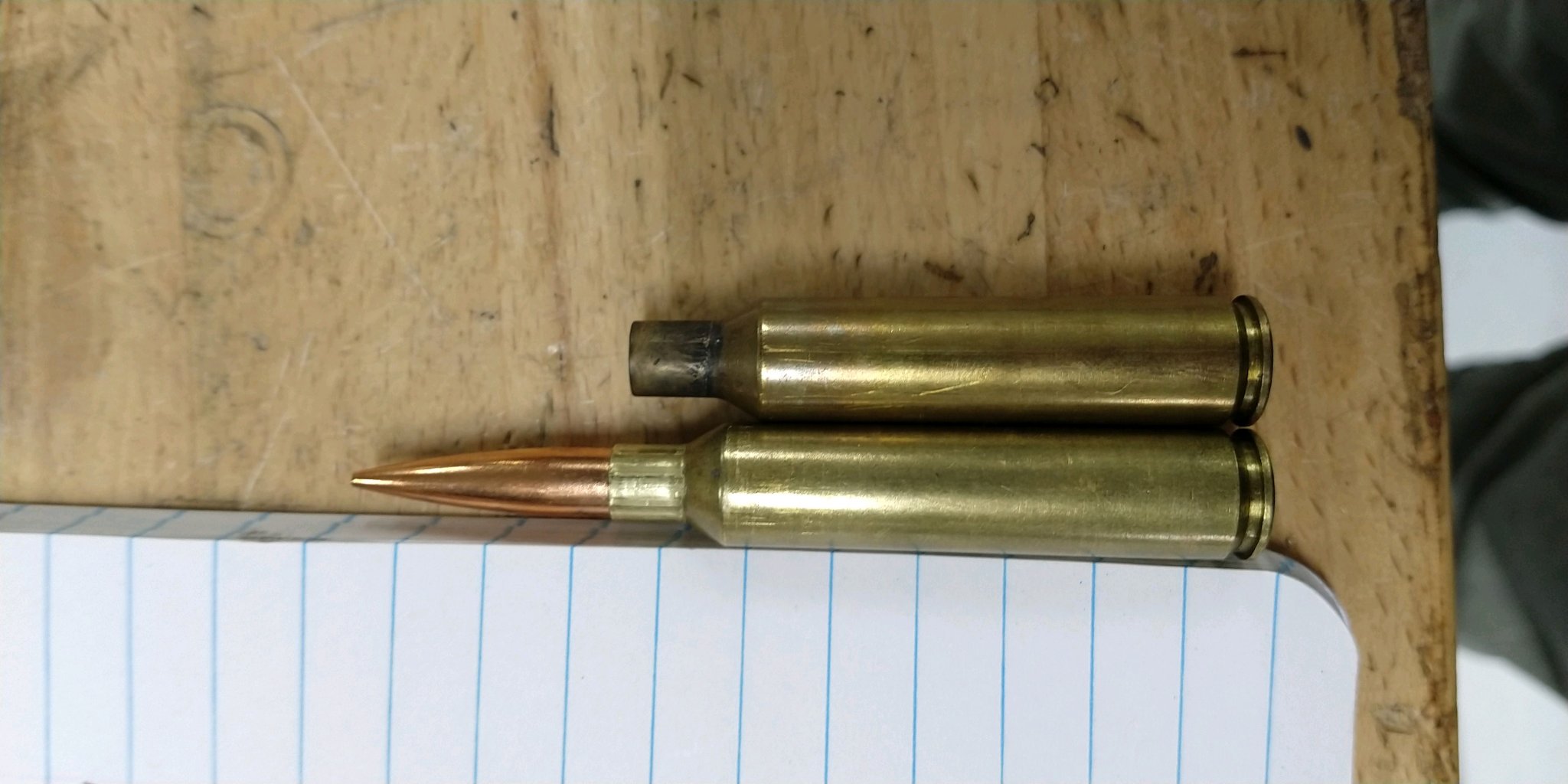

Seems to be another issue with the factory ammo overall length. Some of the rounds but not all are jamming into the lands when chambered. Just spoke to a smith that has been doing quite a bit with this cartridge since its launch and they have been keeping me up to date. Reamer and chamber were both to spec and felt it was very difficult to close the bolt on several rds. Extracted one of the rounds and was left with gun powder all over the place and bullet stuck in the chamber.
Hornady really needs to shorten the coal by .010 on these rounds.

I guess it will depend on the reamer he is using. The saami spec reamer that I was given information on was used on a build and the factory 225 eld load was jamming into the lands and pulled the bullet out of the case. Not sure if this was just an isolated case or if the coal on this load is going to cause this to happen frequently.
Definitely will not be good for off the shelf rifles if that's the case.

This was not my rifle, I was just talking with the smith that has been testing it since the factory ammo was released so I cannot provide any dimensions. It was a brief conversation about the longer magazines that turned into the "oh and by the way we ran into another little snag while testing the factory 225 eld".
All I can tell you is that the saami spec reamer was used and 3.685" factory ammo is jammed into the lands. I was told that a loaded length of 3.675" would probably not have this problem.
