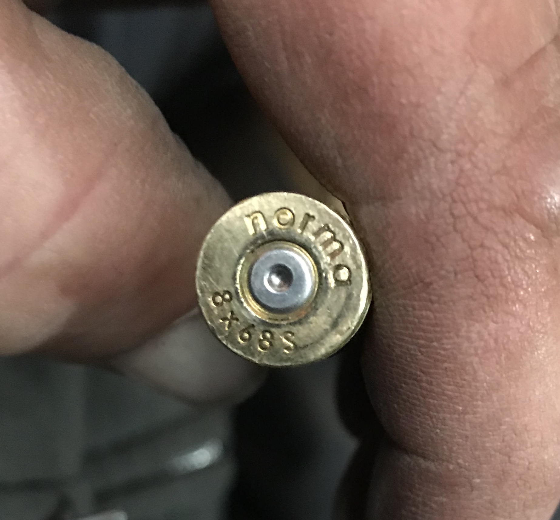

I’m shooting a 338/375 ruger. I use 8x68s Norma or RWS brass and fire form it to my chamber. The head is a bit smaller so some actions may not be able to extract but with a sako/ m16 style extractor it works great! I hate the cow fire forming so I shoot cheap bullets to fire form. I neck up to 375 then down to 338 forming a false shoulder with a slight crush fit. It is much stronger than Hornady’s primer pockets. For the 300 prc you could prob just trim to 2.600 the neck down to 308. Left to right: Hornady 338/375, Norma 8x68 fireformed, 8x68 ready to fire form

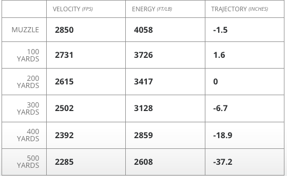

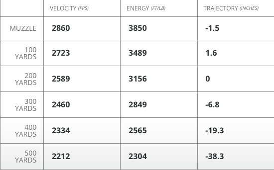

This guy has actually shot it:
https://gununiversity.com/300-prc-ballistics-and-comparisons/
'Enter the 300 PRC. As you can see from the chart below, it has better energy on target and drops less than the 338 Lapua Mag past 1,000 yards and it recoils a LOT less.'
'Also note that although the 300 Norma out performs the 300 PRC, it’s not by much. I’ll take the 300 PRC any day over the 300 Norma. Not how the 300 PRC (red line) is in-between the 338 Lapua (green line) and the 300 Norma (blue line) in performance (and is slightly closer to the 300 Norma).
It does all this in a smaller and lighter recoiling package.'
