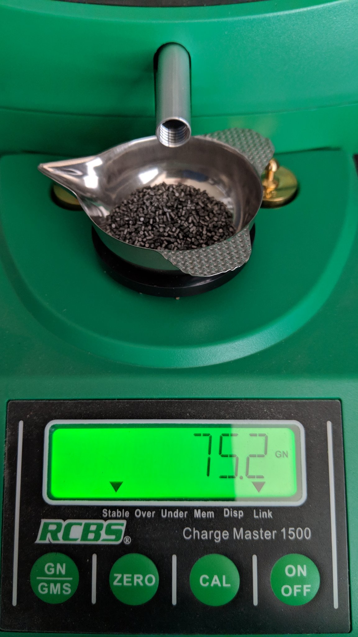

For anyone interested, I Just pulled a bullet out of a 225 factory round and measured the powder. 75.2 gr. Maybe h1k. I don't know.
