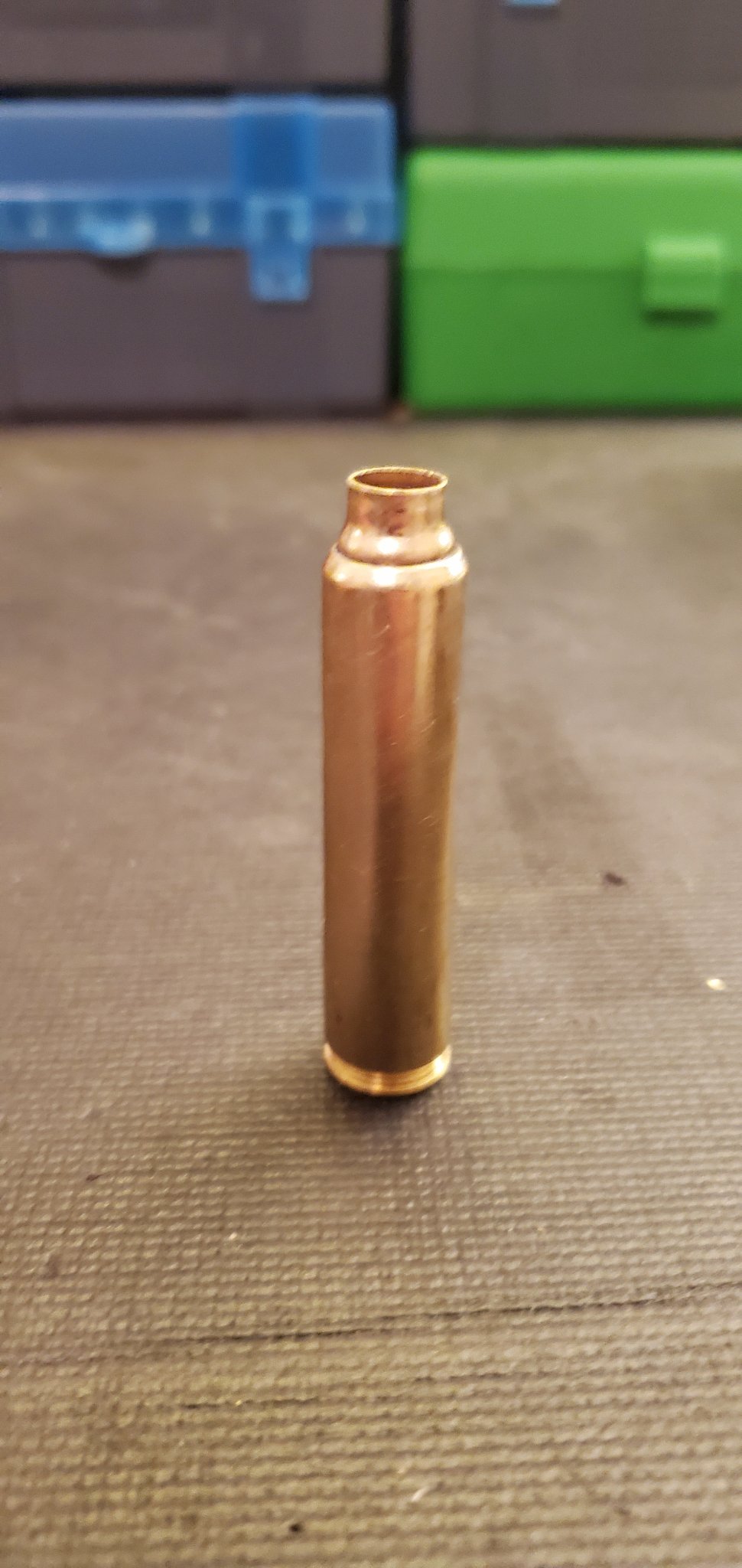

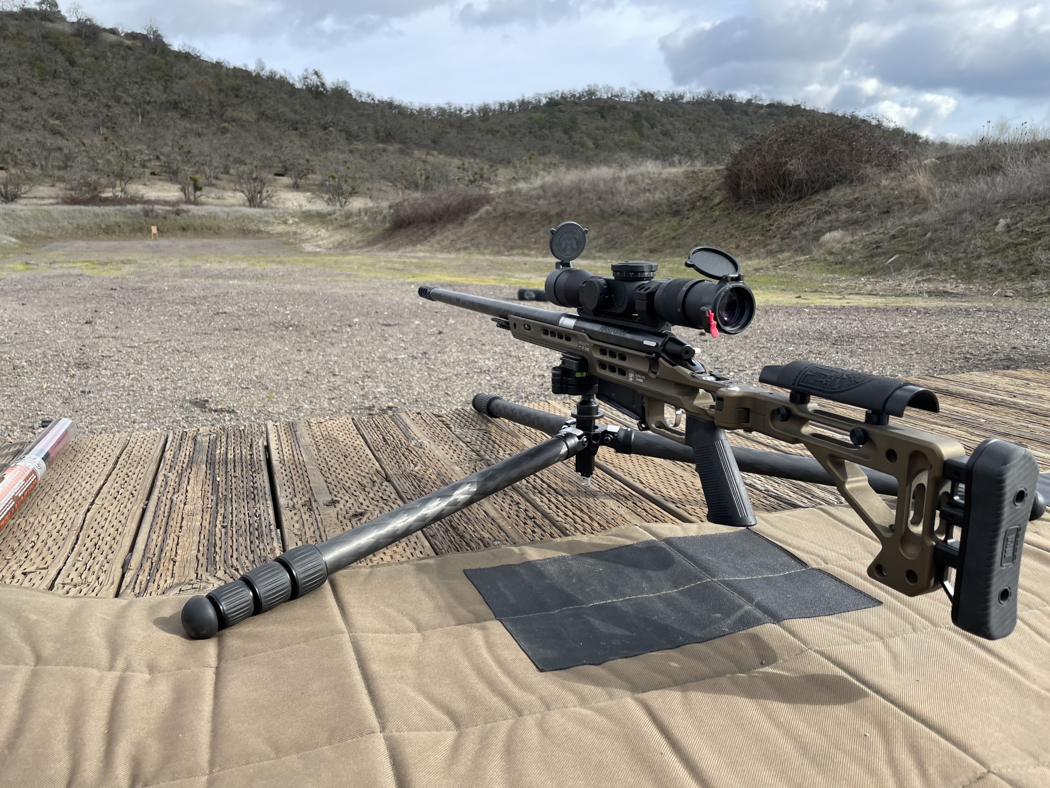

Got my new build out to the range for the first time today. Between zeroing the scope, breaking in the barrel, running a max charge test, and figuring out the new tripod setup I had my work cut out for me. Initial impressions are that this rifle will be a shooter. All ten rounds of the charge test were sub-moa and most of them key holed.
Here’s a question for you all though... as far as rifle goes I’ve only ever loaded for 308 before this one. Between a piece of virgin Hornady brass and a piece of brass near my max charge there was absolutely zero increase of headspace. There was also no change when measuring the diameter at the web between cases. The diameter just at the shoulder/body junction did increase by .003” but other than the case mouth that was the only observable change in brass dimension.
How should I resize the brass? I don’t want to bump the shoulder if it is already a perfect fit. Should I just run in up the die as far as I can without moving the shoulder at all?

What bullet and charge?
A .002 shoulder bump in a FL sizing doesn't hurt that "perfect fit" ... it's cheap insurance against a wasted range visit with a box full or reloads that won't seat in the chamber. That's my experience, anyway.

220 ELD-X with 76.2 gr of R-25 (can’t get my hands on any 26)
This was the listed max charge. I’m still trying to figure out how this gun/brass/primer combo is going to show pressure. No charges resulted in a sticky bolt. I’m using #34 primers since again, that’s the only magnum primers I can get but they have a harder cup, which probably isn’t going to flatten or crater easily. The action is a bighorn origin and the ejector groove is different than the standard round cut out. I started seeing the faintest signs of it around 74.9 grains which is way before I should be maxing out. Even at 76.2 grains I was only getting 2809 MV on my 24” barrel. Hornady data was off a 24” barrel too and they list 2850 for that charge. There was more neck tension than I would have liked but my expander doesn’t push it out enough to get it where I like it so firing will be the only way. Bullets were seated at the lands for the initial charged test.
I’ve always understood (mostly based on rants by Erik cortina and respected BR shooters some of you probably know), that diametric fit of the brass doesn’t matter at all as long as the shoulder and head are in just slight contact with the chamber/bolt face. If I bump it back .002 from where it’s at is there really any advantage to reloading anymore? Hell in this case, even the virgin Hornady brass would be a better fit for my chamber. I’ve always sought to have my brass set to cause just the slightest sign of resistance when dropping the bolt handle (firing pin/spring assembly removed). Not sure what I’m going to do in this case though with the brass not wanting to grow at all. I guess I should probably get back to the reloading branch and see how the fired brass chambers up again.
How much resizing is always going to be a balance between the desire for the most consistent alignment round-to-round of cartridge to chamber and the desire to ensure reliable chambering and extraction.
Additionally, it depends on how you are using the system and where. I.E. Will everything always be perfectly clean and how detrimental would failure to chamber or extract be for how you are using the system.
After considering those areas, and testing your approach proceed according to your needs.
A side note, there are certainly other reasons to load than having brass that fits "perfectly" in your chamber. Such as neck tension control/consistency, charge weight control/consistency, bullet seating depth control/consistency to name a few.
