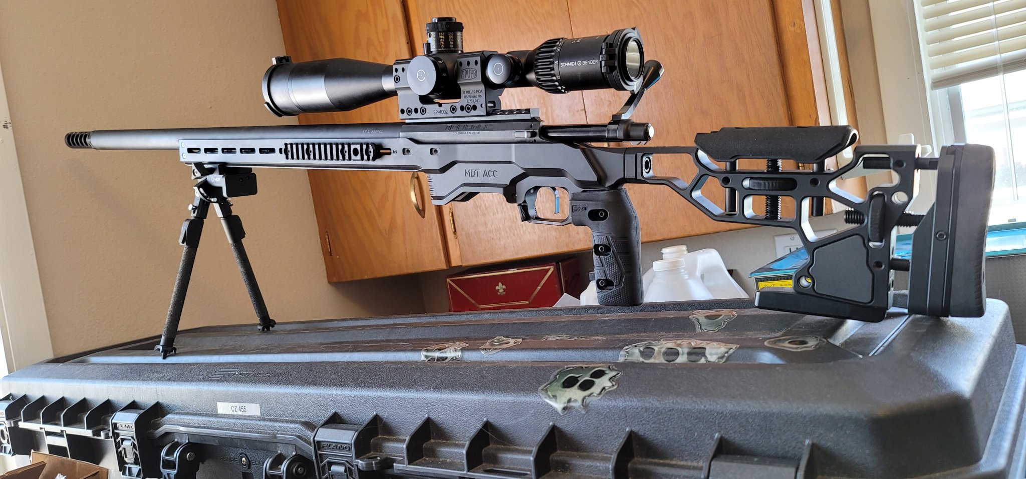

Just got mine built ten minutes ago, need to get a lower Spuhr mount. Time to start reloading and hit the range tomorrow.
Schmidt & Bender 5-45 x56, Tenebraex ARD and polarizer
Spuhr 1.5" mount (stolen from my AXMC, replacing with a 1.181")
Defiance Deviant Tactical with CRF, 30 MOA rail, long tactical bolt handle and nitriding
Bartlein 28" 400MOD 5R 1.25" bull barrel 1 in 9 twist Cerakoted graphite black
FAT BASTARD gen 3 (this will be loud.)
Trigger Tech Dimond two stage, flat trigger, PVD
MDT ACC with full channel weights, buttstock weight and bag rider
Ckye-Pod gen 1
MDT straight grip
Weighs 26.1 pounds, does not look it but I weighed it.

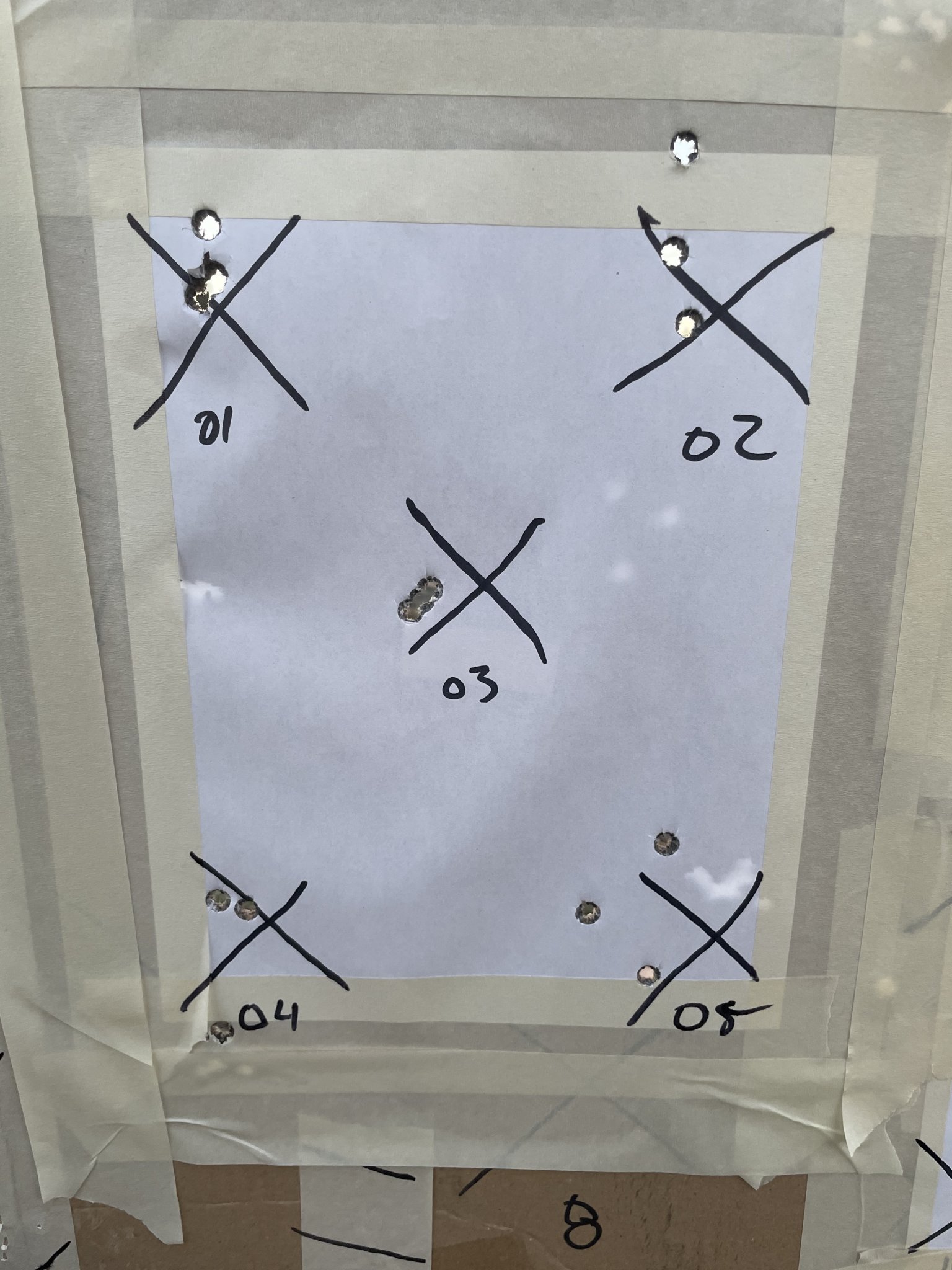

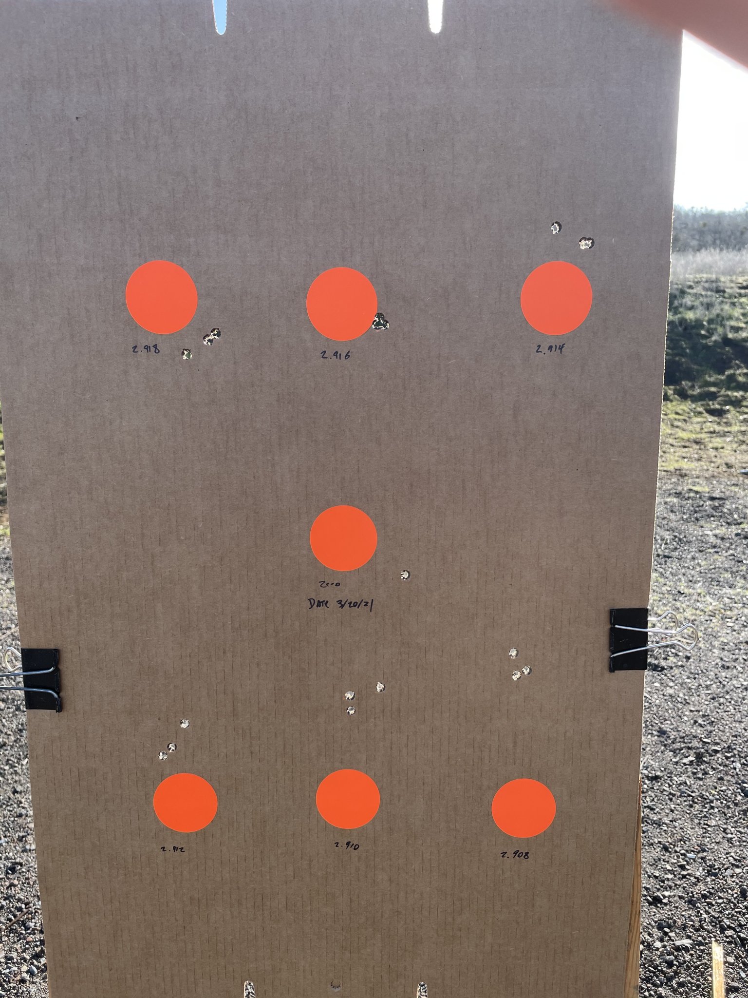

Every time I come back from the range I always seem to have more questions than answers. This was a seating depth test I ran this morning. Clearly the rifle likes a .002” (2.916” CBTO) jump, but what is most confusing to me is the dramatic POI shift. The rest of the groups are pretty crappy, but I’m not understanding how the group could move that much at 100 yards just by seating .010” deeper. By the way, the group labeled 2.916 averaged .005-.006” runout. Again... more questions than answers.
it’s hard to diagnose things like this.
Jump test can show some weird POI shifts.
One thing I learned when shooting magnum cartridges up to cheytac sized cartridges is how important is it to control the rear of the rifle. Just changing my technique with that alone changes my POI and group size
also in my experience magnum and larger cartridges do not like long skinny light contoured barrels. This could be more than one thing going on. Maybe it’s something to do with barrel harmonics. Maybe it’s something to do with recoil management. Maybe it’s both. The Swiss cheese effect
so for me, if both those issues were present and also doing a jump test, I would see some wild groups
im just throwing stuff to see if one of these sticks
Below is a jump test with a 33XC with a light contoured barrel at 160yds. While one group looks decent, I could not get the rifle to shoot with Berger Hybrids or Hornady ATIPS. I have much thicker barrels on order.
Interesting. I’m shooting off a proned out RRS in an anvil and have the rifle pretty well in my shoulder and taking most of the recoil. I’m able to support the rear with part of a fist between the rider and the ground. Feels very solid.
The barrel is a 24” Proof carbon sendero contour, so not super skinny.
78 rounds down the barrel as of today. Maybe something to do with break-in?
Guess I’ll load up some more of the 2.916s and see if I can’t reproduce that and keep consistent POI. It’s just weird to see such a dramatic shift at 100 yards with such a slight seating depth change.
