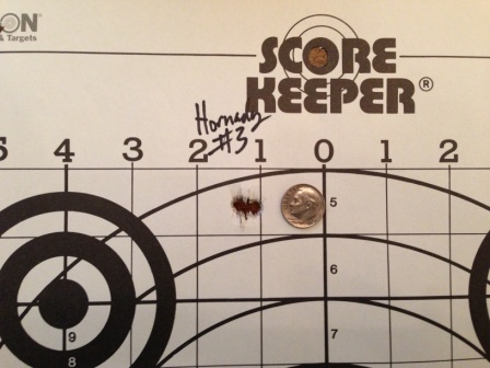

FOR 300 WSM:
- Trued Rem 700 WSM
- 26" Bartlein 5R 1/10 Rem Varmint Barrel
For target, been experimenting with 208 BTHP ... vote not in yet
- Win Brass
- Hornady 208 BTHP
- 0.020" off lands
- 58gr H4350 or 59.9gr H4350
- CCI BR 2
Again, need to chrono. Both of these were ~ 0.50" but I think that 59.9gr is slightly tighter (recoil is pretty stout)
I'm going to try out Hornady 195 BTHPs (Cabela's had them on sale for $25/box) as well as H4831 also.

Sako trg 42 .300 win mag
208 grain a-max
72 grains h4831sc
norma brass
federal gmm large rifle mag primer
col 3.60
Extreme spread for 10 rounds is 9 fps, velocity is 2887. I have never had a 100 yard 5 shot group larger than .50 with this load. It shoots well to 1000 with virtually no vertical stringing.
