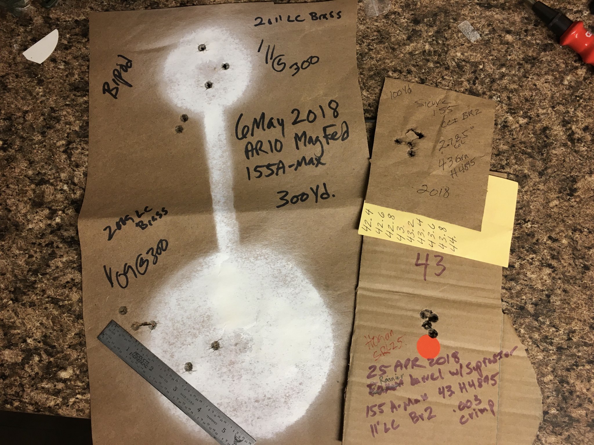

18” Rainier select / POS OSS otb suppressor. I bought all of the 155 A-max when they started phasing them out. Nothing spectacular, but feels like good enough. The ‘09 and ‘11 is batched brass by year.
I lost this rifle on a fishing trip right after these targets were filed.

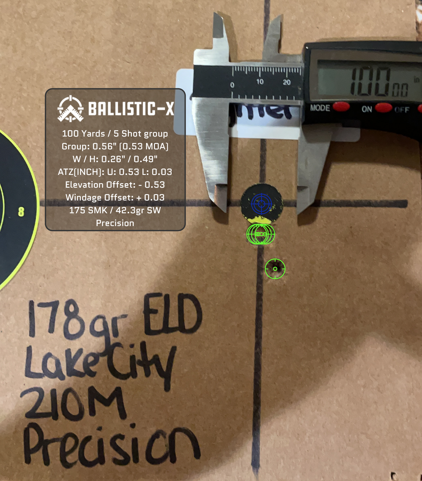

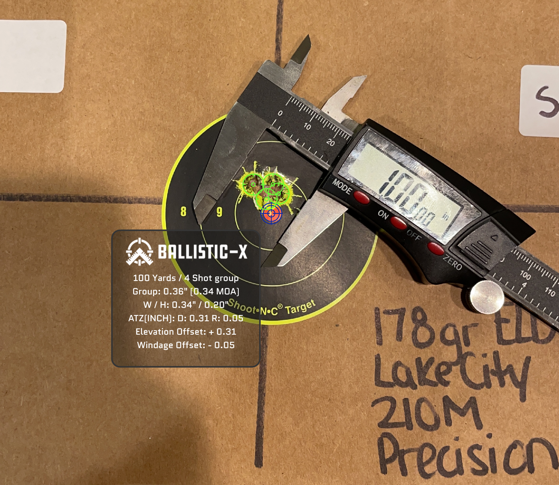

178gr ELD-M
42.3 gr Shooter's World Precision
Lake City Brass
210M
2.805 COAL
5 Shots fired over the Magnetospeed
Average Velocity - 2,520 fps (20-inch barrel)
SD - 7 fps

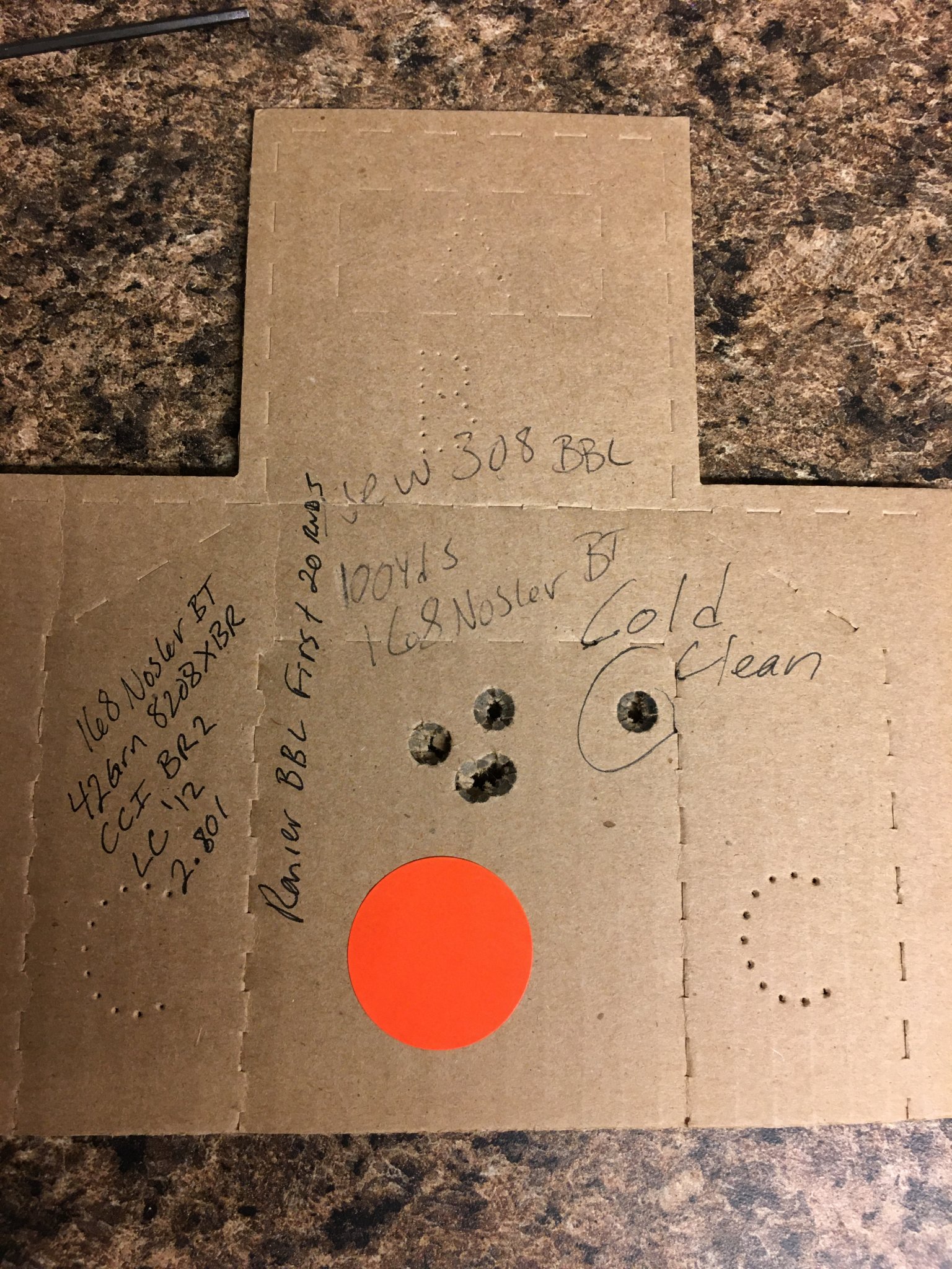

I have a DPMS LR308, with a 24in, 1-10 barrel. Has always shot most everything relatively well. Shot a new load a couple of days ago that did pretty well. 4 of the 5 shots in a .8" x .4" group at 100 yds. Of course, the fifth shot opened the group to just over 1"x .8". My concern with this load is the fact I know it should be relatively hot, but it's not giving me many signs that it is hot. Here are the load details:
LC brass (1x fired)
Hornady 178gr A-Max
43.6grs Varget
FGM210M primers
My chrony died just before firing this load, so no mv numbers, but should be north of 2600 fps from my barrel. I did have primer flattening with this load, but the primers were flattening with 41.8grs of varget under the same bullet and with the same primer. No ejector swipes, no primer cratering, no obvious pressure signs. Without a precision mic that measures to .0001", no way to tell if the cases are over-expanding, but everything seems good at this point. If you use this data, WORK UP SLOWLY.

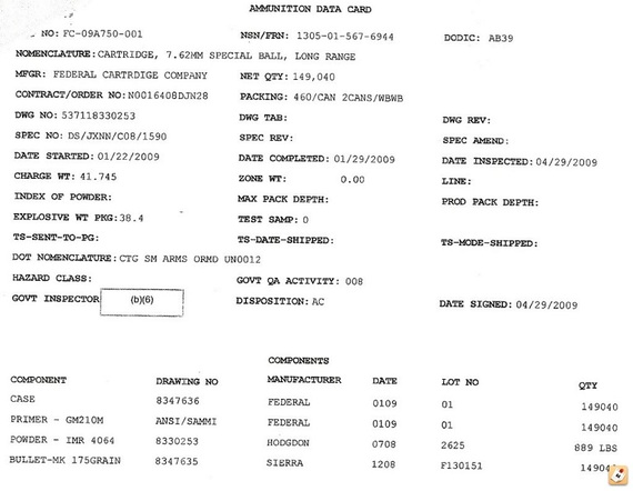

Varget can be hard to find, but IMR4064 is a little easier... I believe this is the powder used in FGMM and the M118LR, I believe 41.78gr... my load with 4064 is 42.5gr behind a 168 or 175 smk. shoots well in my gas guns and bolt guns
nope. It’s proprietary blend. A mix of 3 diff powders. Long stick, medium stick and almost ball mixture.
It's IMR4064. I use 41.5 now with 168 matchkings and they shoot as well as the 42.5 load. I've had my LR.308 for over a dozen years and it is a very accurate rifle. When I got it new the barrel took right at 50rnds before it settled down to where it shoots now. My M1A likes the same load real well.
Take a FGMM 168gr apart and tell me it’s 4064. I promise you. It not. It’s proprietary. However! You’re correct in 4064 around 41.5 with 168 being just as accurate. IF you had their proprietary blend, your accuracy in hand loads would be sharper than FGMM. It’s a standard. However it doesn’t mean every gun will shoot accurately. But it’s by far the best store-bought ammo on the market.
