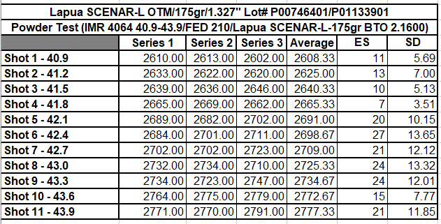

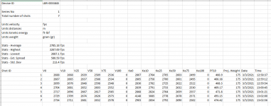

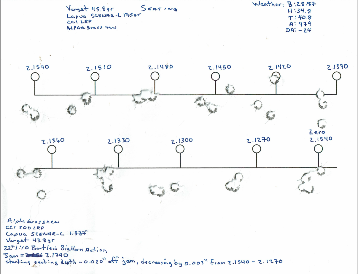

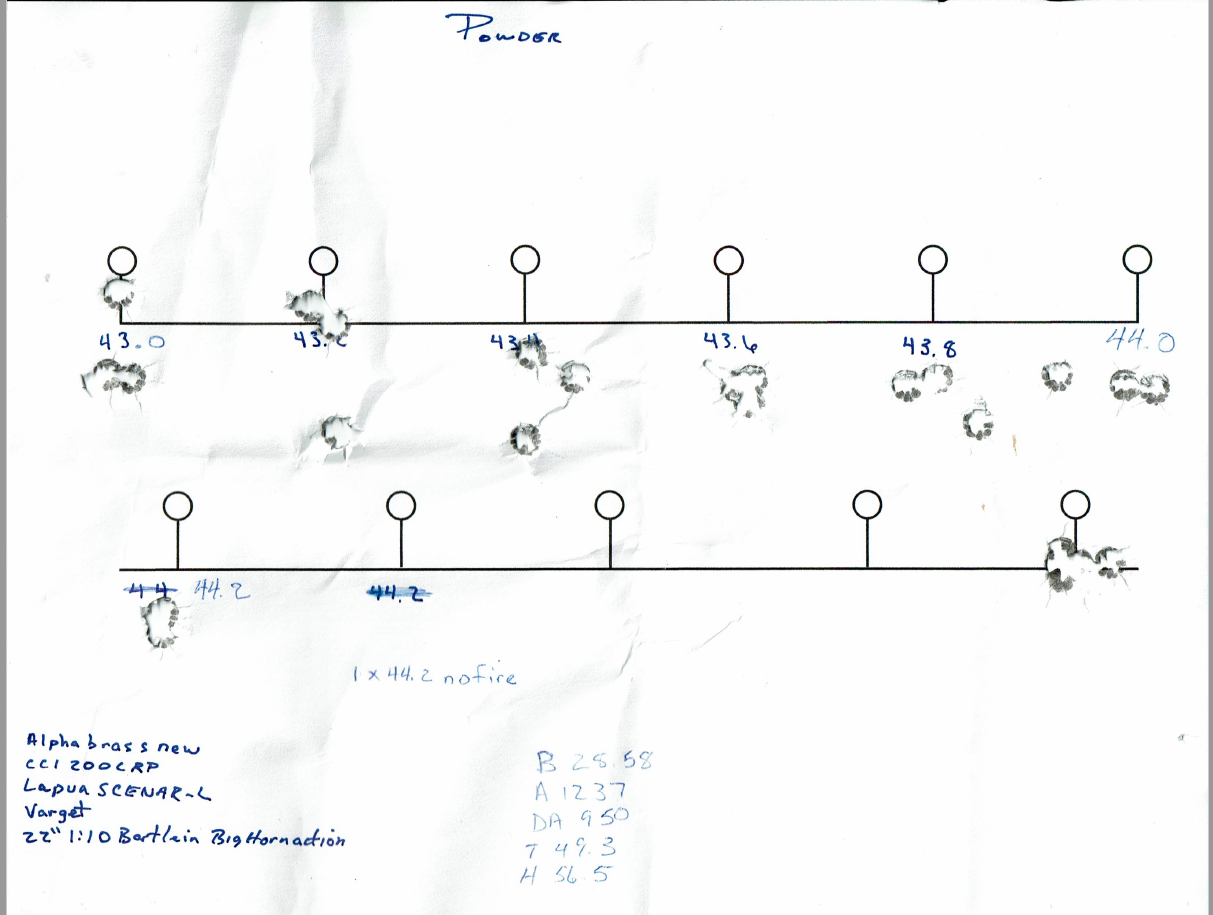

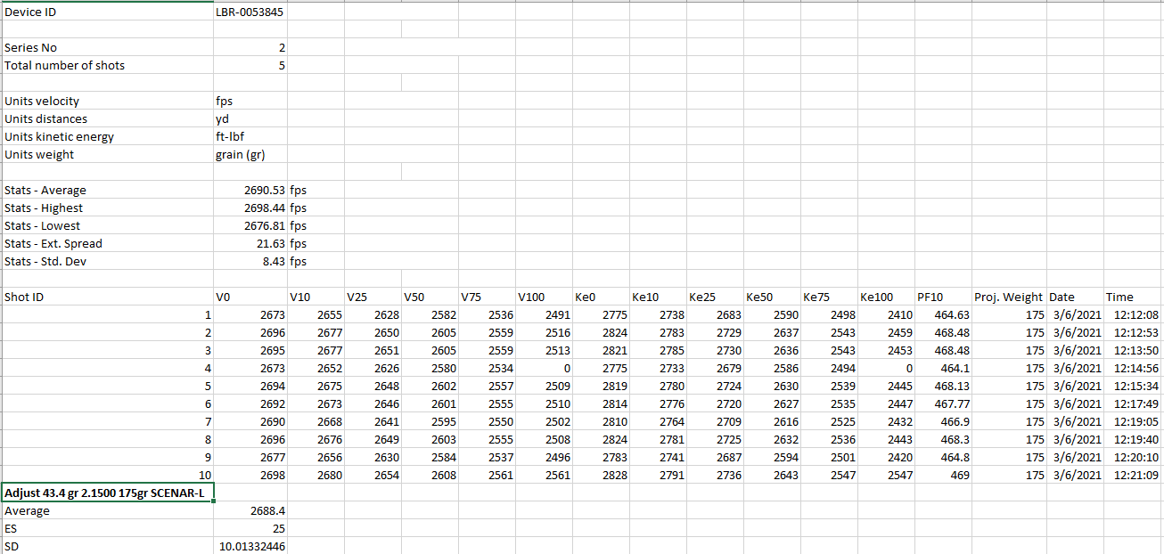

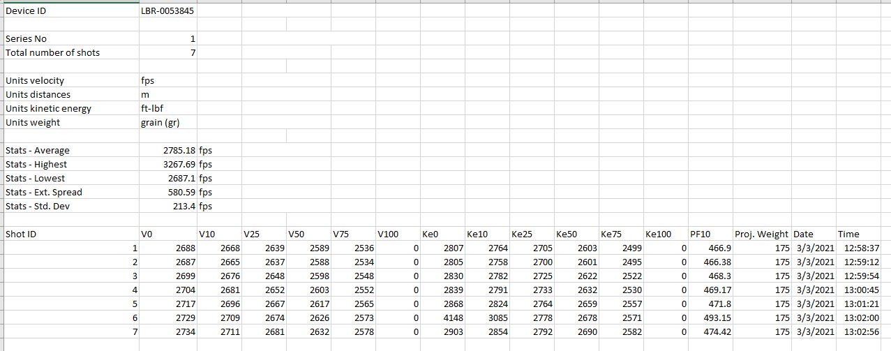

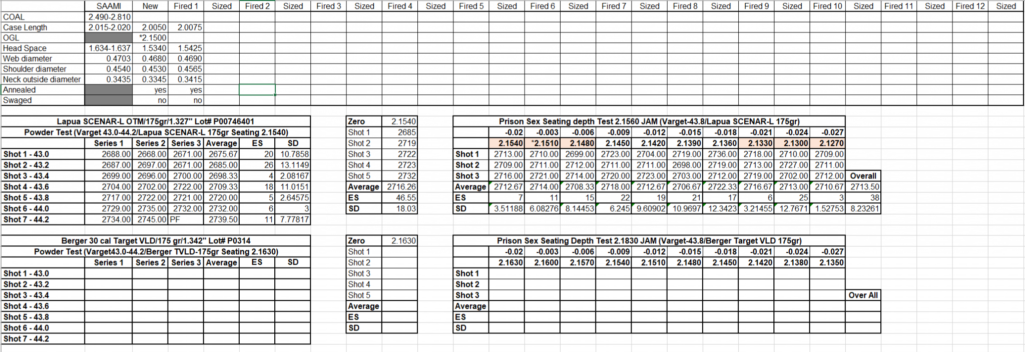

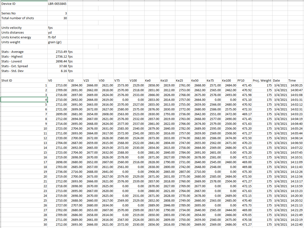

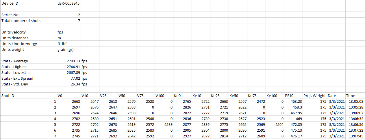

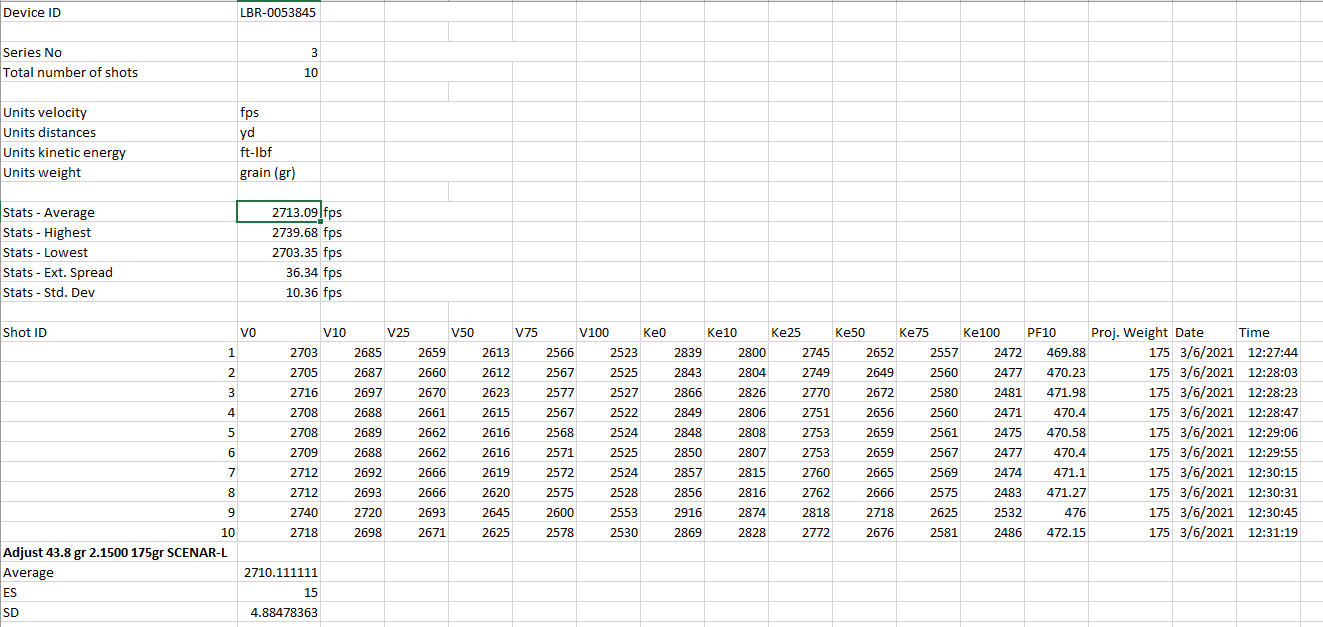

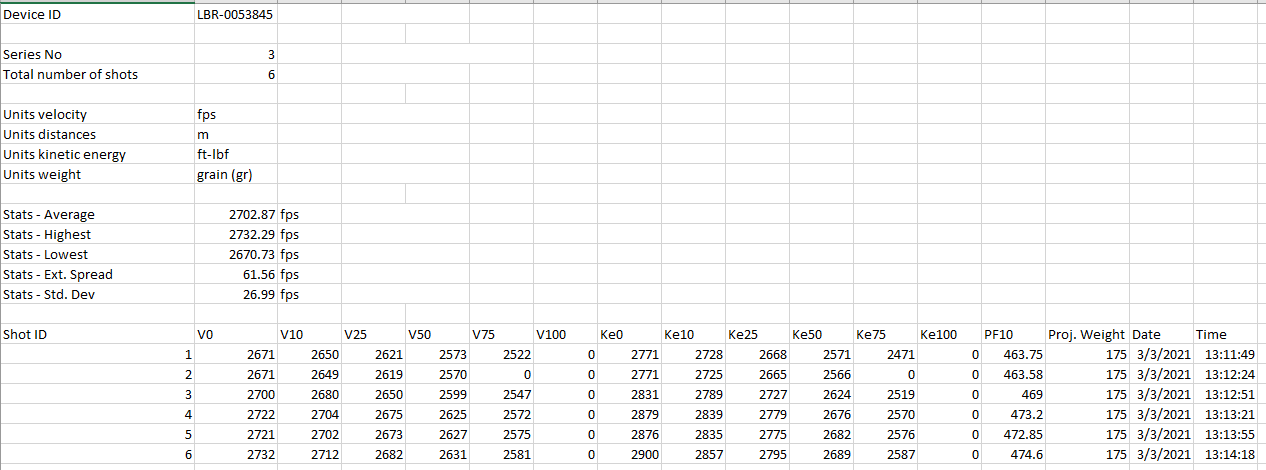

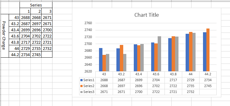

attached are the results of my first reloading experience.
Alpha Munitions brass new
CCI 200 primers
Varget
Lapua SCENAR-L 175gr
BP 28.58
ALT 1237
DA 950
T 49.3
H 56.5
Edit: Forgot to add some testing I did at 43.4 and 43.8 and seating depth data. Seating depth for the 43.4 & 43.8 tests done at 2.1500. Seating depth prior as done at 2.1540
On the grouping target, on #4 the high "flyer" was a 2 click adjustment on my scope. I took a click off and shot the other 4 rounds.

22"Bartlein 5R barrel, Big Horn action, XRG xray chassis. NF ATACR 7-35x56
CCI 200 primers
Varget
BP 28.58
ALT 1237
DA 950
T 49.3
H 56.5

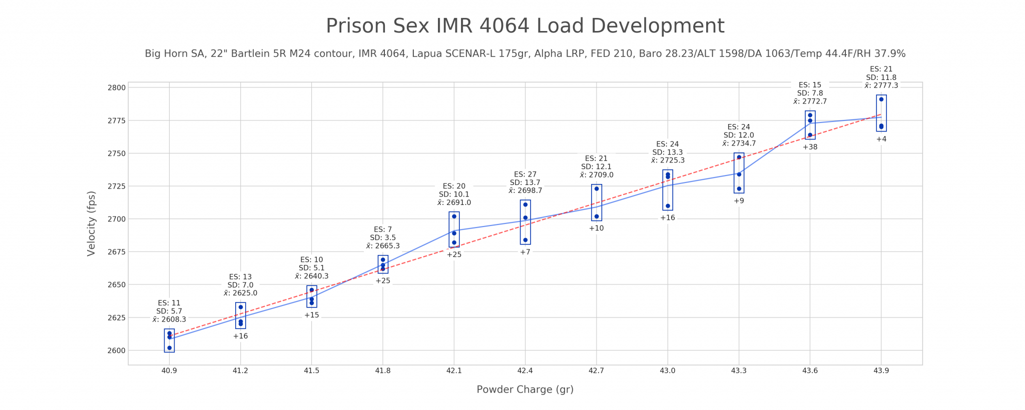

Which software is this that you’re using for the data and graphs?
Thank you
Billy
@BillyD Graph was created from data collected from my LabRadar. Which was taken off the SD card from said LabRadar. The data comes populated as you see in an excel spreadsheet.

Capturing both a velocity node and minimal POI shift, 43.6-43.9 looks like a winner!
