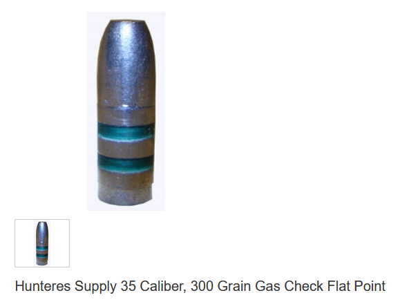

So my goal is hog hunting/eradication using a .358 FAL with a suppressor. The goal is a subsonic (~1050 fps) load using a heavy bullet. I found a 300 grain cast bullet (Brinell 15, G1 BC .168, stabilizes in a 1:20 or faster barrel) from Hunters Supply.
