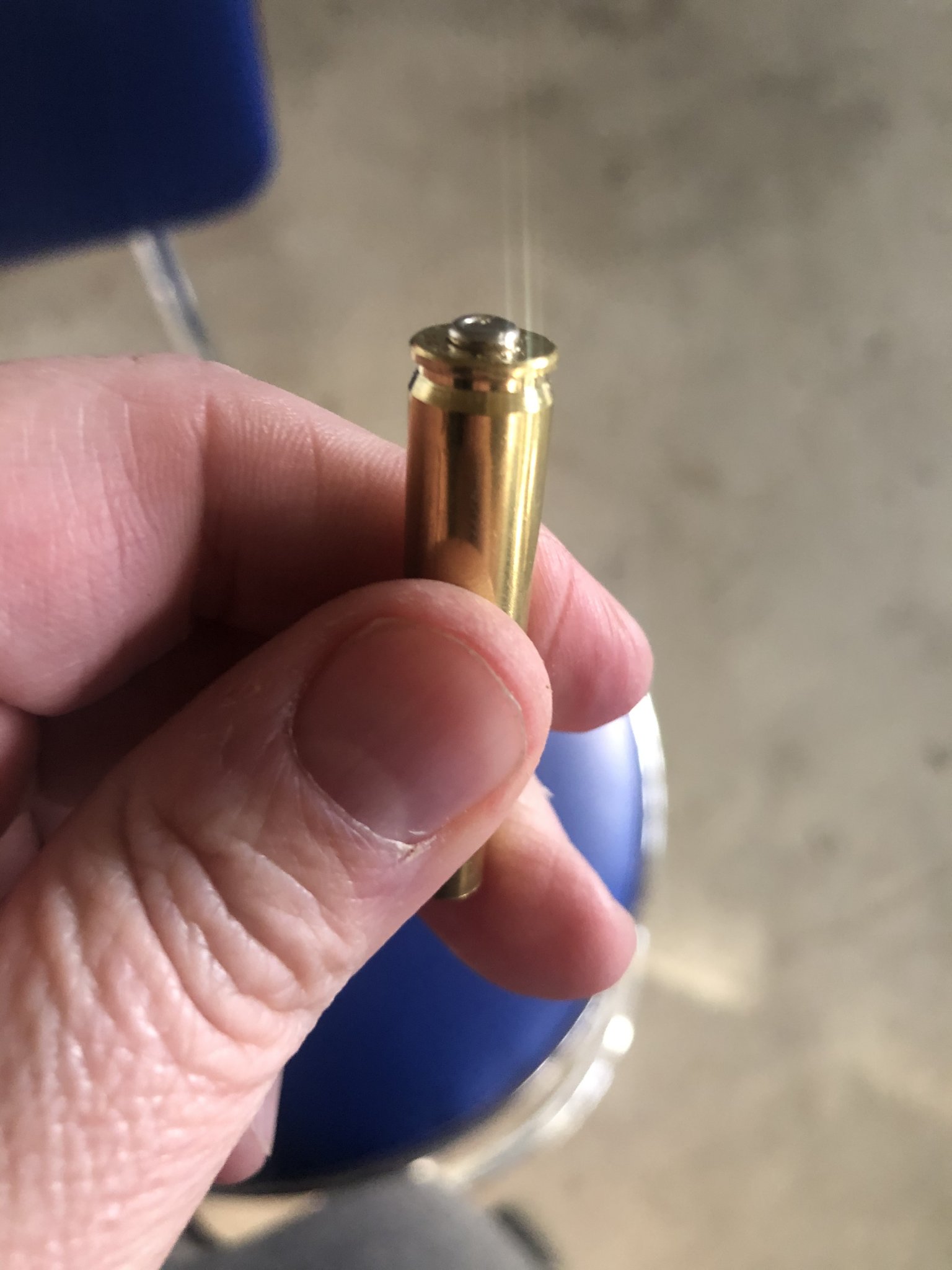

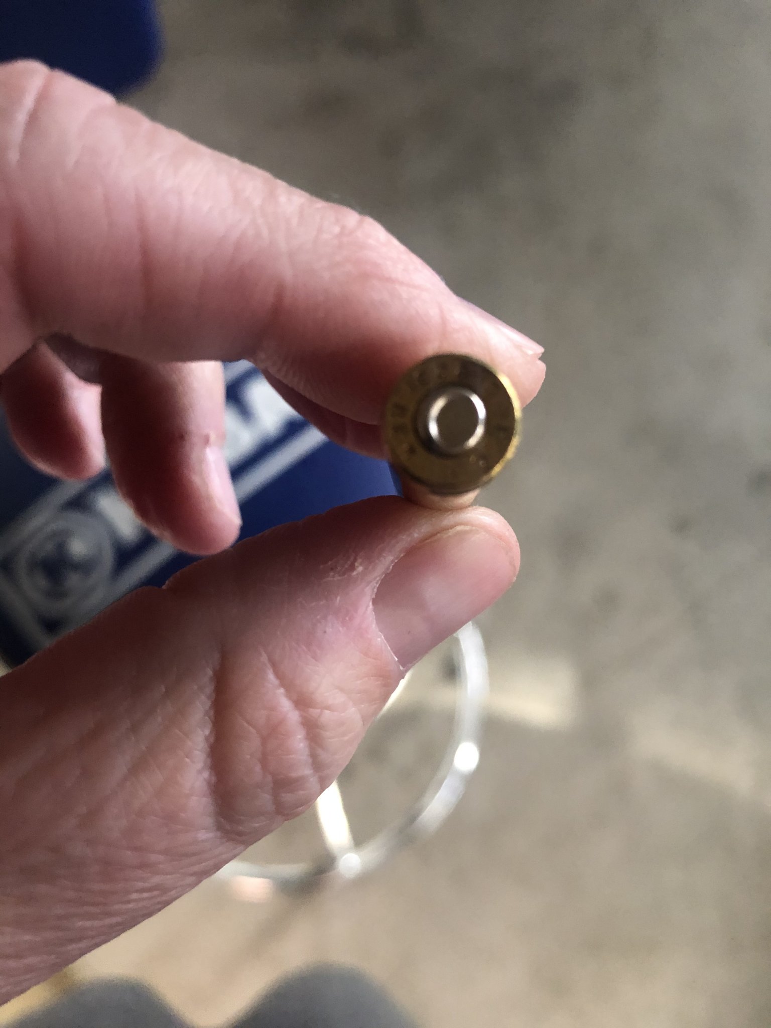

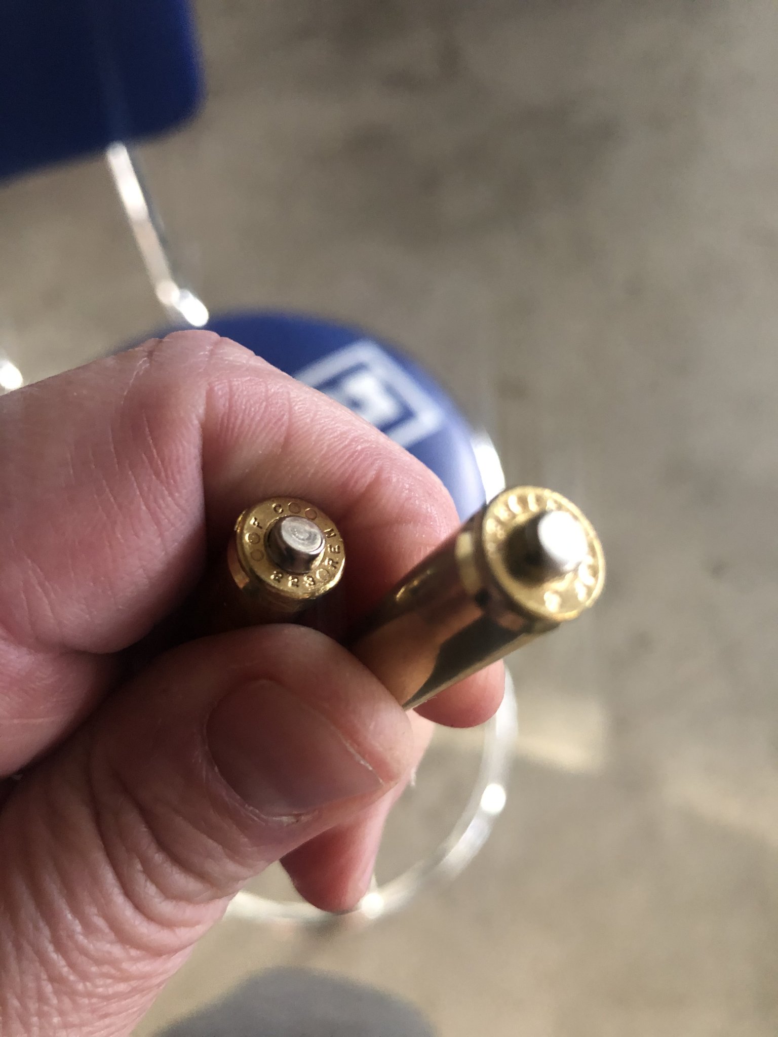

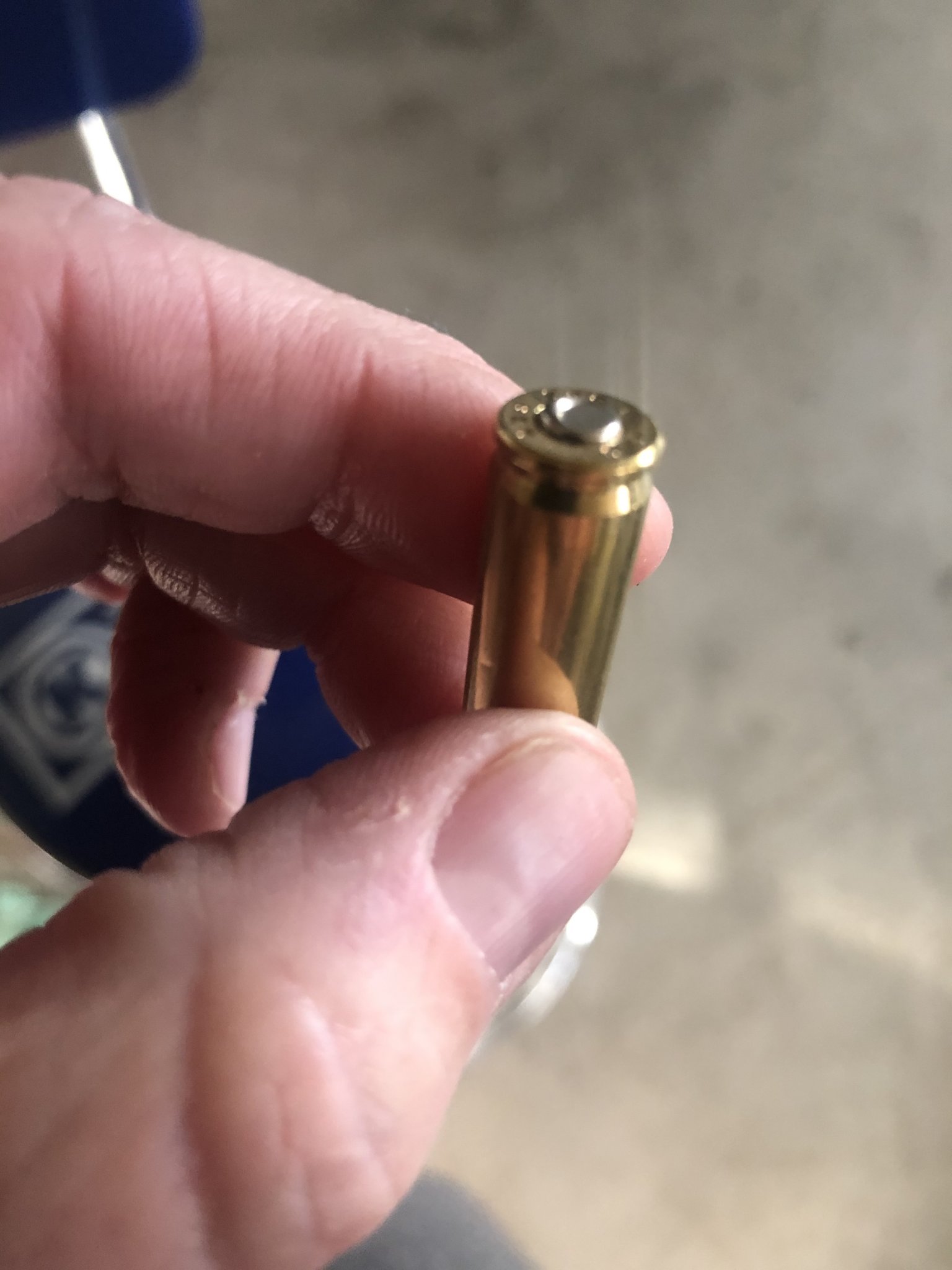

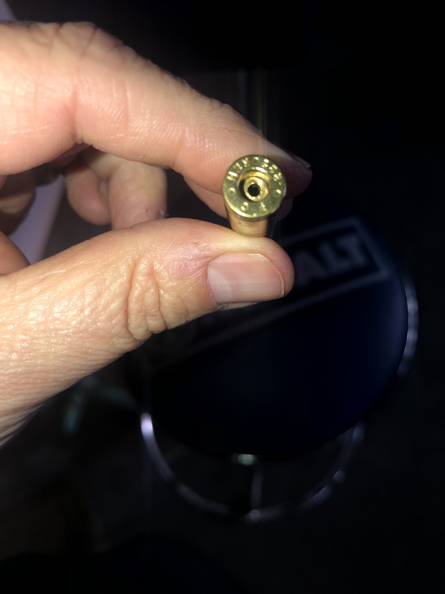

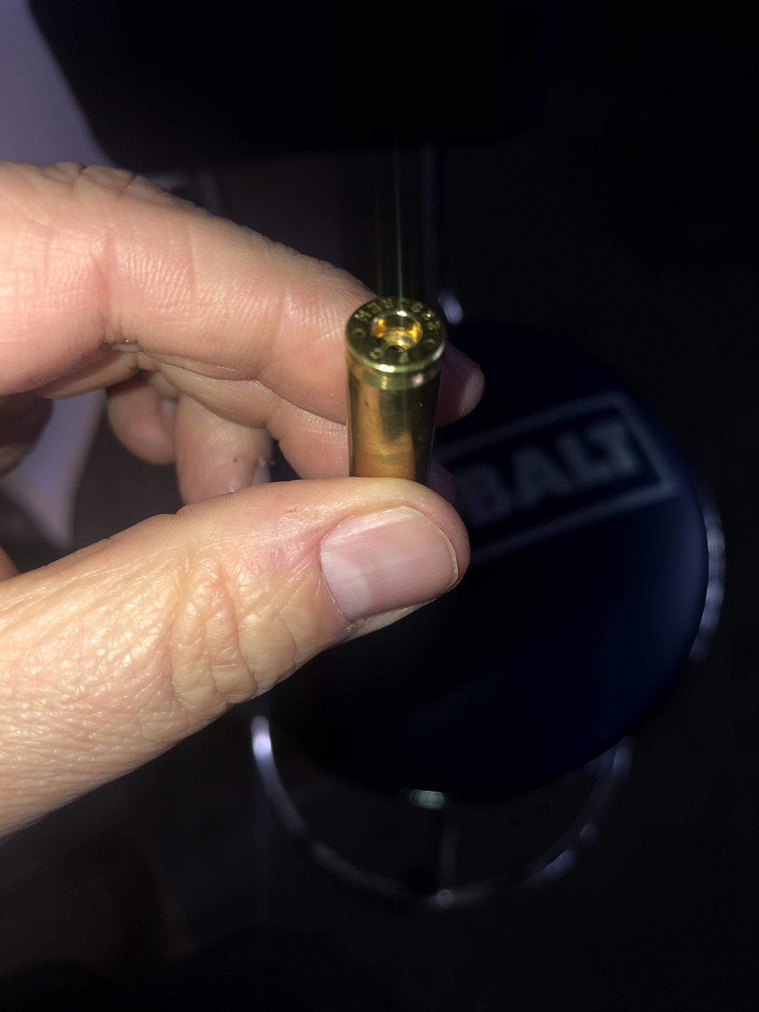

New to reloading, bought a bunch of once fire brass that had been processed. I separated them by head stamp and started seating primers with my RCBS universal hand primer. Primers are Fed 205’s and FC brass. Some of the primers seat and some don’t. They’ll crush or won’t seat at all. With the price of primers and they’re hard to find, this is getting spendy. These are being reloaded for an AR.
67D4C630-1CEE-4EAA-B5F5-FCA3A78437F4.jpeg0F358FEE-B4B4-4950-82B7-E512F726B093.jpegA5375F63-076C-433A-9F29-EF735A00DF9F.jpeg7DB4909C-9C20-49DA-A107-B8F6BD034D9B.jpegD3898906-E9F9-4099-BF77-AD1146563027.jpeg8119A3B4-BAAA-4715-A9A0-B82D5C997B28.jpeg580E94A4-D78D-477F-804B-1CB29F15A29F.jpeg

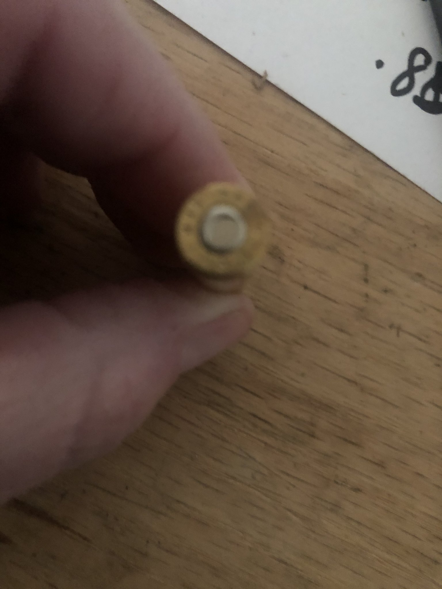

View attachment 7544079View attachment 7544080View attachment 7544081View attachment 7544082View attachment 7544085View attachment 7544091View attachment 7544092

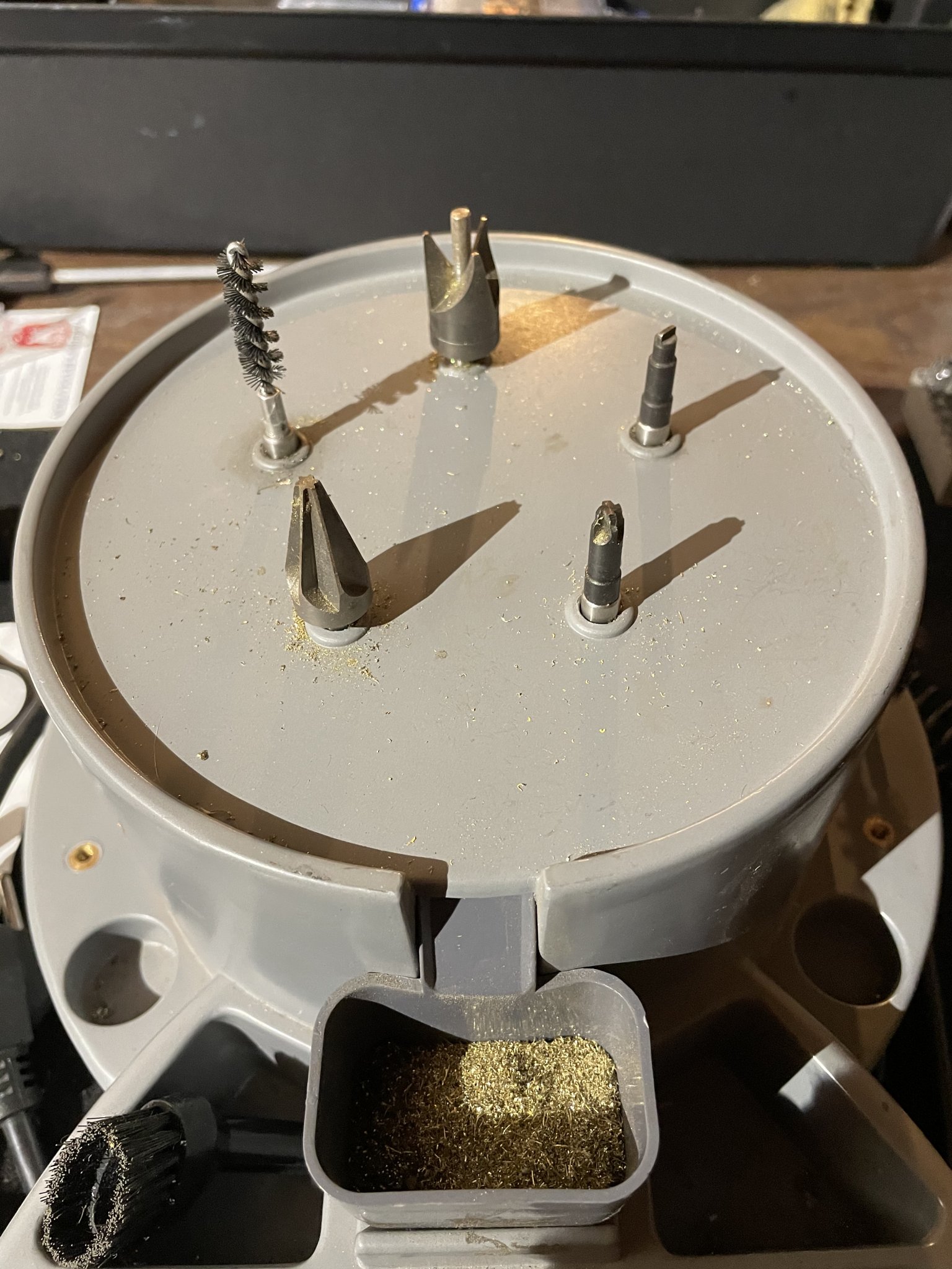

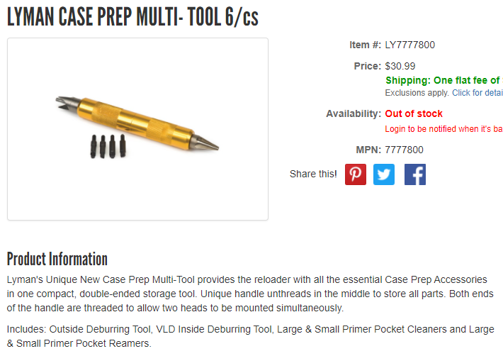

Pop the bad primer out and use the Lyman primer pocket reamer. I have found that swaging does not always remove enough of the crimp.
I bought them from a member on another forum fully processed. Guess there was a step left out. I’ll have to buy that tool.
He may have swag them but it doesn't always work. Get this crimp cutter
Reactions: Josh555 and Kra961
I too have bought fully processed lc brass that was swaged and had the same issue seating primers.
This is why I dont swag shit. RCBS crimp cutter on case prep center. Cuts it right out one and done
I have mine on the Lyman case prep center. Cuts the crimp right out, and don’t ever have to worry about it.
Guess I’ll go buy another prep center. Sold mine a couple years back when I got out of reloading. Thanks for all your answers.
Reactions: PusherX11
Yep mines on my Frankford Arsenal Platinum case prep center.

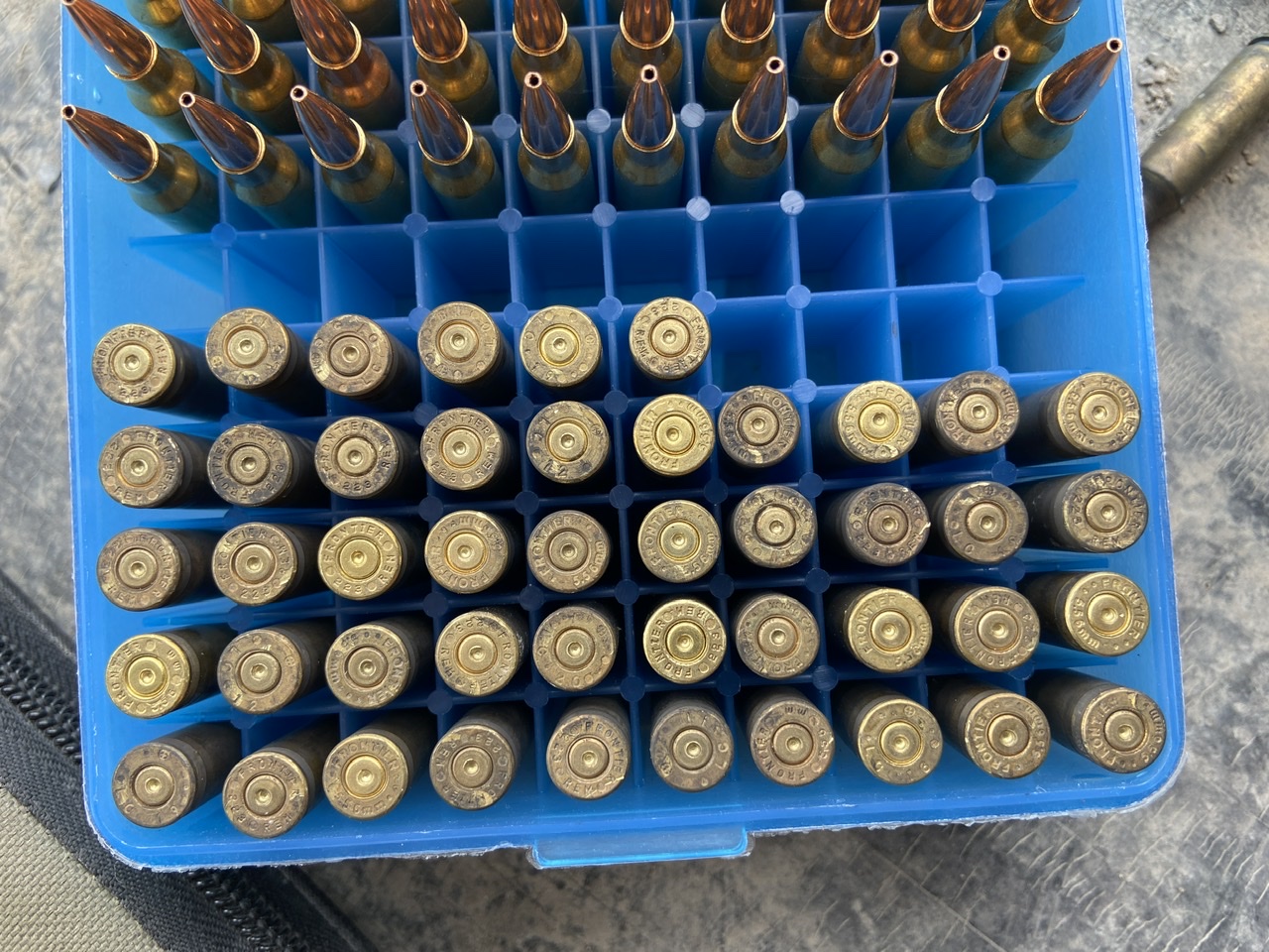

Question for all. Crimp or no crimp? My experience loading for the AR platform is limited. Most of my loading for the AR will be coyote hunting extending to mid range plinking based. However, I do want to load some FMJ “ shoot the hell out of it” stuff too.
I've never crimped a round for an AR. Some do but after many thousands of rounds, never had 1 issue.

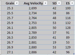

Charges were weighted on FX120i and all high-end equipment was used in the reloading process. Every group shot poorly, so much so that I didn't even go grab my targets. I'm trying to diagnosis what the hell is going on with my SD/ES. I'm going to try Varget next and I'll anneal before sizing/mandrel work to ensure a better neck tension even though with mixed brass, there is going to be wide variations.

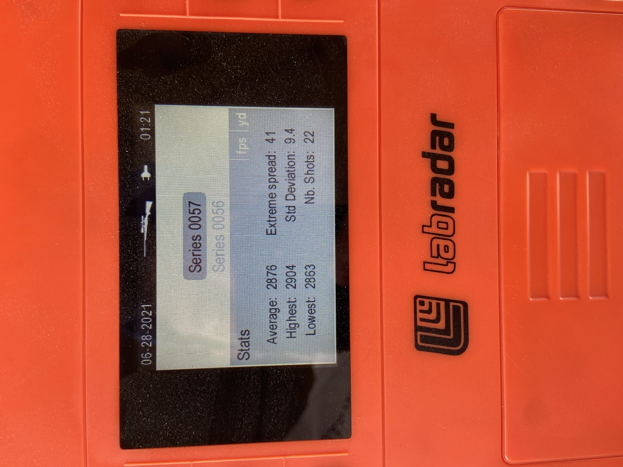

I don't care too much about my AR15 loads but this is far from acceptable to me. I'm in single-digit SD/ES with my 6BR & 6.5 Creedmoor bolt guns.
I found your problem.
What did you expect using brass with varying case capacities? Different case capacities, different pressures, different velocities, different barrel harmonics = a non precision loads
It isn't like I am expecting single-digit SD and ES like my bolt guns. However, I figured I would be sub 25 SD and sub 50 ES.
Mixed brass will easily cause your issue. If you want sub 20 SD you're gonna need same headstamp brass at minimum. When I run Mixed headstamp brass my SD is usually 25-30 over a 30 shot average, ES is right about 100 or so. Gives about 2-3 MOA accuracy out of any AR I put it through.
