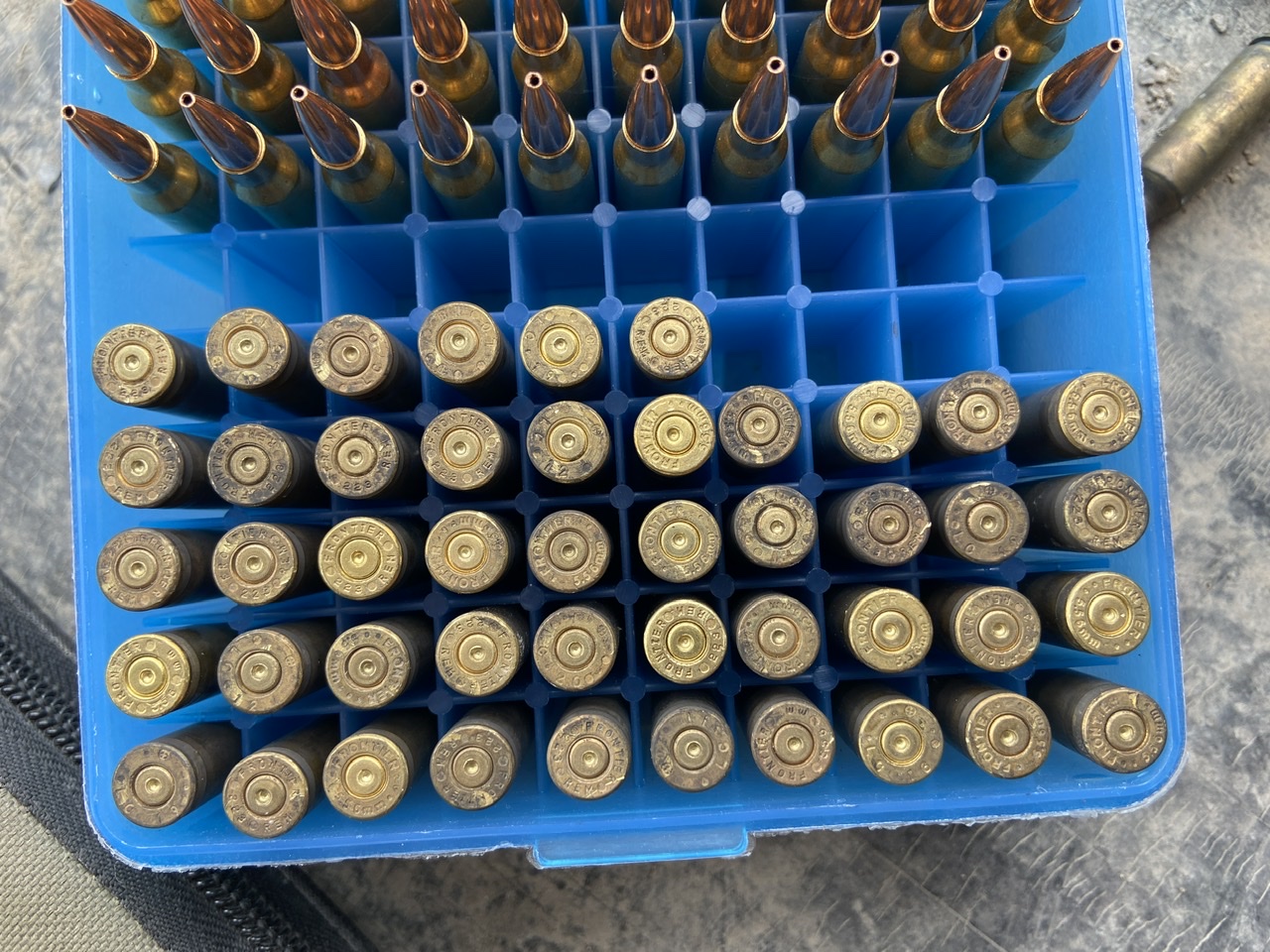

77 SMK
LC Brass
CCI 200
23.8gr 8208 XBR
2830fps avg out of my PRI Mk12 Mod0 with Omega can/5.56 end cap. Super accurate, but very warm load. Brass doesn't look too beat up. Primers are on the edge (flat, some flow around firing pin), but never pierced or popped one. May need to switch to #41s, or back off a few tenths of a grain.
I see several people shooting this load but I have found it to be hot as well. It could be chamber differences, powder batch, etc but I turned my load down to 23.3, found that I didn't lose a lot of velocity, and I am not killing my brass.

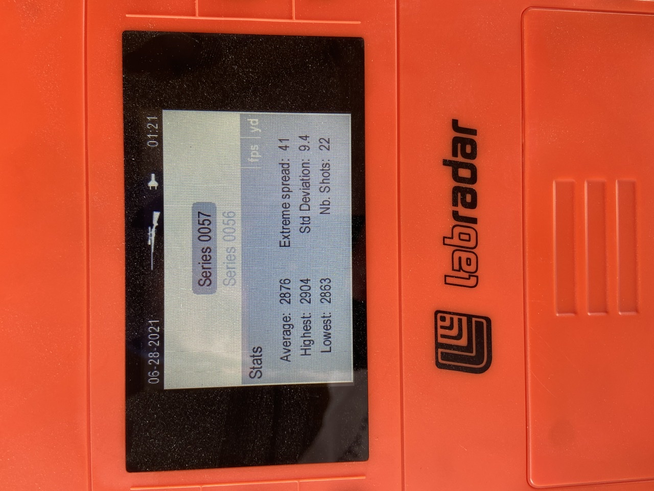

With Lapua brass and 77 TMKs, 5 shots over a Labradar yielded single digit SDs.

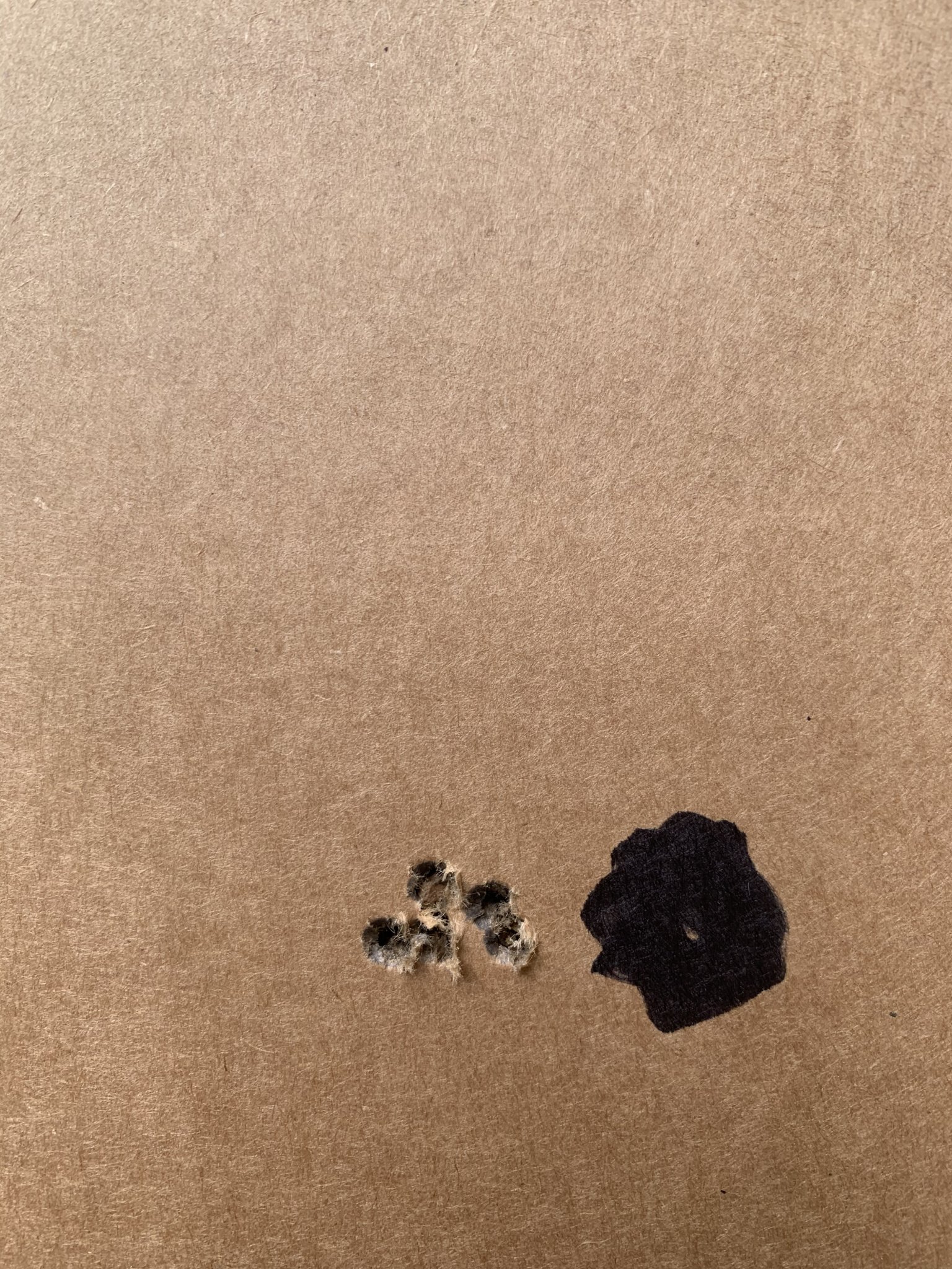

69 SMK
Mixed brass
25.3 grain of varget
2.250 seating depth
Cci41 primer.
Average velocity 2725 out of a suppressed 16 inch barrel.
Group shot at 100 yards. 5 shots

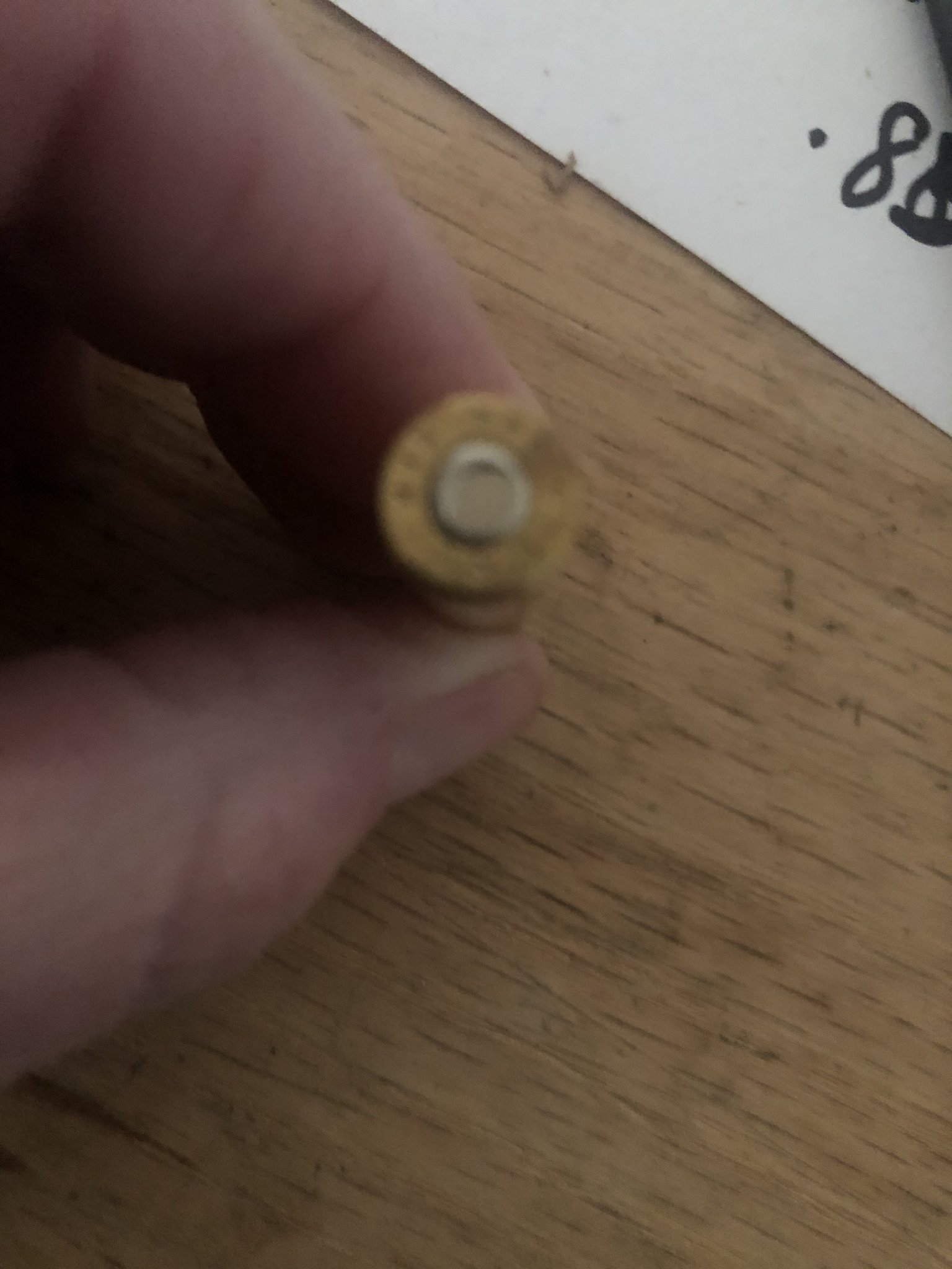

I had to go to Small Base for my loads cause about 1 in 15-20 rounds wouldn’t load. I size all my AR brass with a Small Base die and haven’t had any issues since.

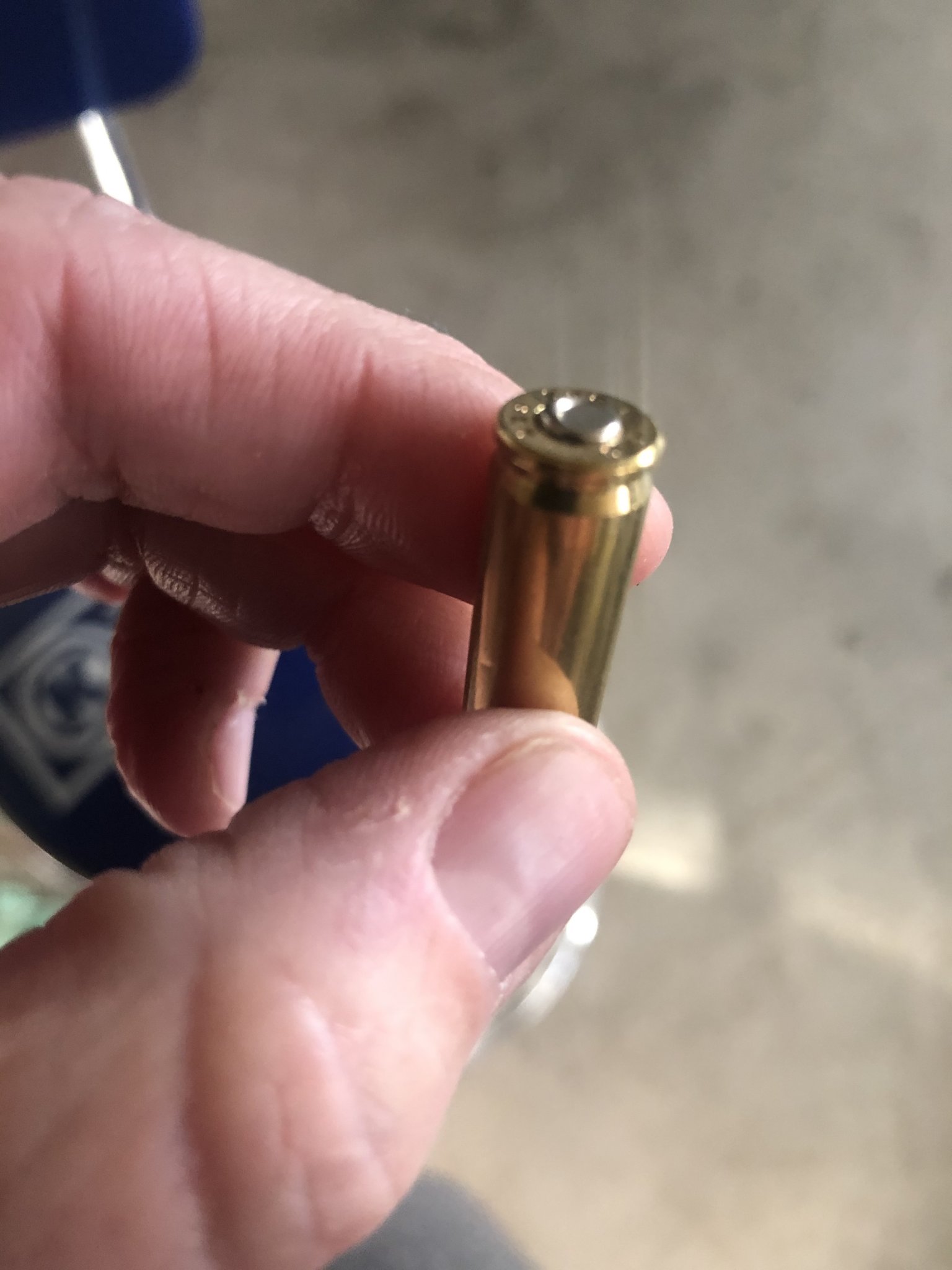

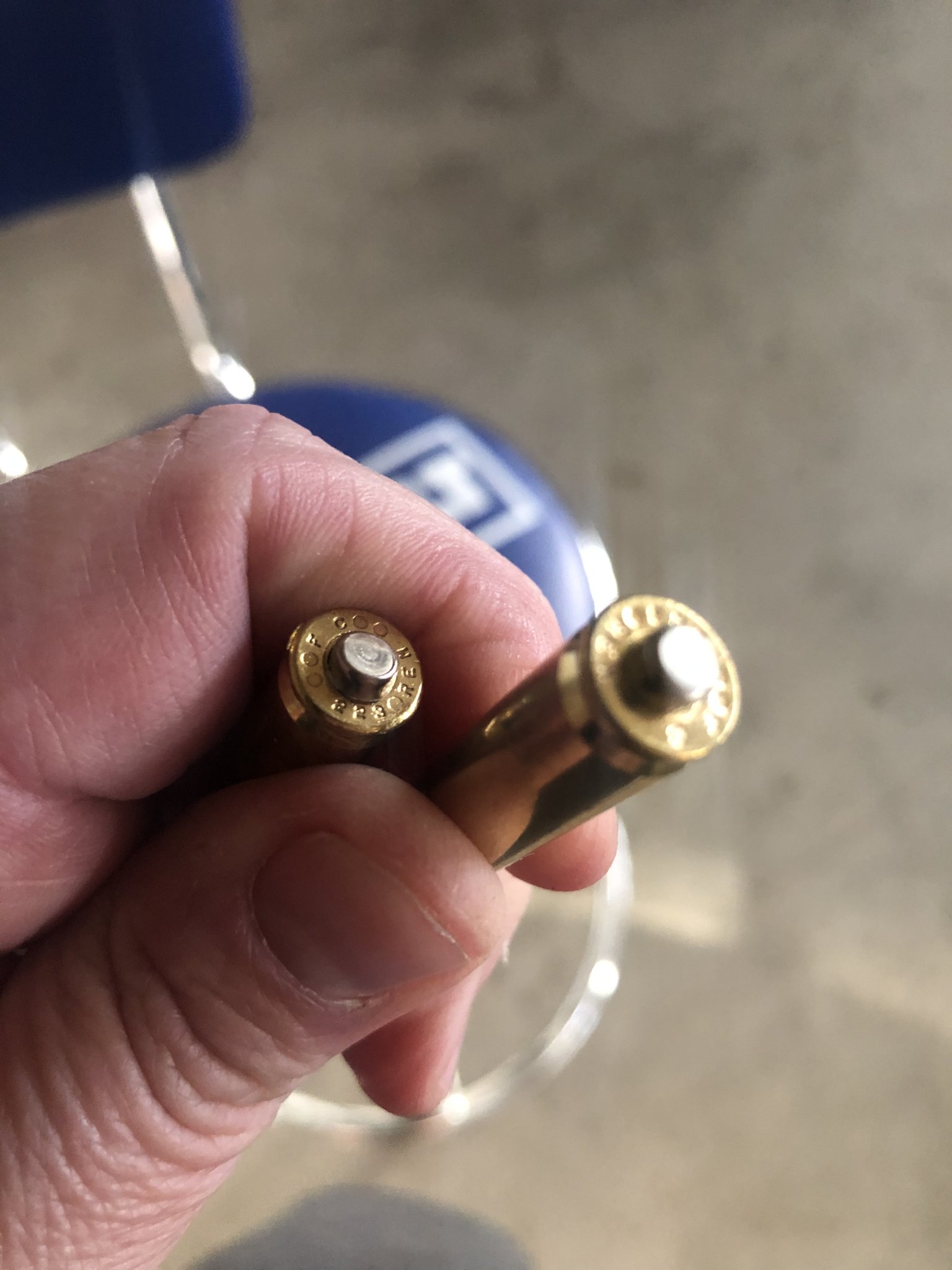

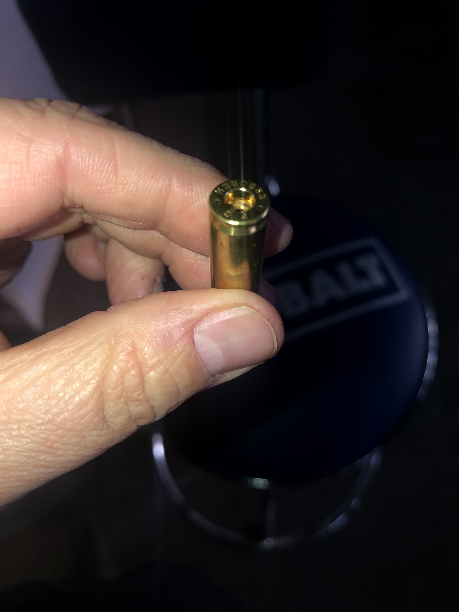

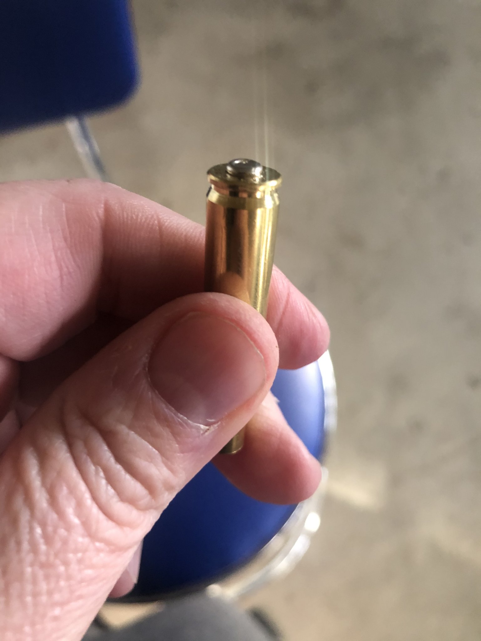

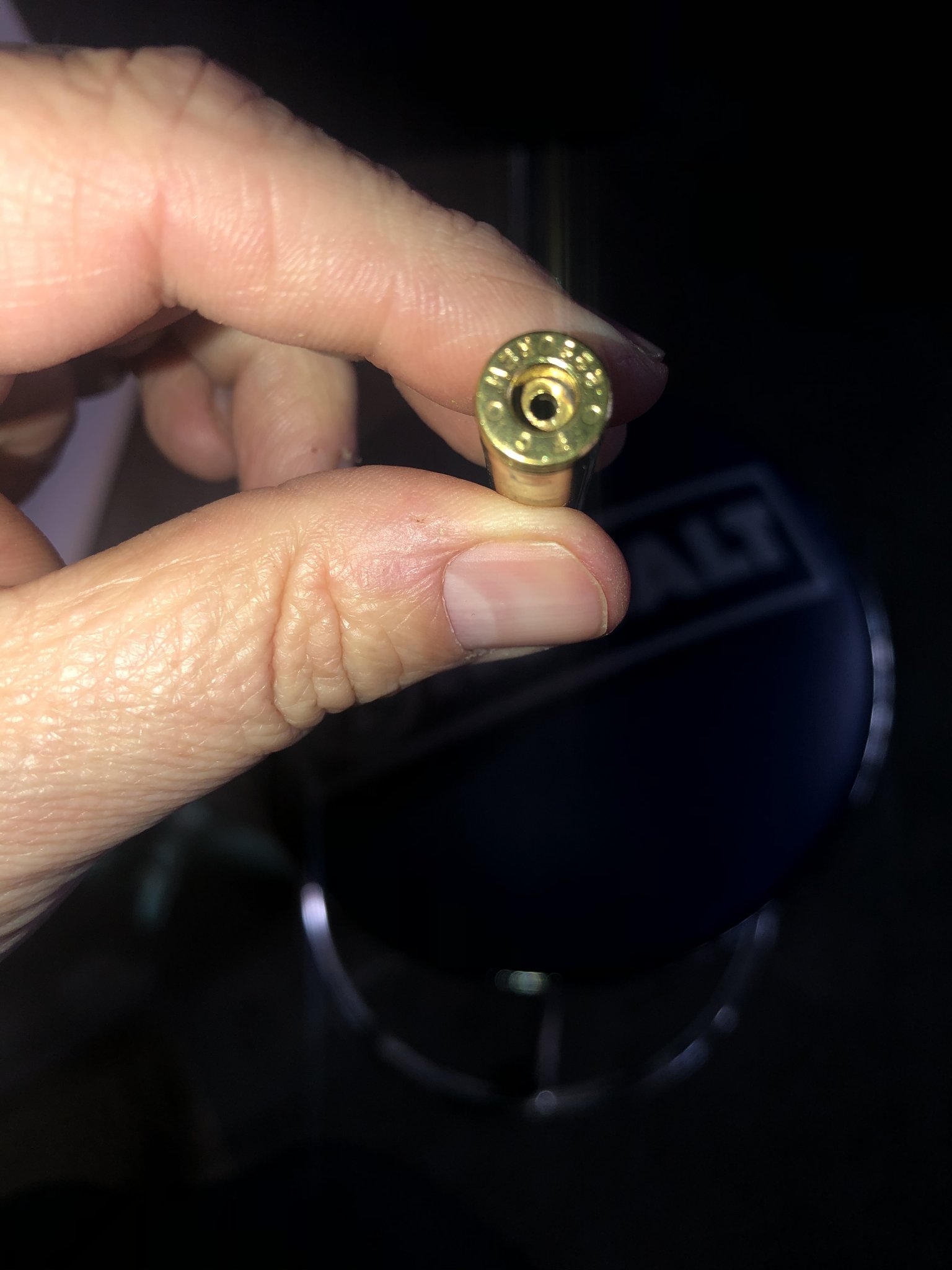

New to reloading, bought a bunch of once fire brass that had been processed. I separated them by head stamp and started seating primers with my RCBS universal hand primer. Primers are Fed 205’s and FC brass. Some of the primers seat and some don’t. They’ll crush or won’t seat at all. With the price of primers and they’re hard to find, this is getting spendy. These are being reloaded for an AR.
View attachment 7544079View attachment 7544080View attachment 7544081View attachment 7544082View attachment 7544085View attachment 7544091View attachment 7544092

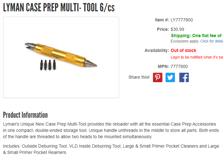

Get yourself a primer pocket swage gauge and a RCBS crimp remover. Some of the crimps really smash the brass so it’s a good idea to gauge the pocket before crushing a primer trying to get to fit.
...I would suggest this tool kit, economical and has everything you need. As a new reloader, using it in manual mode will ingrain the feel and knowledge you will develop the more you use it. But.....if time is a factor, you can always chuck up the bits in a hand drill/screw driver to speed things up ;) Tool can be purchased practically anywhere, storefront, online, etc.
I use the pocket reamer from this tool in a cordless drill to remove primer crimps from Federal and LC brass.
