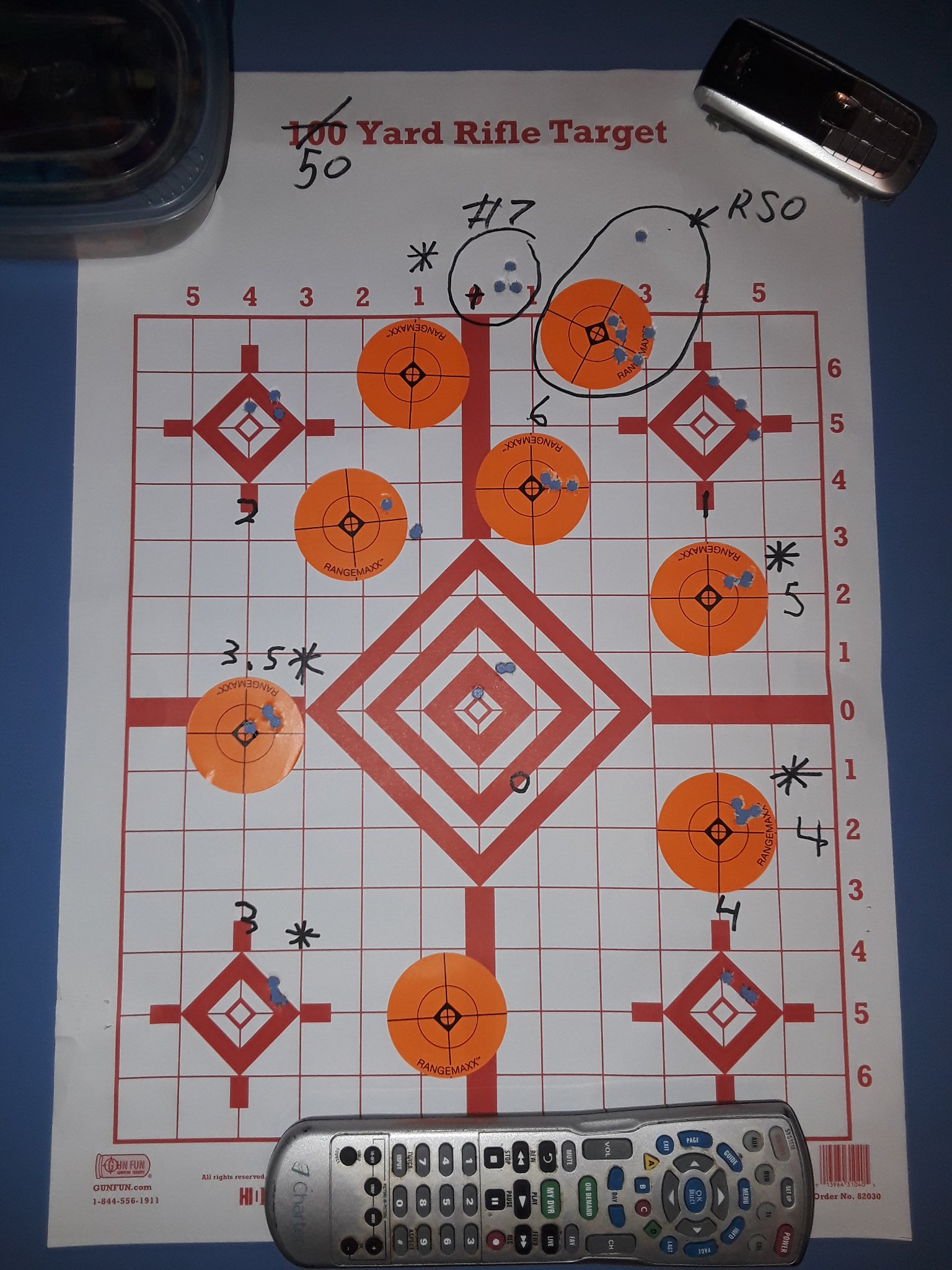

View attachment 7863574View attachment 7863575This is a load post with some follow up questions as I’ve never really loaded for an semi auto gun:
Brass: Lapua 223 Match
Powder: 8208 XBR @ 23.3 gr.
Bullet: Berger 77 OTM
Primer: CCI BR4
Vel. - 2,666
SD - 10.2
First test group came in at .690 MOA, and subsequently produced 3 sub 1/2 MOA 5 shot groups. I’ll try and include a few pics.
Barrel is a 15.1” 1:7 mid-gas Douglas spun up by Frank at Compass Lake with their CLE chamber. Colt BCG.
A friend invited me to a DMR match, and having not shot a match and getting out of reloading since 2019 it was a scramble to get things ready.
A buddy hooked me up with 200 new Lapua cases, and the Berger’s. Another had the 8208 XBR, and I got lucky on the BR4’s local.
I trusted a friend I’ve shot with for years heavily on the initial load of 23.3 grains, and I believe they were loaded to 2.255” OAL approx. I have the CBTO written down somewhere I’ll find later. First 5 shots were .690 MOA, no pressure signs on the brass. A few more test groups and we just went with it on the subsequent 180 rounds for the match.
I do know he used a light crimp also.
Now comes the question segment. I used a Hornady comparator and got a shoulder measurement over a pieces of 1.4560 and then fired shoulder of 1.4620. So it’s growing .006” in my chamber.
In my old PRS rifle I always FL sized with .002”shoulder bump. What would everyone suggest in this instance? I was thinking.004” bump to be safe, or should I go back to the original virgin brass shoulder length and size .006”? Is this working the brass too much? I know brass life with a AR is going to be terrible. Long term I’ll try and source some stat line 5.56, but short term the Lapua was an overly nice means to an end.
I plan to anneal them, as in always did with bolt guns. Trim if necessary.

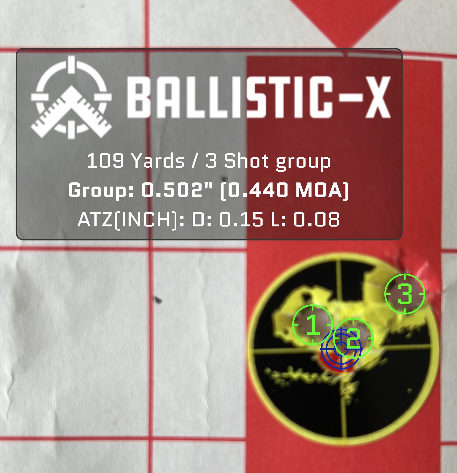

I’m running 26.0gr of Xterminator over 55gr Berry’s FMJ as blasting ammo. I just load to the crimp and shoot. Easy to do with LC FL resized brass and relatively inexpensive.
I want to load up some fast 60gr SP for yotes and one thing I love about western powders is they have actual 5.56 data. I want to do some load development but the rifle I shoot is topped with thermal and with it getting dark at 9:30pm and over 102°F during the day it’s pretty difficult :)
I might be barking up the wrong tree but figured I go ahead and ask...

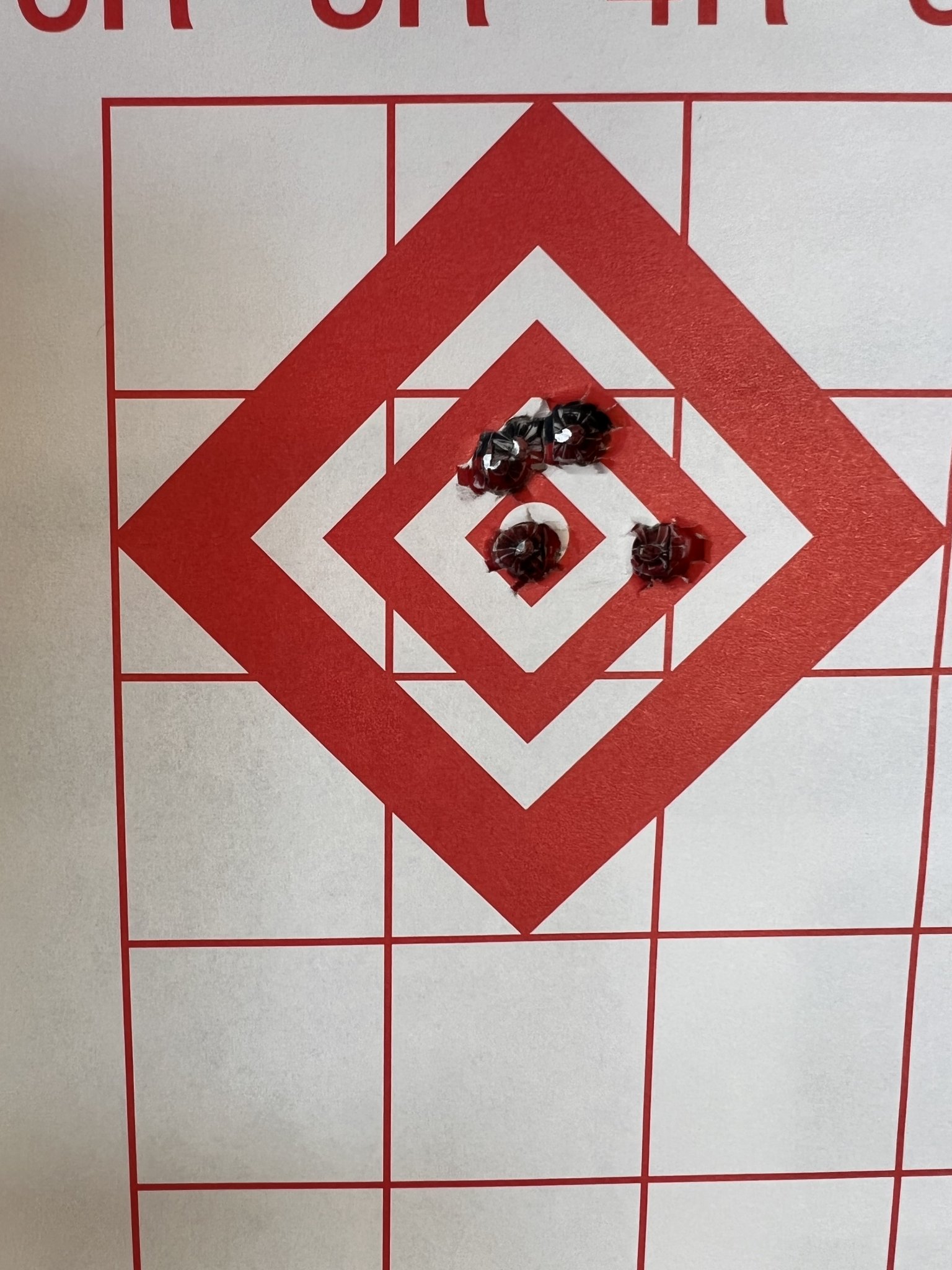

I am at a cross roads wanting to run 224 bullets fast, specifically 75gr BTHP and 77gr SMK. I am unsure if I can get there in a 223 Wylde and was considering the 224 Valkyrie.
I have a 18" Douglas 1:7 223 CLE Chamber. Freedom Munitions 77gr SMK gets 2650fps, Frontier 75gr gets 2800fps, and my handload gets 2758fps

Well duh.
Waited for a couple weeks to get back on the range only to find an error that will need retested all over again.
To top it off laziness caused it but has proven a point besides not to be lazy.
The test was H335 / 25.2g in frontier range brass reconditioned with a 0.003 bump and 0.002 neck tension . Running 55g Bob's bullets with a slight crimp. 1.800 bto and nominal 2.25 coal.
Ar 20 inch barrel .
The first 9 shots told me I had messed up. Before moving to the dillon the best single stage shots were at tuner set to #1 and powder dropped at 25.3g.
The first 3 tests told me I had screwed up not tweeking that last tenth of a grain into the dillon.
Further cranking on the E C tuner quickly brought the test shots back into usefulness .
I could live with it but plan on cranking out many loads. The 25.3g loads tested were rounder.
So the powder drop will be fought with till 25.3g is consistant on 2 different scales. (Pita)
This test was done at 50 yards.
The thin grid squares are one inch.
The load is listed on the 8lb jug.
Reactions: Balor
