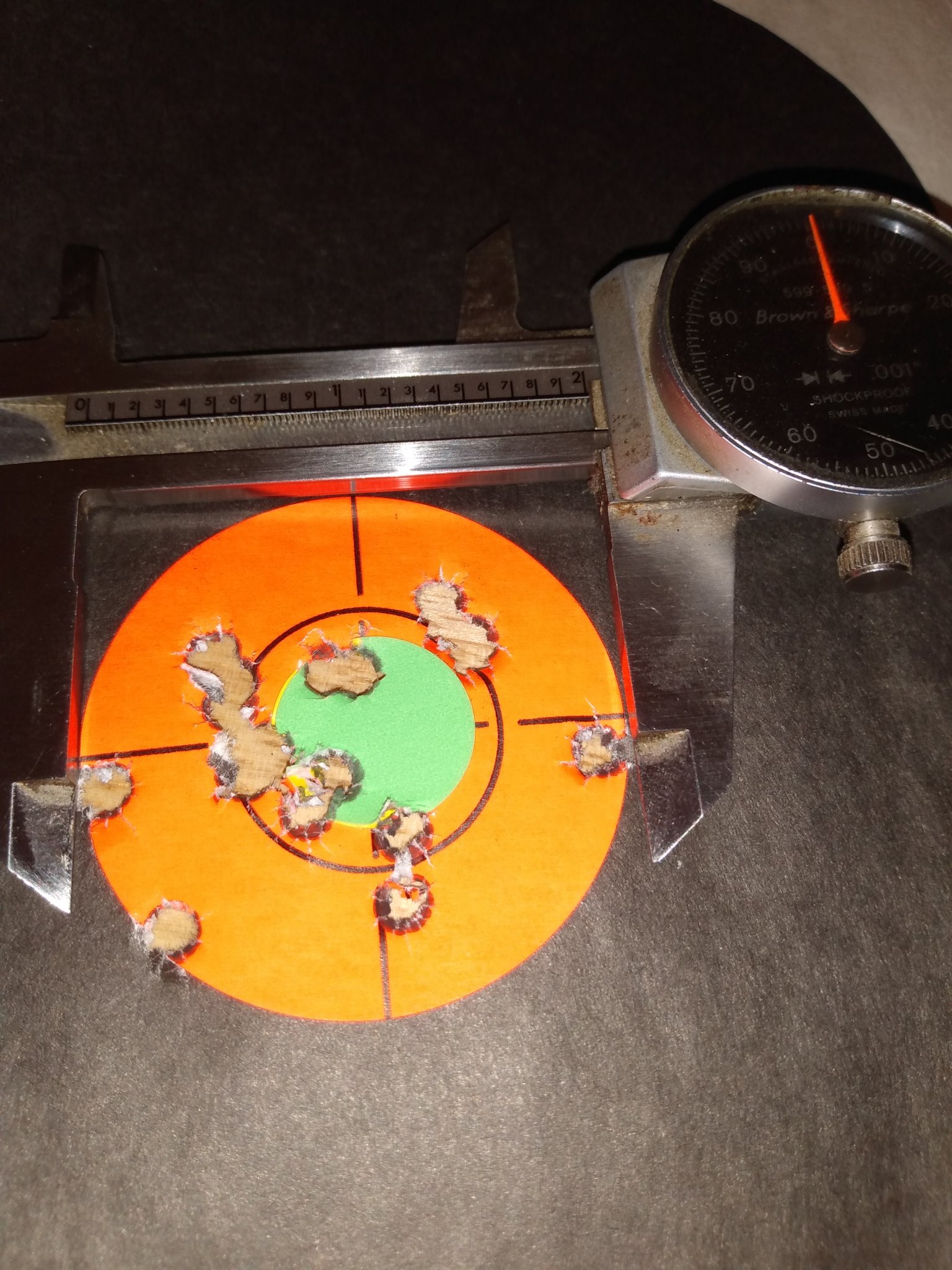

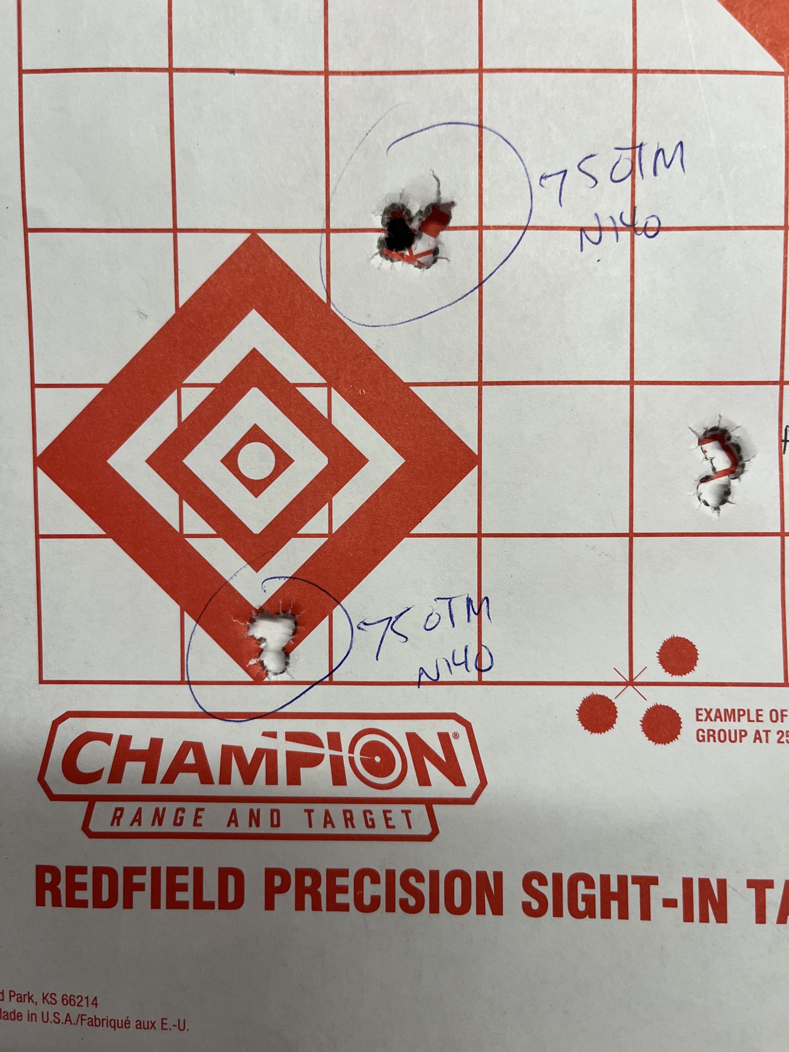

Finalized my load for my 24” lilja on prep for the upcoming competition dynamics team match.
24.4 N140 ended up being the secret sauce I had been using 24.4 Tac but just couldn’t get the consistency, would end up with a flier every couple groups.
Load is 75 Hornady OTM magpul mag leg mtb, cci 450, fc brass, 24.4 n140 2828fps
Groups at 100 yards 1 5 shot and the other 2 are 3 shot

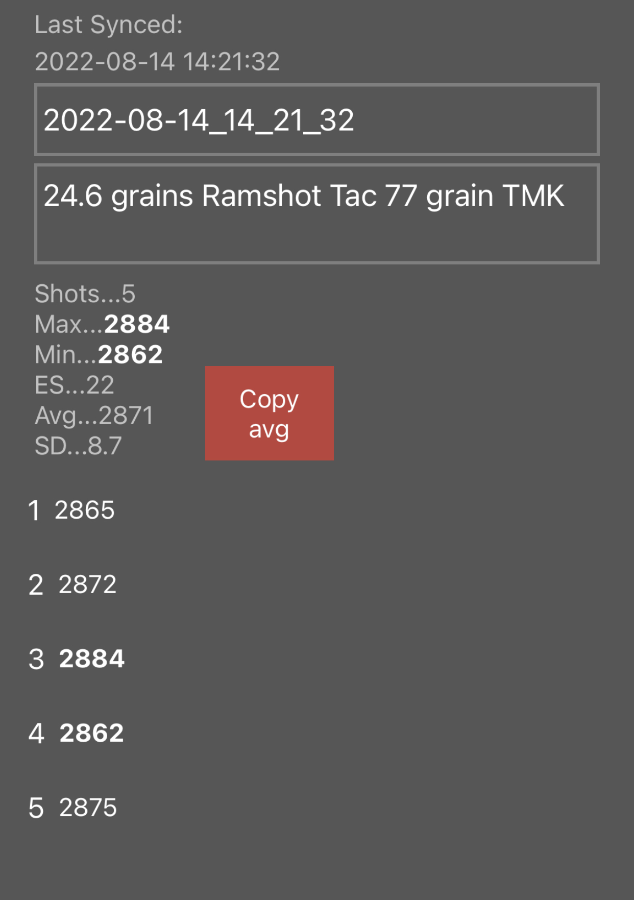

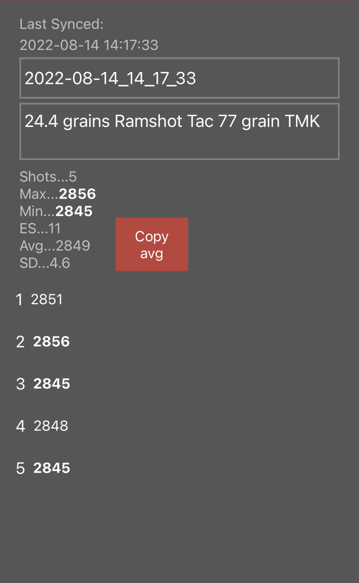

I checked my two loads yesterday and measured the following
TAC - 24.4gr = 2705fps, 6SD and 8ES - best groups with TAC
CFE - 25.4gr = 2756fps, 8SD and 22 ES
Most groups were .5 MOA with a KAC 18" LPR
Why the big jump in velocity for small change in power in .223 TAC and CFE?
TAC - In testing TAC power I found a large change in velocity going from 24.4 to 24.6 - almost 50fps difference
and
CFE - 25.2 to 25.4gr also increased velocity almost 50fps.
Why is this?
all other .2 power increases yield much lower velocity increases.
I did not see any pressure signs.

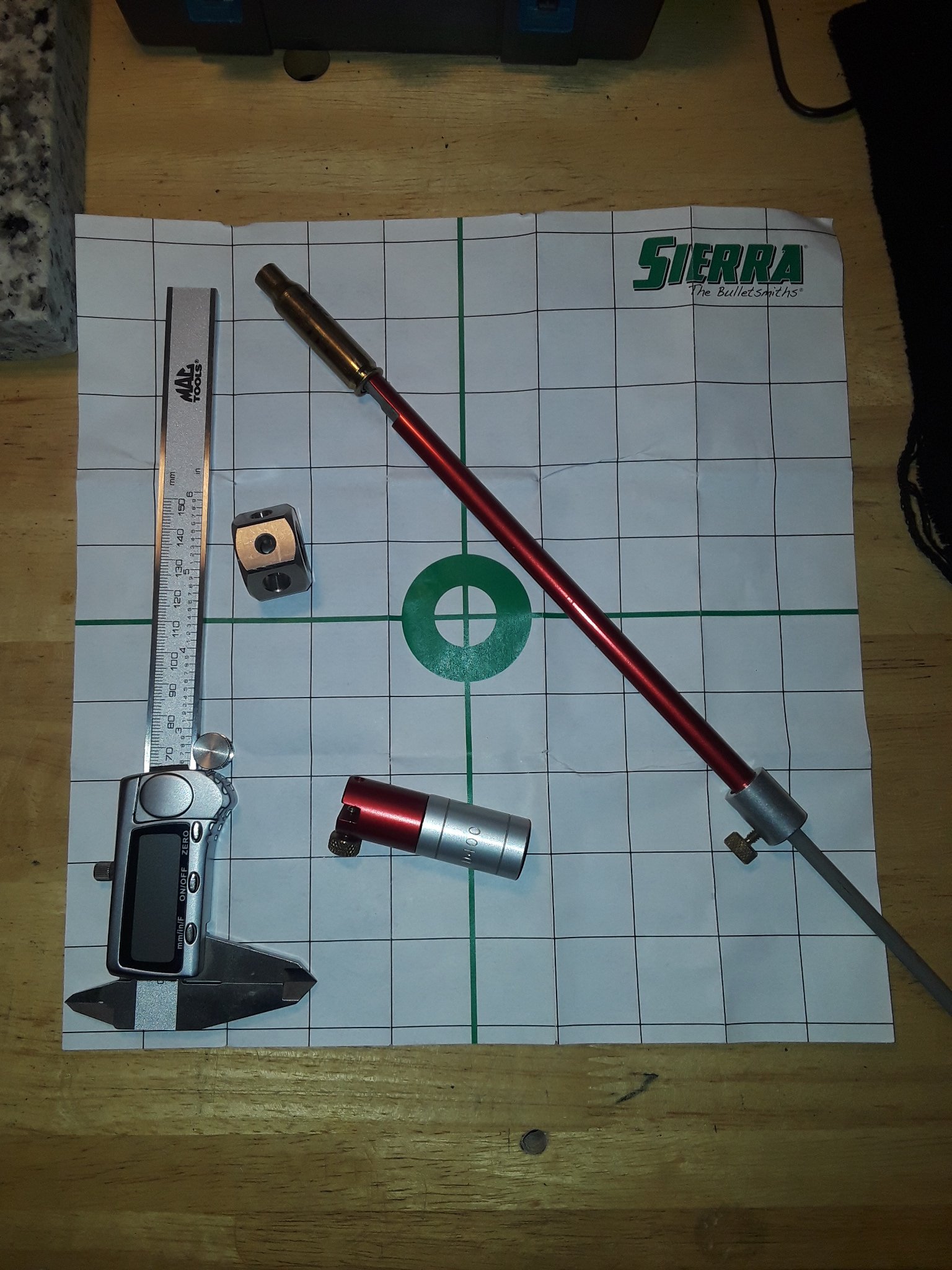

Sorry I never saw this post. I'm reviewing because I'm starting the process today.
I don't know about the head space in any but my CLE. Not sure what the best method for doing this is going to be.
Not exactly sure of your question.
I use a hornady gauge and modified case to find my lands.
A ? sinclair hex tool to measure to the ogive on bullets and cbto.
And a headspace comparitor that measures to the datum line on the cartridge shoulder.
Those tools are necessary to keep me out of trouble.
Oh and dear God don't call any of those tools gauges. The stasis will come out in force and make a contest of who can beat you up about it.
They are a comparitor not a calibrated gauge.
To compare head space use a fired round from that gun preferably with primer removed on a universal die that does not resize.

Oh yeah I have the tools and I know how and all. I meant "I'm not sure how to go about finding a load that will work in 3 different AR's ? "
I'm not sure where to start with this little endeavor. I guess I'm going to have to find the load with my CLR AR that shoots best, then see how it shoots in the other two....???

Brass measured as follows
Pistol Brass - #1 1.4640"
Pistol Brass - #2 1.4620"
Piston Rifle - #1 - 1.4625"
Piston Rifle - #2 - 1.4640"
CLE AR - #1 - 1.4605"
CLE AR - #2. - 1.4590"
So, a .005" possible spread between the 3 barrels. So I guess I could just size it all to 1.4600" and be good? That's what all of the Brass was sized at before firing already and wouldn't change anything in my set up.
So can you swap bolts to see if its a bolt problem or chamber issue.
That cle headspace is to tight for the rest. Several mfgs pull that crap trying to make their product look good with factory ammo.
It is without a doubt bullshit if you are a reloader.
1.4635-1464 is what the deal is.
I toss crap that doesn't conform.
You can get a new bolt or bcg. (From a different vendor)
Luapa brass for an ar, wow.
Screw Bob's. Last time I ordered from them (2019?) I got 2k bullets and there were no less than 6 distinctively different bullets mixed together. Not just slightly different, like with and without cannelure, a bunch of 54gr and a bunch of 58gr, you could eyeball measure and see that length varied about .2", completely different ogive and meplat shape, different boat tail entirely. Wish I still had the picture of all the different bullets I pulled out of a random 20. Bob's said that's fine, pound sand.
They also jacked up prices way before and way higher than anyone else.
I have not found a cull yet and just went through another thousand.
Is it possible we are talking about two different companies?
First of all they only make and sell 55g 223 bullets your choice of cannelure or none. I barely can find a 0.1g difference at all.
Sounds like you got some secondary market bullshit.
I won't be running lapua for the ars for thr duration, just for testing so I don't have to fool with anything while doing this.
How would I know if another bolt would work? This is also much further complicated by it being a lefty. You can't just run out and get a lefty bolt that easily. I do know where there piston rifle bolt came from and could try getting another one of those but how would I know it would work before firing it? I suppose I could get a reamer and take .003"- .004" too though right? Then I'd have them all right in the same spot.
Of course I guess the easiest thing to do would be to take the bolt out of the piston rifle and put it in the CLE and shoot it and see? Then I could order another lefty bolt from the same place and IF that bolt was the same it would work? Not sure how likely that is to be the same though?
Well the left hand option complicates things.
I only had one piston operated ar a sig. It was nice but not that accurate so off it went. I don't remember if the bolt would even interchange it's been a while.
All I remember Was I was the only kid on the block with a folding stock patroll rifle. LOL
Maybe if you contacted cle they could accommodate you?
90% of all the range pickup brass I measure is 1.4635 - 1.4640 the rest is wildly scattered but within specs.
Ammo mfg's undersized thier ammo to fit in anything, some gun mfg's tighten down thier chambers to show better off the shelf accuracy with it.
It just compounds the damn problem. A "0.0005" difference between go gauge on 223 and 5.56 is completely doable with a wylde barrel for all, but hell no that would not be fufu proprietary would it.

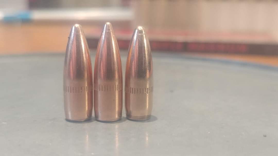

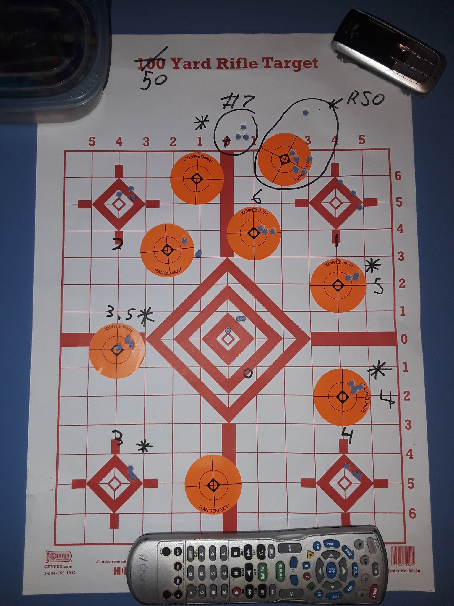

Absolutely the same Bob's. I found one picture of 3 bullets pulled from a random 5 in the email I sent them.
69 gr SMK.
LC 12 brass.
CCI 450 SRM primer.
AA 2015: 22.7 gr.
CBTO: 1.861"
Velocity: about 2510 fps (from my 16" barrel)
Rifle: DPMS Sportical 16" 1:9 (the rock bottom cheapest rifle I could find at the time) with a Sightmark Wraith digital scope. (Horrible resolution on a 3/4" price tag dot @ 100)
Sitting on a wobbly Caldwell Stable Table Lite. Front bag rest wasn't quite high enough so rifle was rocking on the bottom of the mag... Pictured group was the first 3 shots to zero the scope...
The other 17 shots (same load) tried to stay as tight... But as the barrel heated up they wandered a bit. Stayed inside a 2" target dot despite my worst efforts... Someone with a nice quality rifle/glass and a stable setup might be able to make this load really shine.
When I tested this load before, the velocity only changed 3 fps from 22.6 to 22.8... so there's definitely a node in there.
