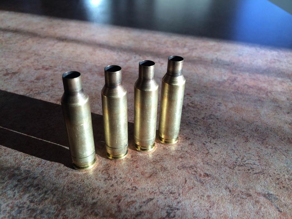

This happened at the match this weekend.
Not sure why yet. May be a different powder lot, may be the brass was shot.
It was in the middle of a match and I went to a new box of ammo, recently loaded, and the 6th shot on the stage did the above. The other cases were partially split at the web and one of them had a blown primer. I load in lots of 50, so this was a whole lot. I don't know if it's because of a different powder lot or just worn out brass. The blown and flatten primers indicate over pressure. I took 5 cartridges apart and I check for signs of head separation in the loaded, un-fired pieces. They are fine.
I do know after about the 3rd reloading the brass is growing about .006"-.010" and I have also seen the web moving because the a primer pocket uniformer will cut in the primer pocket after every firing.
I'm thinking a different lot of powder. I have 1 bottle for a different lot that I was loading from, the everything else I have is from the same lot. I'm going to unload all those pieces in that box of 50 and check them all. I have other boxes of 50 and I will check those out too. Will probably have to do some test firings.

A different powder lot won't cause case head separations. Might cause flat primers from more pressure but that is from oversizing your brass. Do you measure it?
Well, I got some thinning to do.
1. I'm sizing the brass just as I have for 1500 rounds with no problems until now. I size it by removing the firing pin and ejector and turning the die down until the bolt falls free.
2. The brass from the lot that separated passes the paperclip test.
3. The one thing that changed is the powder lot.

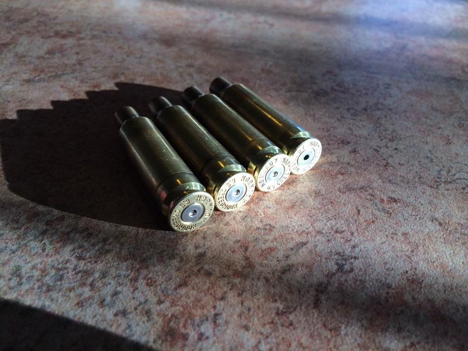

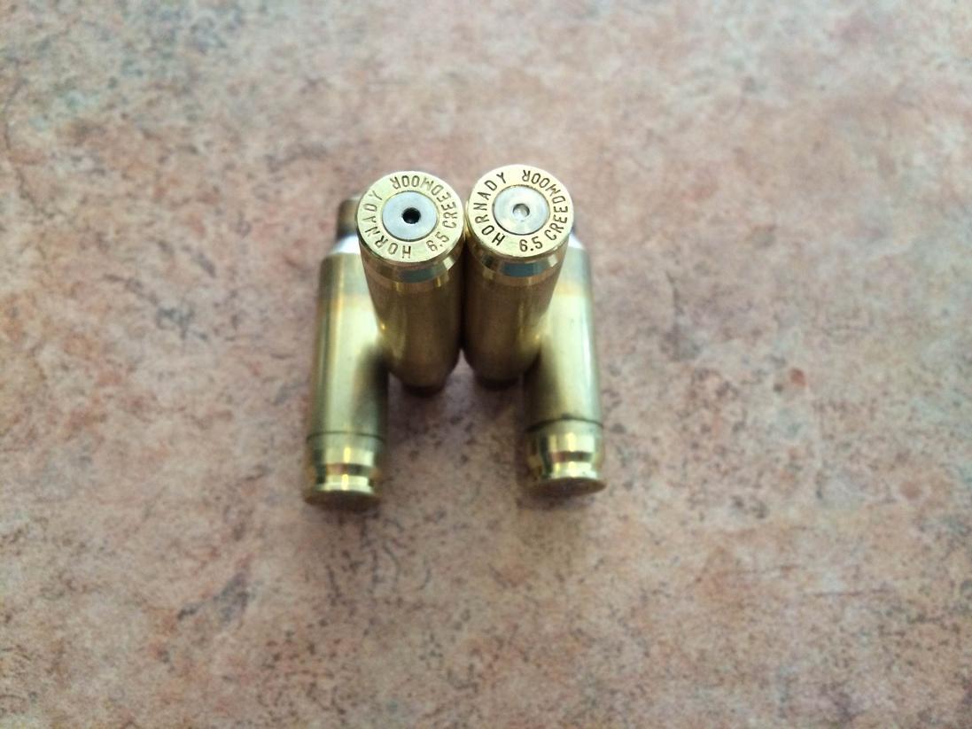

Top is the piece that separated.
Next is a piece of brass I reloaded at random from the above lot with a different lot of powder at 41.5 from another lot. - normal load is 42.6 with 140s.
3rd is a new piece of brass, 1st firing, loaded from the same lot first.
Last is a piece of brass on it's 2nd firing loaded from the same lot as the first
All of them have case head separation signs.
After I had the issue at the match I went back to an older batch of ammo (left over from the Grind) and it has not problems.
Next I'll put up pics showing the primers.
It doesn't happen right away. After multiple loadings you are stretching the brass at the separation point by sizing it too much. Sizing down and then it stretches in your chamber, which might be a little long to exasperate the point. Is it a factory Creedmoor rife or custom?
If you don't measure how much you are sizing down then you need to start to see what you are doing. You can think it's the powder if you like but it's not.

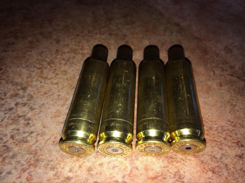

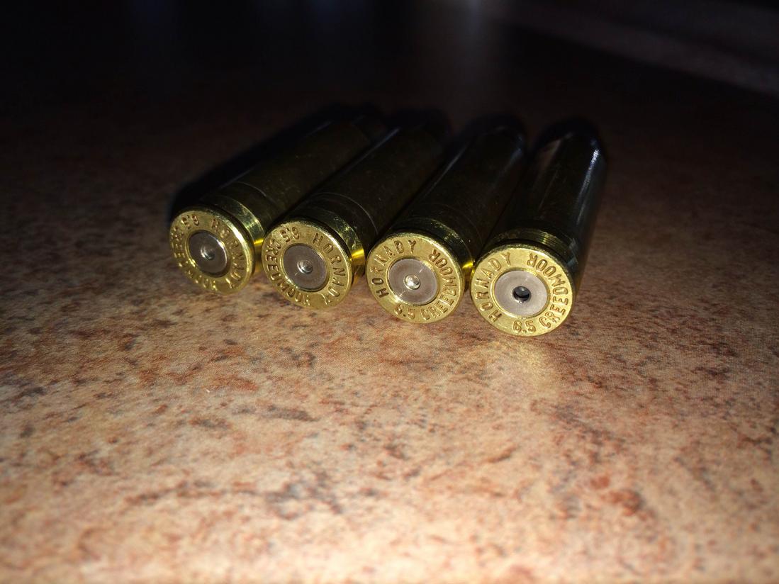

These are the primers from ammo I've had no issue with.
These are the primers from the problem rounds
I think what I'm going to do at this point is start over with new brass and do load development and see where it ends up. If I have to I will cull all the brass in question. Checking the chamber now to make sure it's still ok.
