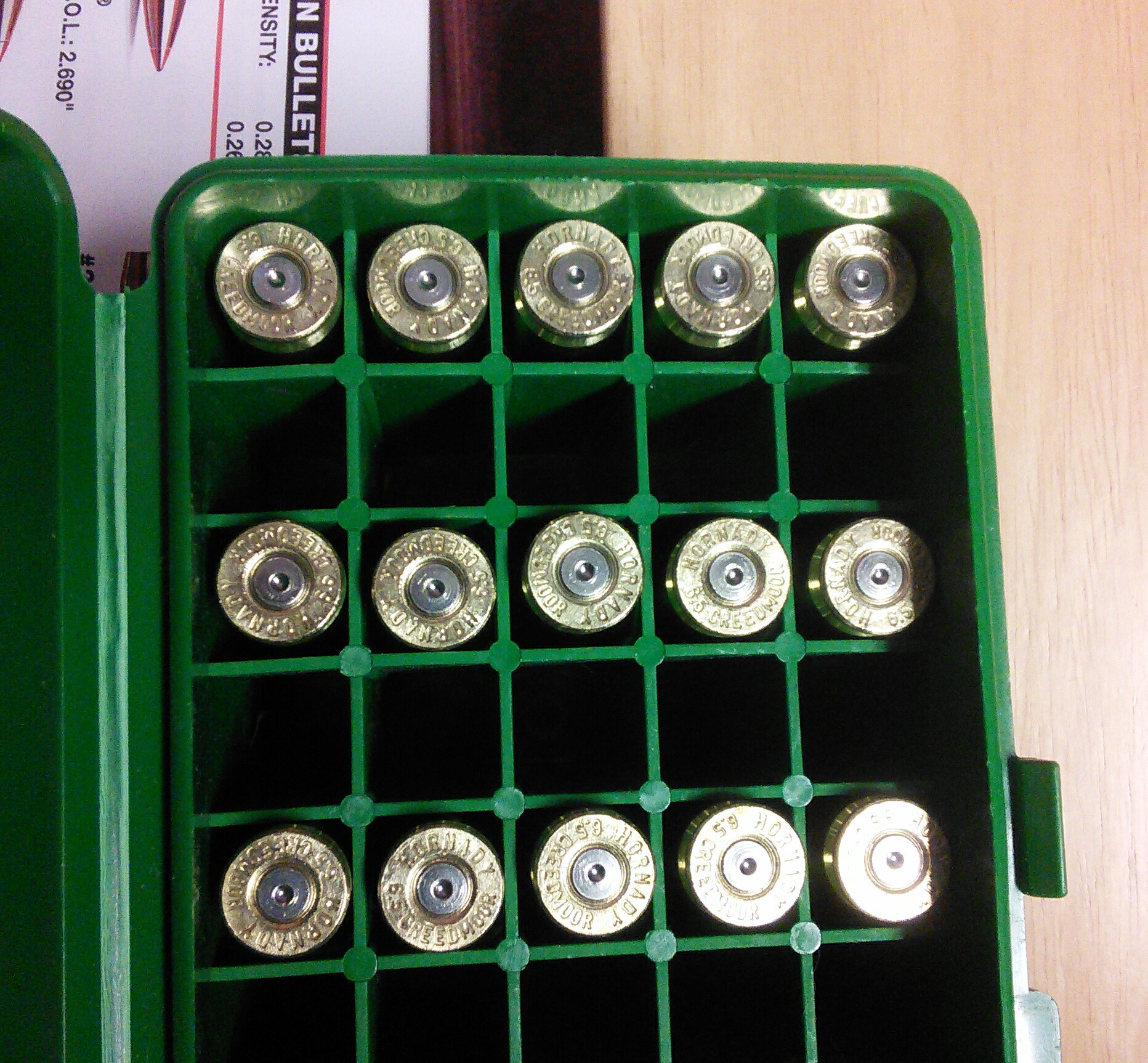

I purchased this two times fired brass from a fellow hider ,Curious if anyone else is seeing unusually quick loose primer pockets in the Hornady brass. My load is 42.6 gr of 4350 and shows no signs of pressure. However after only 2 loadings, primers seat with out any resistance. A couple of other local shooters are also seeing this.
I've got 5 firings and primer pockets are good.I purchased this two times fired brass from a fellow hider ,
and in the process of priming the already formed cases
the primer was going in so easy that it felt like there was no primer at all
There was no resistance at all from the primer pocket![]()

Very interesting…..I'm seriously concerned that I am going to have to start culling brass after only a few firings. I was so impressed with the Hornady brass until this issue. Shot with a couple of other Creedmoor shooters this morning and they are witnessing the same thing. On a brighter note…..man of all the calibers I have had…this Creedmoor is an absolute hammer. Love this thing!!!!
Tell you what will help, TULA Russian primers are ever so slightly tighter than BR2s, might give that a try, I got 5K from Natchez.

I am curious,what kind of primers are the guys using that are reporting loose primer pockets?I am asking this because I changed last week from Fed210M to CCI and experienced the same thing on 2x fired brass.Never had this problem with the Feds.With the CCI primers some are loose and some not.I contacted CCI and they ask me if I use a primer pocket uniformer and if I did to stop,which I don't anyway.My load is.
42.3 GRS H4350
140 Amax
COAL 2.800
Going back to FED primers
CCI is suppose to get back to me this week on this lot# of primers.
