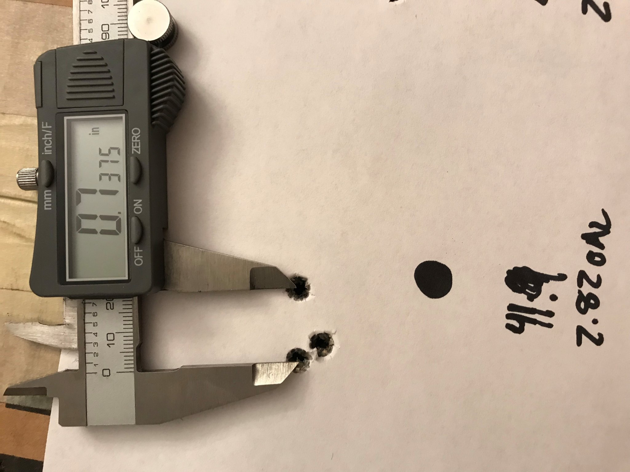

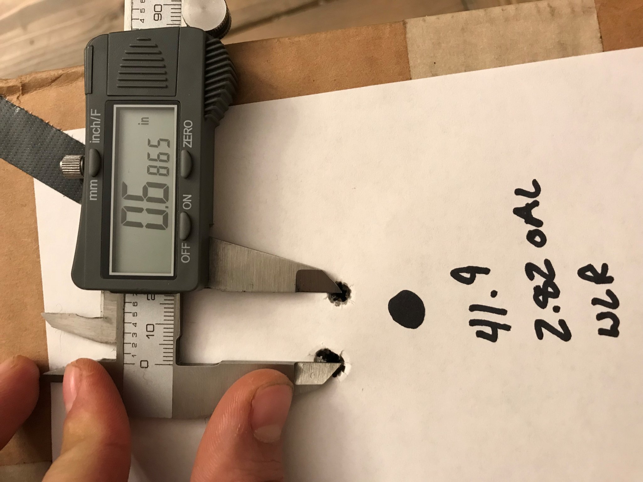

I'm trying to hunt down a problem/inconsistency with my loads. With 3 shot groups, I am consistently shooting 2 shots touching and one flyer about .5"-.75" off. I shot 2 groups back to back with the same load and they looked almost identical. Same thing when I messed with seating depth a little, different point of impact but still 2 touching and 1 flyer. All Hornady brass fired 1x, cases are tumbled, sized, primer pockets cleaned, flash holes uniformed, and seated to 2.820 OAL. I tried 2.850 OAL and still had two touching and one flyer. These are loaded at 41.9 gr H4350 which is right in the middle of a node. I would say its just me doing some poor shooting but the fact that it has happened almost identically like 6 times makes me think it can't be just a coincidence. Tonight I am going to weigh the empty cases and sort by weight and see if case inconsistency could be the cause. Anyone have any other suggestions that I may just be overlooking? I hate to give up on this charge weight because if i could eliminate that flyer then it would be a sweet load.
By the way, the flyers aren't happening every first shot or last shot or anything, it seems to be at random, and I am letting the barrel cool every 4 or 5 shots.
Are you using Nosler RDF's by any chance?

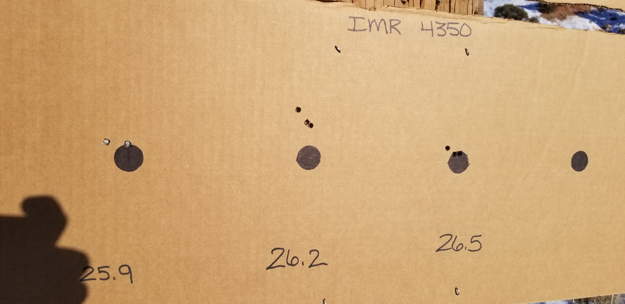

Grouped 3 different charges today, 44, 44.4, and 44.8gr. None of them showed me anything special, grouping about .8” for five shots. Extreme spreads weren’t great either, running about 37fps. I’m going to load some up and see how they do at long range just for grins.

.4 and .5 charge difference leave a lot on the table. I would shoot for .2-.3 charge spreads for testing.
