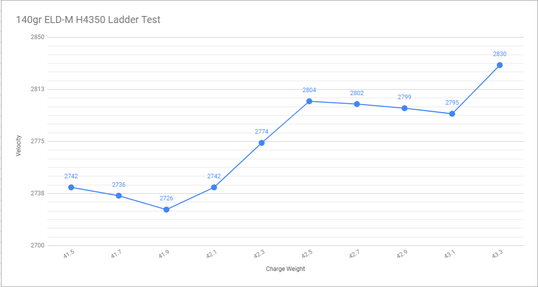

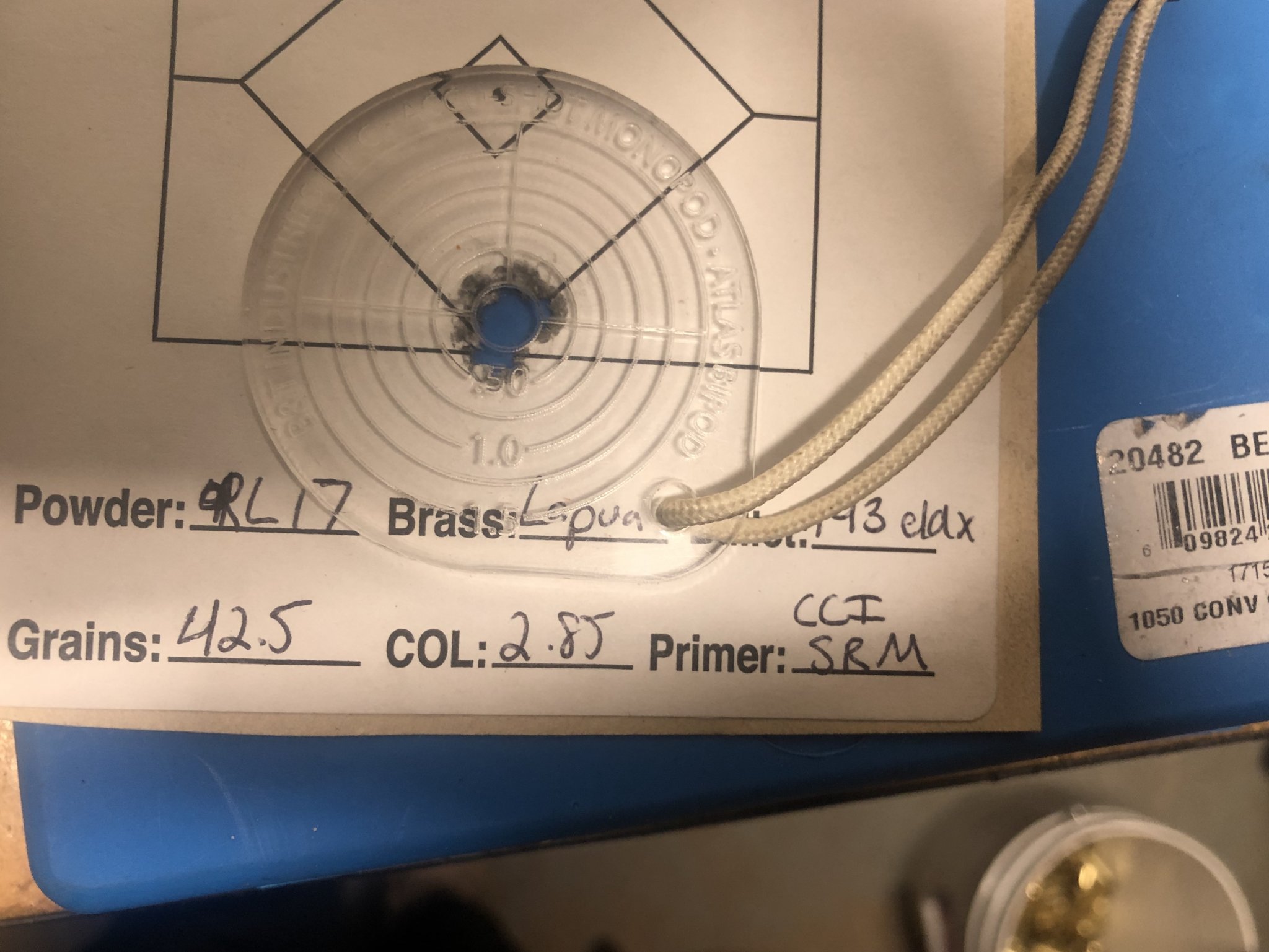

I am pretty new to reloading for precision and am hoping for some input. Just got my magnetospeed chrony in the mail this afternoon. I already had my ladder test loaded up and waiting for it. I was going for a “Satterlee type” load development test just to see what kind of results I could come up with. Also to find the max charge weight that my rifle can safely handle, a Bergara B14 HMR, 22” barrel. I started my load at 41.0 gr of H4350 and loaded up to 44.0 gr in .2 gr increments, not really expecting to make it all the way to 44.0 gr before running into pressure signs. I ended up cutting it off at 42.8 gr due to faint ejector marks. You can only see the marks if the light hits it just right. I was hoping you guys could help me interpret my results and also tell me if I am right for cutting it off there.
143 gr ELD-X
H4350 41.0-42.8 gr
Fed 210 primers
2.875 OAL
41.0 - 2645
41.2 - 2662
41.4 - 2663
41.6 - 2678
41.8 - 2702
42.0 - 2706
42.2 - 2726

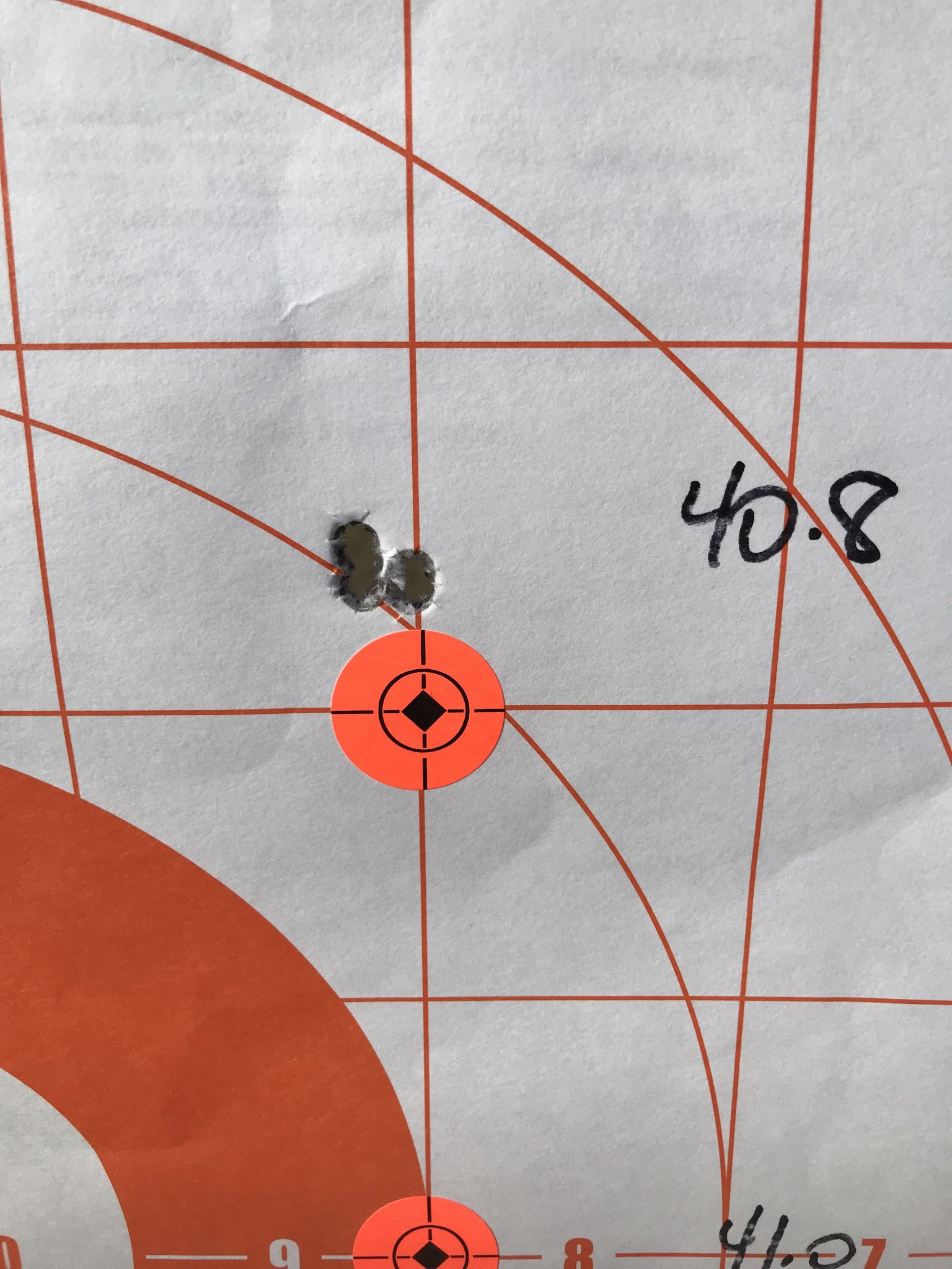

I see a pretty obvious node at 41.3 but I really would like a little more velocity than that. I am thinking that 41.9 might be good or possibly 42.3. I had primer cratering throughout, even on the factory loaded 143 gr ELD-X which got me 2579 FPS. (Pic attached) I ran it through first to make sure the chronograph was working. I also noticed what seems to be some primer flattening even at 41.0 but it did not seem to get worse up to 42.8 where I stopped. The second pic attached it the 42.8 gr case. What do you think?E12D5D50-8C07-44F7-99B1-BBE3A8EEFBA7.pngFactory 143gr ELD-X17F68D5E-03DB-4FA7-9D02-A9AD520014AD.png143 gr ELD-X w/ 42.8 gr H4350

42.3gr is your upper node. If you want more velocity with that barrel length you’ll have to try RL16 and see what that does for you.

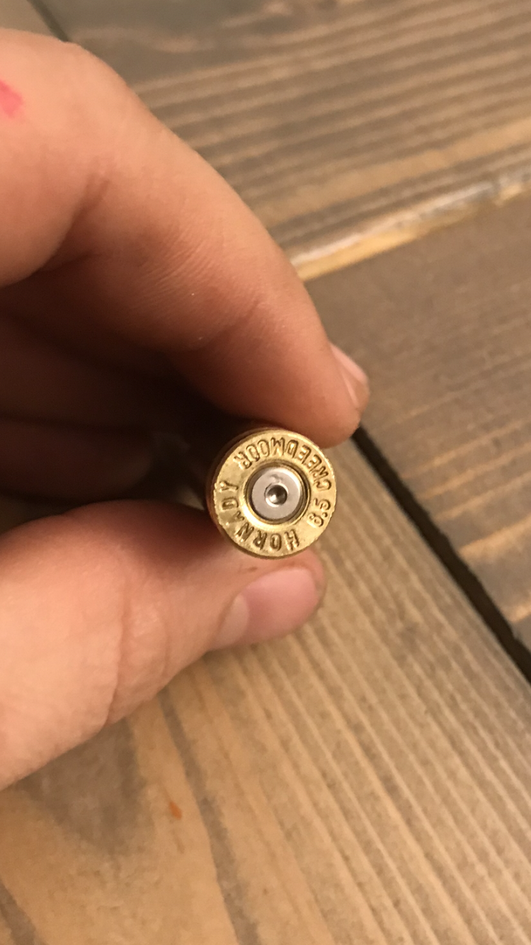

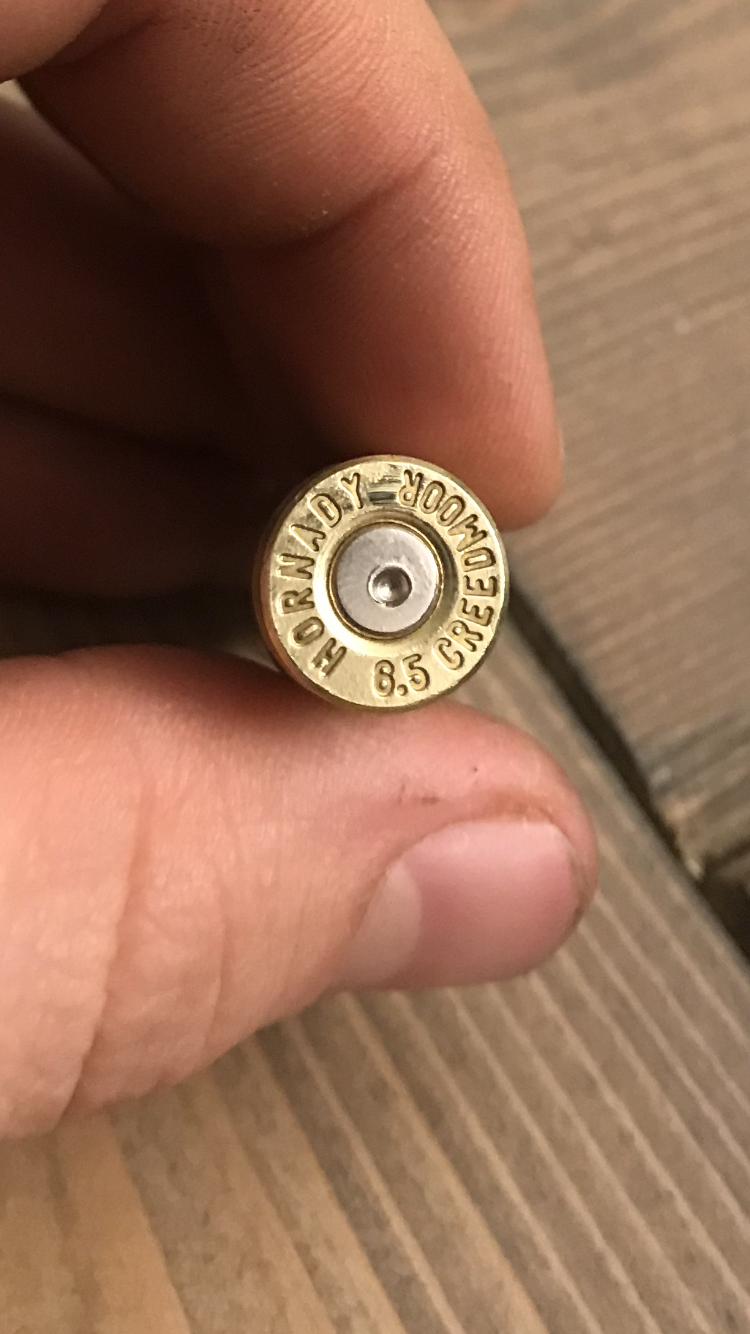

OK, what the heck is going on here? I loaded up a ladder of H4350 under some 147gr ELD-M's in Hornady brass, using a FGGM primer. Why are my velocities so low?
Getting up towards the top, I noticed some slight cratering around the primers, but no ejector wipes or anything of that sort. I was using a Magnetospeed V3, shooting through my can. Last time I was out shooting these loads, I was seeing velocities in the 2670fps range from 40 or so grains of the same powder out of the same jug..
Im so confused.
Im so confused.

What barrel length? Also, what chrono are you using? Is the Chrono proven reliable or calibrated? Confirmed with dope?
Hmm, I'm getting 2830 fps with 42.3 grains of H4350 (Hornady brass/147's) from a 24" Bartlein. Peterson brass requires only 42 grains for the same. That has to be a bad chrono or super slow barrel.

41gr RL16
CCI 200 primer
COL 2.815"
Averaging 2748fps in below freezing temperatures.
Alpha brass has significantly less capacity than Hornady. I went up to 42.2gr and got over 2800fps, but worried about pressure signs in the summertime 90's temps. OT was also starting to crunch powder at 40.5gr.
Overall I'm very happy with the brass. SD's dropped to under 10 immediately, and accuracy went up. Hoping to get way more reloads as well.
