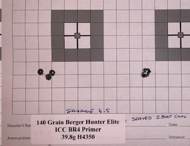

I'm pretty new to this but been working on a hunting load for my Savage 110 Desert Tactical in 6.5 Creed. Found a happy spot yesterday so thought I would share. Maybe it's of some help to someone else. Both of these are 3 shot groups with the same charge at 100 yards (0.5" grid target).
These are seated at .020 off.
140g Berger Hunter Elite / BR4 Primers / 39.8g H4350
Using Redding Type S (full length) competition die set with .289 bushing
Reactions: SLAYIN'SWEDE
What is your barrel length and what kind of velocities are you getting from that 39.8 of H4350?

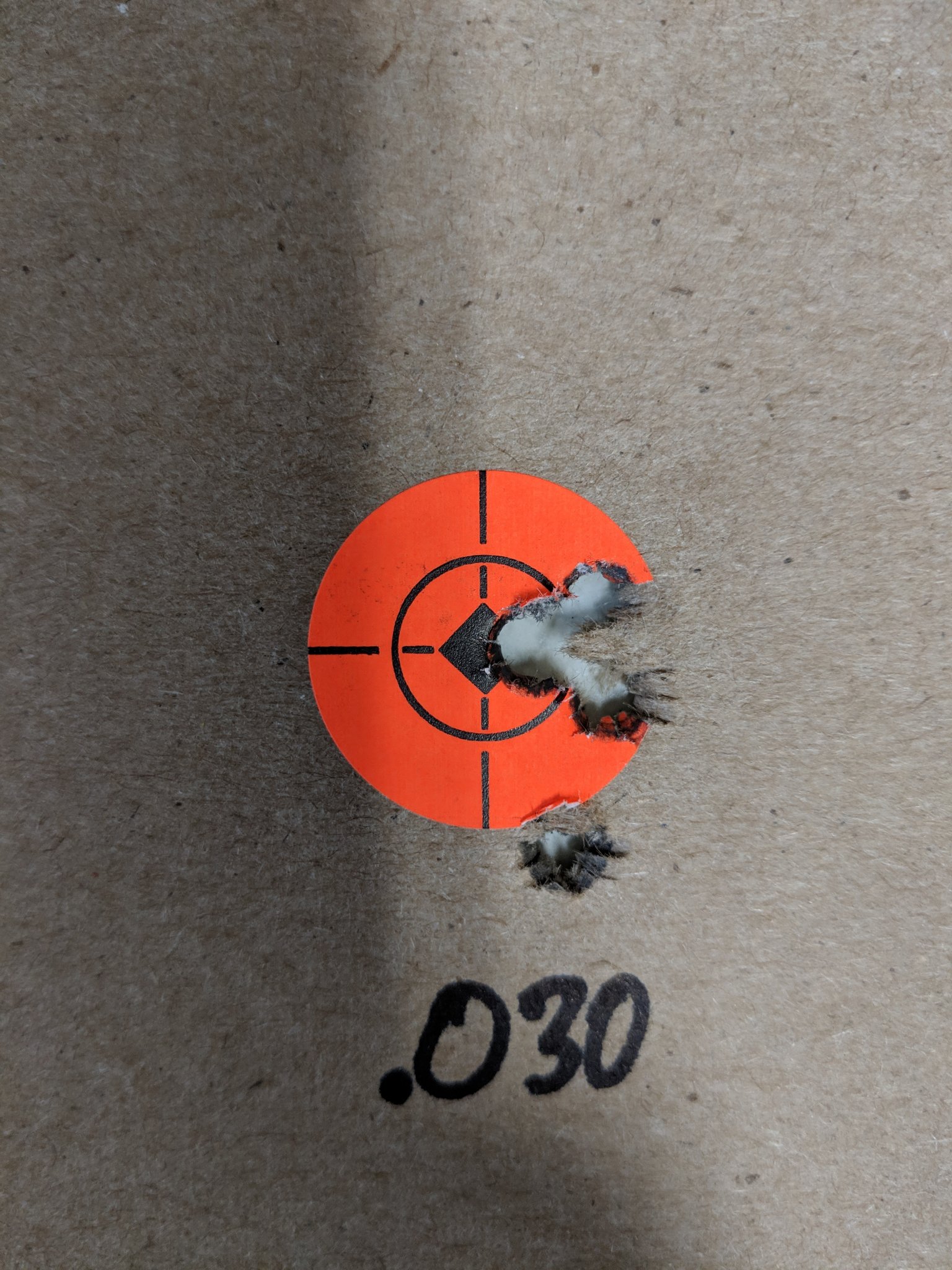

Ended up settling on this
Lapua Brass
CCI-450 Primers
41.6gr R16
147gr ELDM .030 off Riflings
Only getting about 2675 fps from my Tikka 24" barrel, could be a tad higher maybe but I am happy with the groups I am getting. I have repeated multiple groups like the one above with this load.

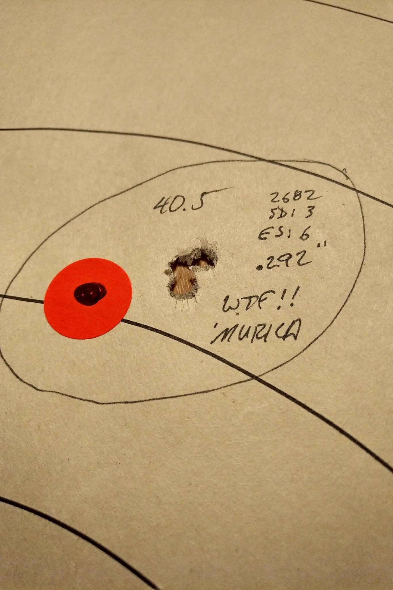

PURPOSE: Duplicate a factory load velocity for the Hornady 147g ELD Match Bullet with tighter SD/ES. Per magnetospeed it was traveling at only 2600, SD 16, ES 35.
Brass: Prime 6.5 Creedmoor
Primer: Federal GM210M (Large Rifle Match)
Bullet: Hornady 147g ELD Match
COAL: 2.825 (.025" off the lands)
Neck Tension: .003"
Dies: Lee Precision FL sizing die, Collet Neck sizing die, Dead Length seating die.
Process: deprime (Lee Classic Turret Press), tumble, clean, full length size (Lee Classic Turret Press), trim, anneal (salt bath), avoid burning fingers, drop in water, tumble dry, clean, neck size, final prep (chamfer, etc), prime on press (Lee Classic Cast Press), charge with powder, seat bullet (Lee Classic Cast Press)
Rifle: Ruger Precision Rifle
Barrel: Proof Research stainless, M24 Profile, 24", 1:8 twist. Headspace set to SAAMI Minimum +.003" per Proof Research recommendation.
Brake: APA Little Bastard - Jam nut style.
Location: Burro Canyon, Azusa, CA (1 hour drive from my residence thanks to traffic on the westbound 210 freeway!)
Position: Bench with bipod and rear bag.
Time: 1404 hours (2:04 PM)
Conditions via Kestrel: Temp: 65f, Baro: 27.94 inHg, Humidity: 23%, Density Altitude: 2750
WIND: from 10-11 o'clock, 1/2-3/4 value, variable 5-15 MPH (enough to make my target flop around a bit, made it spicy!)
Distance: 101.3 yards via laser rangefinder.
Chronograph: Magnetospeed Sporter
Load #1:
Powder:
Reloder 17: 40.5 grains
Velocity: 2682
SD: 3
ES: 6
Group size: .292" Center to center:
Load #2:
Powder H4350 41.4 grains
Velocity: 2701
SD: 5
ES: 13
5 shots
Forgot picture, sorry. It was similar sized hole, no larger than .4" Center to center probably thanks to the wind moving my target around. ???
Outcome: SUCCESS!! ? This is the best load development result series I have ever done since I started reloading about a decade ago!! I am so relieved I can now just load a bunch of either one of these loads and let it rip!
