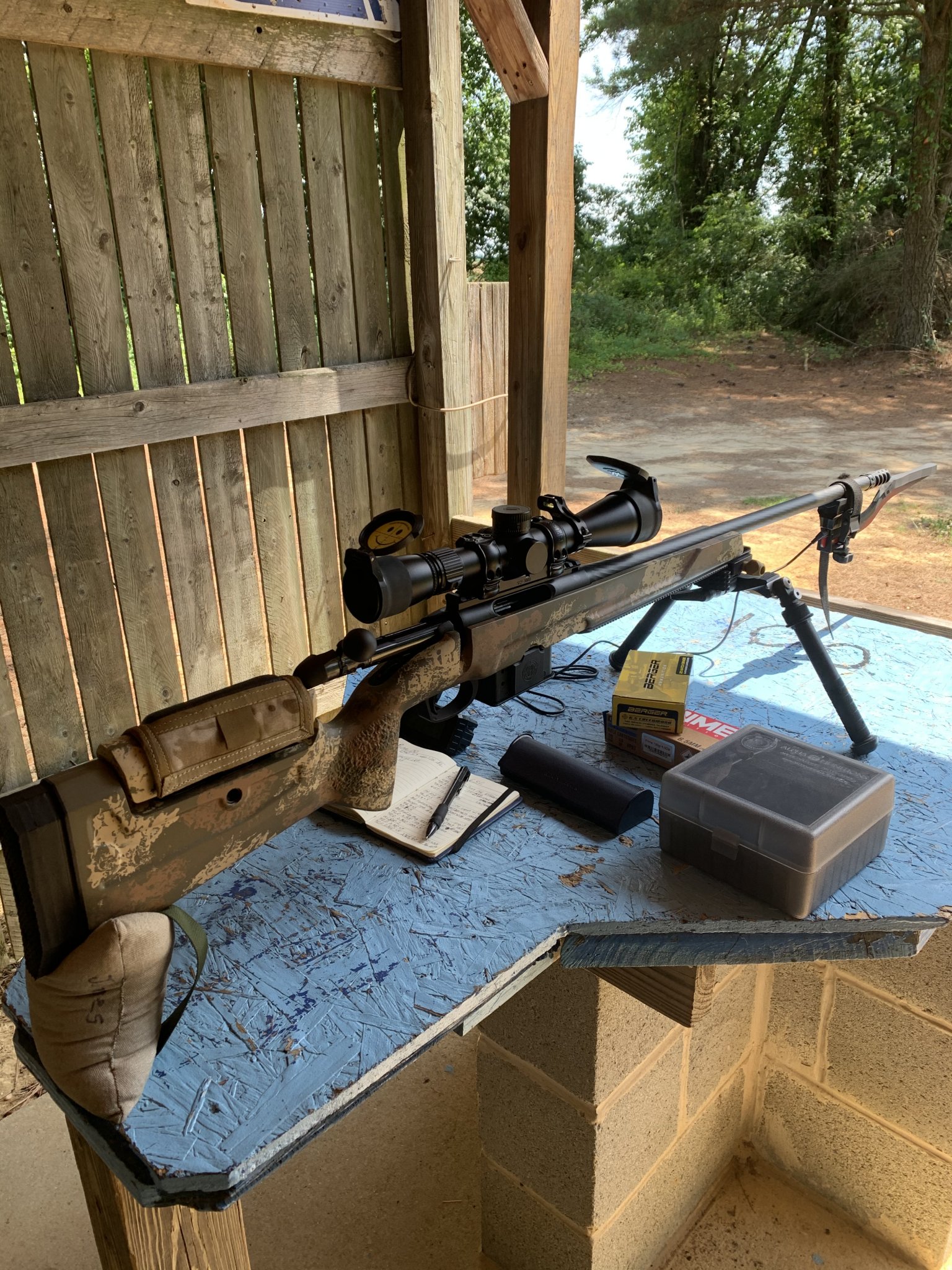

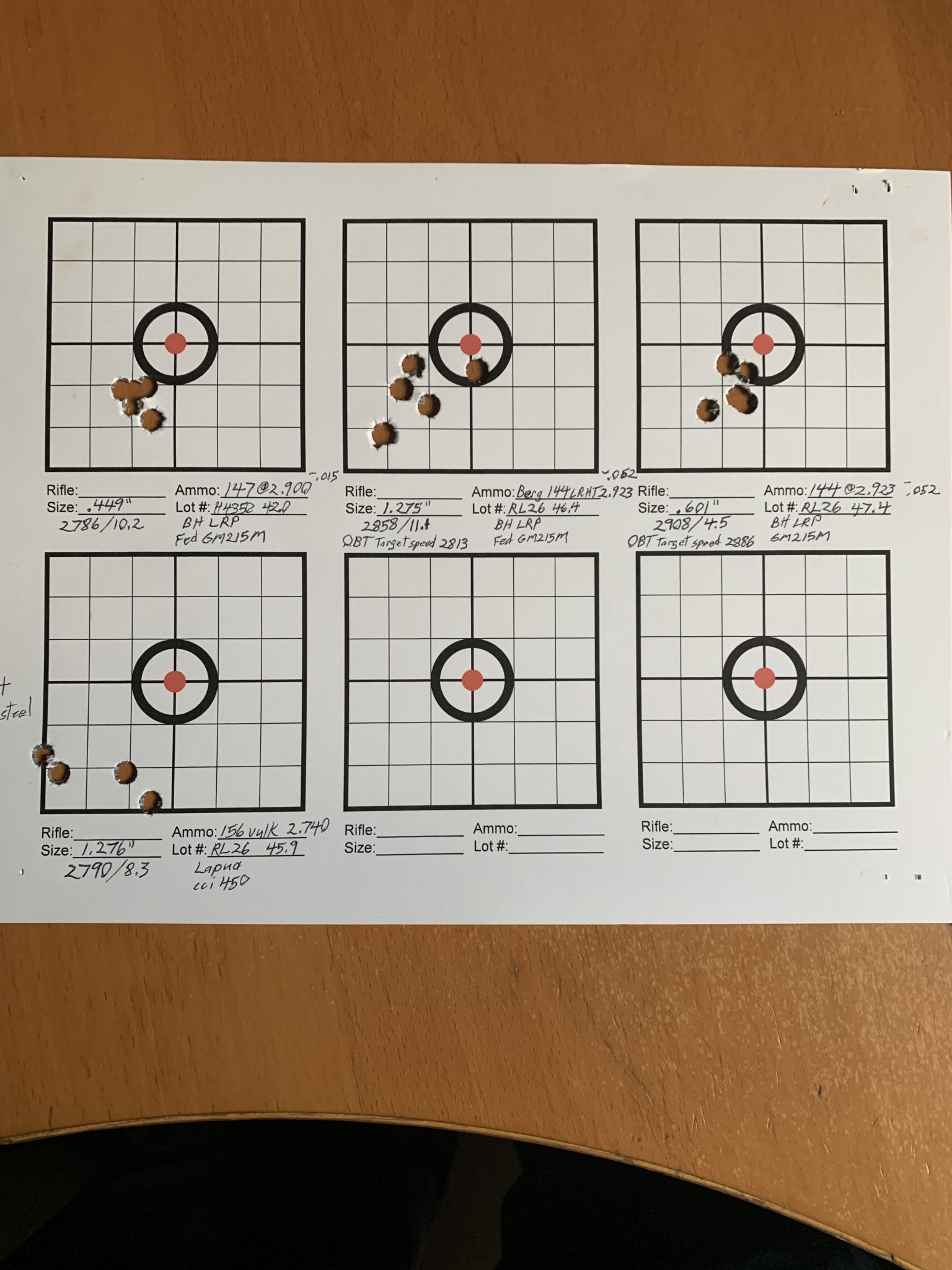

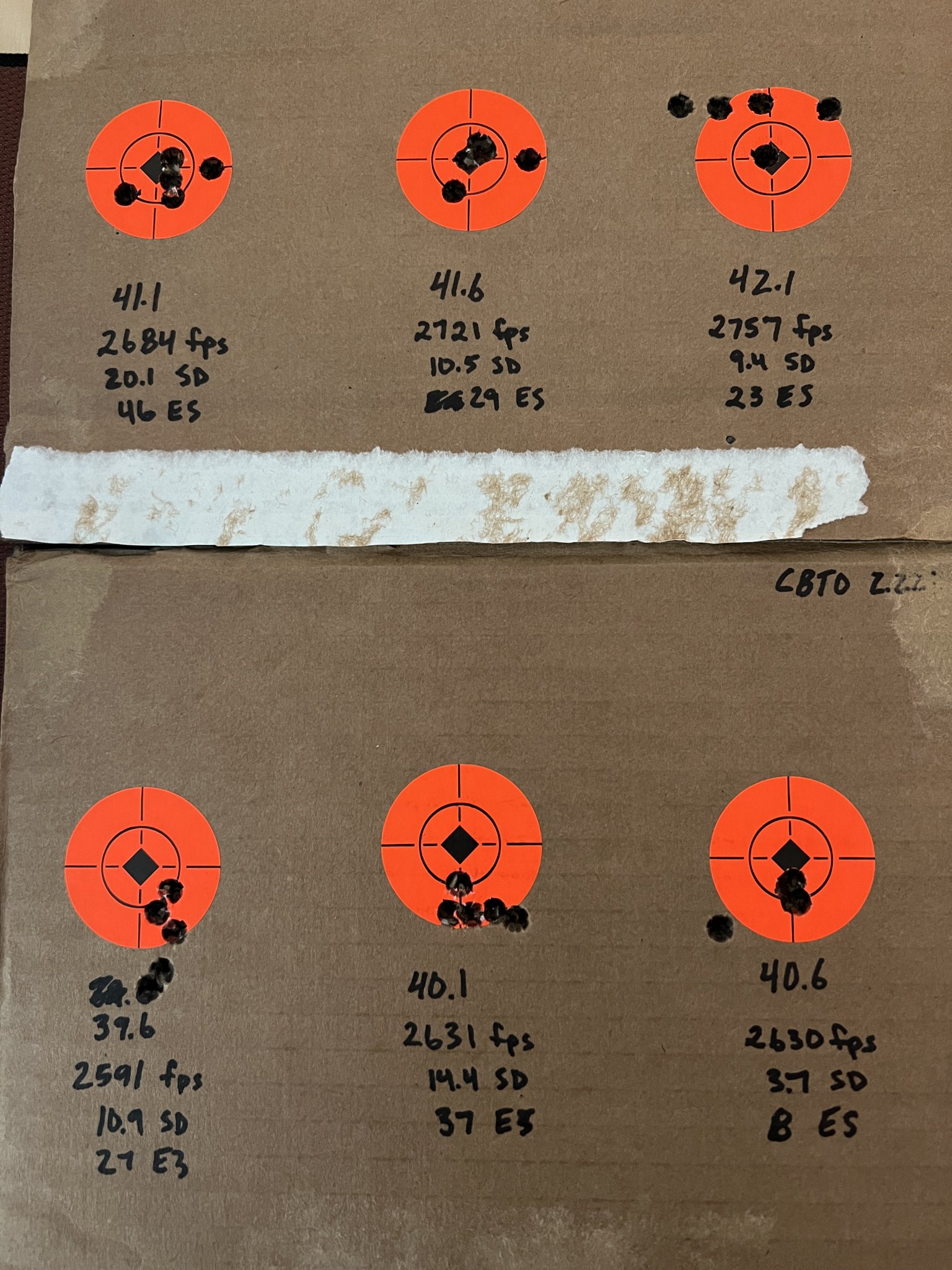

Don't be too hard on me...but got time today to shoot my very first handloads and first rounds through this rifle.
MPA PMR Pro 2 chambered in 6.5CM 26" barrel. First thing I know I should have tracked is I had to pull some bullets and used the cases again without marking them. I know the neck tension was totally different and is what probably caused the poor ES and SD with most of my velocity testing.
I don't think I had a single "clean" group where I didn't pull a shot. The 39.6gr group was a total screw up as I pulled the trigger before I actually wanted to and then pulled another.
I was .020 off the lands with these rounds, will play with that some and try to find a good charge around 41.6-41.9. Any suggestions/comments welcome!
H4350
140 ELDM
CCI 450s

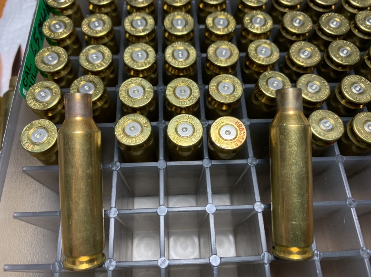

Unfired Lapua brass, only set neck tension with a black nitride 21st mandrel. It should be about .263 diameter.
Used an Atlas CAL bipod. Plan on using a sled next time. I need a better rear bag for more stability. My Cole-Tac one I have now is too small.

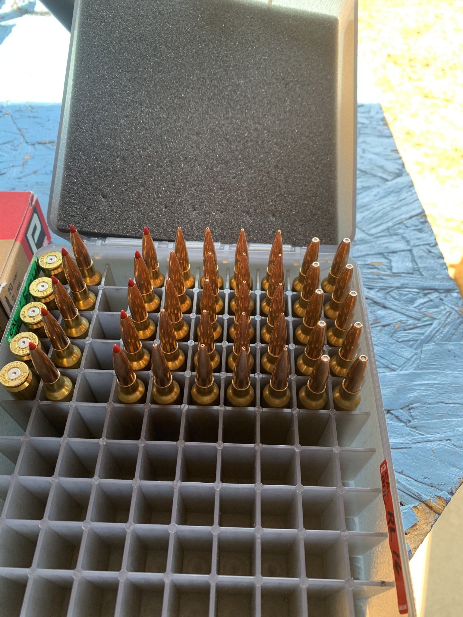

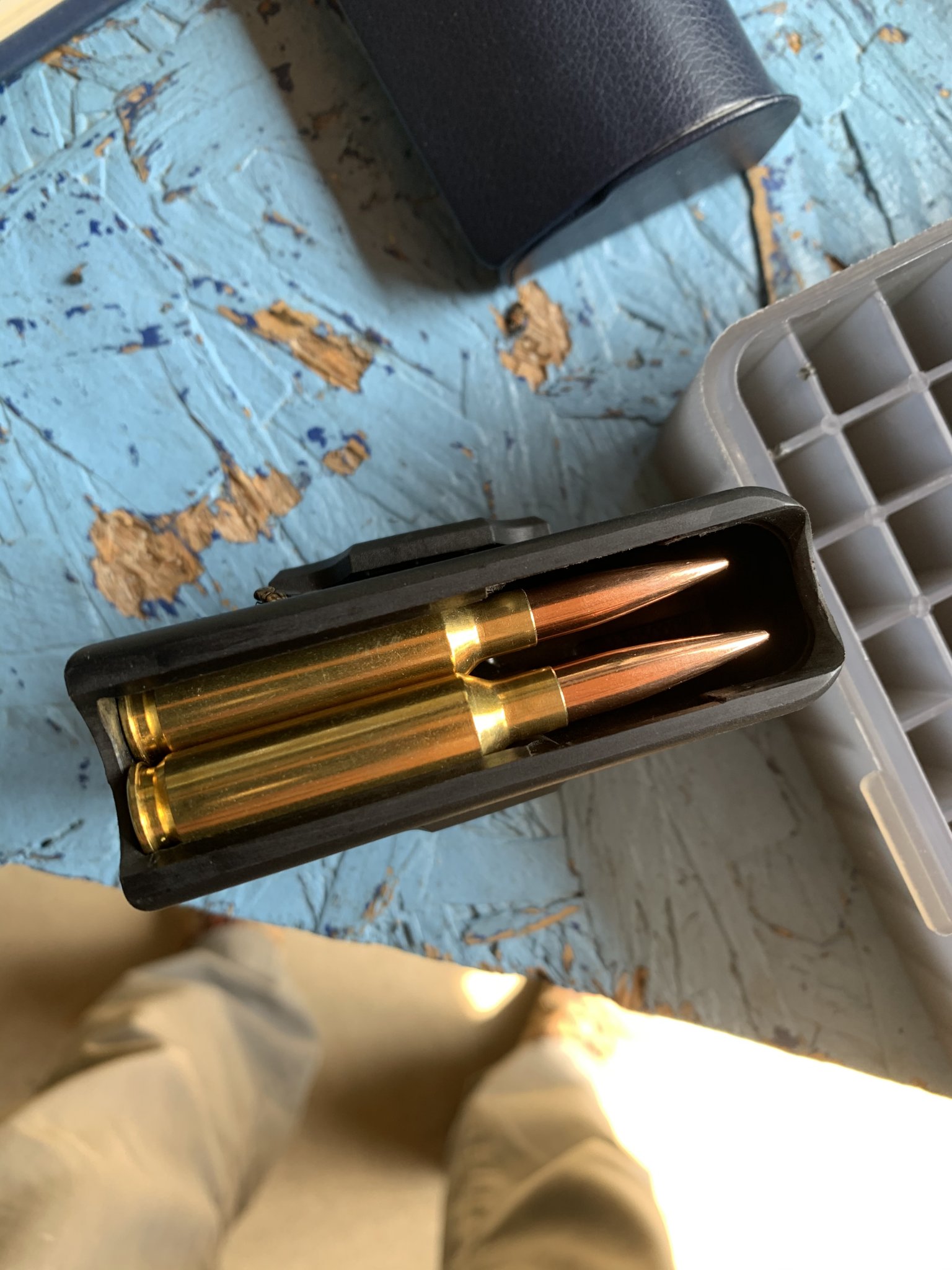

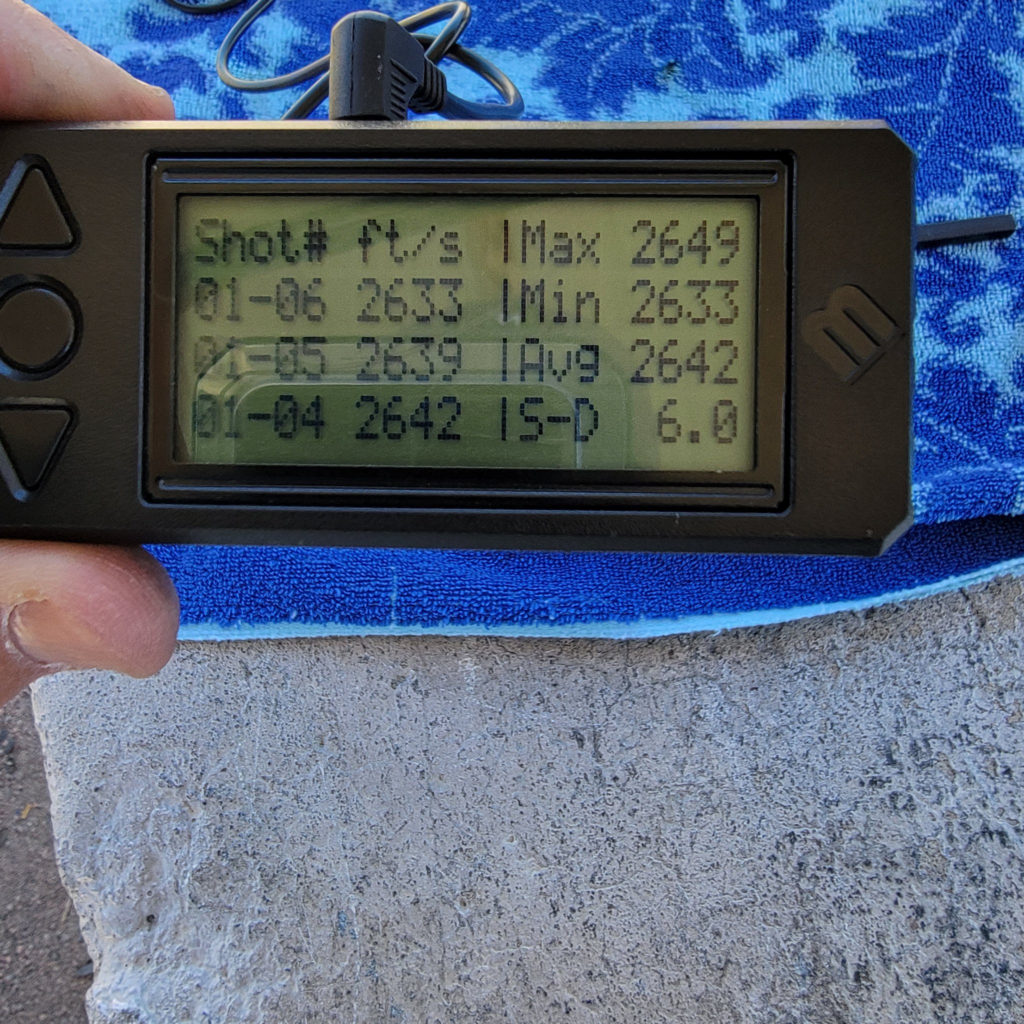

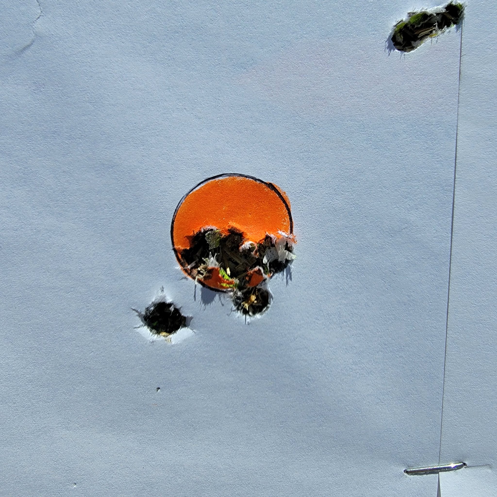

Finally got my 6.5 cm loaded and shot. 147 eldm with h4350 alpha brass virgin with tight neck tension 4 tho I usually run 2 or 3.
Loaded h4350 40 grains
Length is 20 off the oal of mag. The last shot I think was me but the cluster is 6 shots. I had other loads that shot good but very slow. I think I need to test 41.5. 41 was decent

Provide more specifics if you want useful suggestions. What Powder? Bullet? Brass? Primer? Bi-pod? Loading process?
Hand loading is a fun And deep rabbit hole to go down. Steep learning curve & specifics matter especially when looking for suggestions.

+150 over the factory load is asking a lot. Work up with the H4350, but 2725 should be doable. RL16 would likley get you +40-50 over the H4350.
Pretty sure Hornady uses single point cut rifled SS barrels for their pressure testing. Pushing past that with a hammer forged or known slow barrel is certain to push pressure past Saami max.
Reactions: lb6r
Thanks. Updated.
With new Brass I do the same/similar. Od/id chamfer and run a 21st century mandrel through the neck (.2625).
Something important to be mindful of is that your new barrel will speed up somewhere around 80-120rnds.
I’d just pick a safe load like 41.2 -.055 from lands and load a 100.
Enjoy your new rifle with those, get it adjusted to fit you & balance. Try different shooting positions to gauge best adjustment & work on fundamentals.
Then once barrel is sped up & you have fire formed brass you can get down to finding a good load.

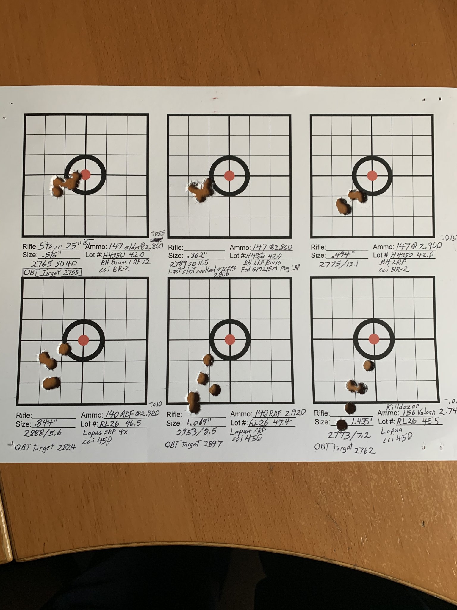

Finally dug the Steyr THB 6.5 Creedmoor 25” barrel out of the safe to try first hand loads.
This was the first “precision bolt gun” I bought. It’s funny at the time I thought this was a heavy pig, but after neglecting it for a few years, it seems light. Decided this will be my Hunting set up for WV. Put a 19oz Vortex Razor LHT 3-15 on it & its 12.5 lbs.
For a hammer forged & nitrited barrel it’s not slow like the Tika’s or RPR’s.
Ran a few factory loads on the clean barrel just to see how they compared for speed against my 25” Rock Creek barrel. Prime 130 was 2740 & will shoot 3/4”. Berger 140 was 2795, but it doesn’t shoot very well, 1.25”ish.
The CIP chamber on the Steyr has about .050 more free bore then the Rock Creek (PVA chambered). Plenty of room in the mag.
First up I tried 147eldm. 4 loads all with the same Black Hills LRP Brass. Brass was annealed, FL sized with Redding type S & mandreled with 21st Century .2625. All 4 loads were 42.0gr H4350. Checking primers & jump. Barrel just likes these 147’s
Berger 144 LRHT @2.923 (.052 jump) RL -26 & same Black Hills Brass. The Steyr has a big ol plunger type ejector & I wanted to see if the RL-26 showed pressure vs the ARC action that hides pressure signs. Did not see any & high load showed promise. Will try another ladder around the high load.
140 RDF’s I tried .010 jump. Didn’t like it.
156 Vulcan Killdozers. These are really what I want to find a load for. .010 jump sucked. I’ll try these with .060 jump and see what happens.
Specific load info is on the target pics. It was shot top left - right.
Barrel was pretty toasty.

Good info thanks
