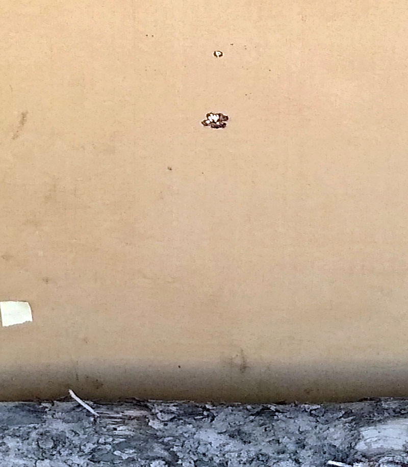

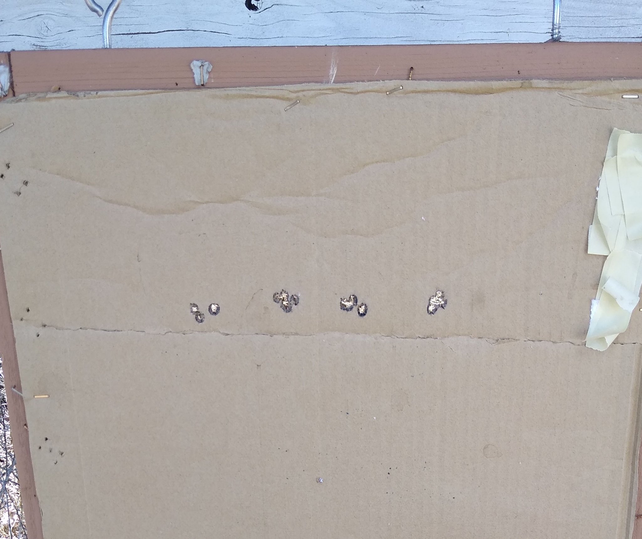

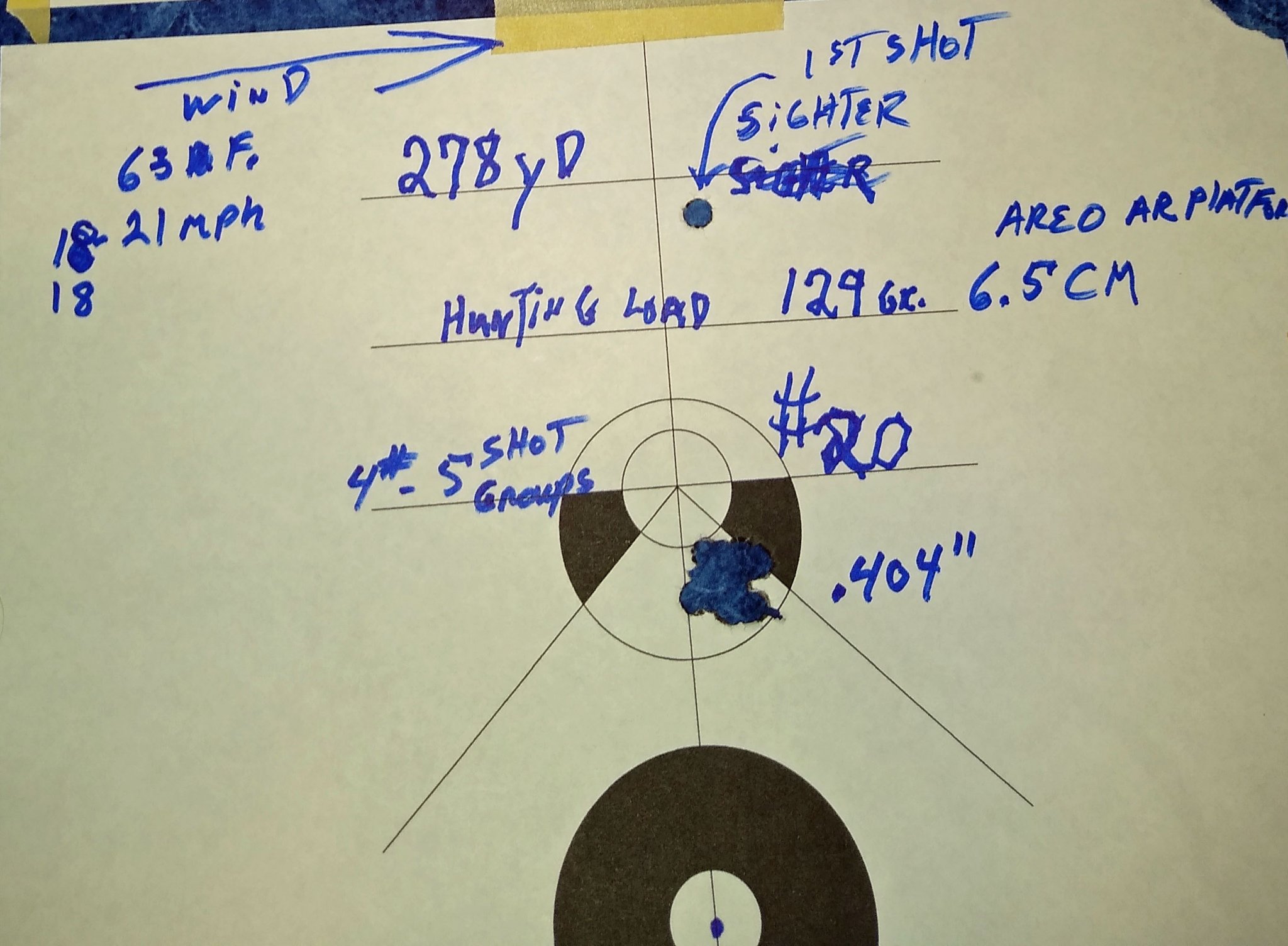

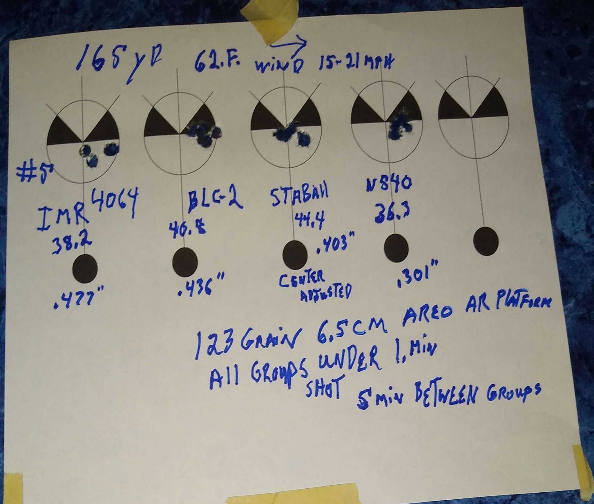

OK the quick and dirty as I have assignments due and NO I didn't setup My Labrador ,so NO ES SD data . Next time I'll do the whole enchilada but first must build a New Rifle bench ,My current one is smaller than I'd like . Seems I can't fit everything on it I'll need too . My shed bench is large enough but faces My Pistol range 0-60 Yd. only . So off to the Lumber Yahrd as the Chief constable in Young Frankenstein would say .
Did these tests whole lot different than I normally do . Shot #5 shot group in under #1 Minute ,allowed #5 minutes between groups. Including #20 shot group . Even put up virgin cardboard backers ,so NO fake BS . 165 Yd. & 278 Yd. breezy today started 12-15 Mph ,finished 18-21 Mph and they seemed to be drifting with the wind or I'm off center . I did adjust wind #2 clicks on StaBall but then ran it back . Best group N540 followed by StaBall . Funny IMR 4064 put #3 in near same hole after spreading 1 St. #2 !.
MY 129 gr. Hunting loads proved VERY respectful and their zinging fast ,I'll also run data on those next time ,as that's #20 into one oversized hole .
Overall I'm tickled shirtless with My Custom assembled Aero Precision 6.5 CM . :)(y)

very nice! I also like N540 as it is my 2nd choice (strictly subjective) behind N555.
I don’t shoot 129, but I have shot 123 ELDM and used 40 grains of N540 at 2.8 col.
Otherwise I am all in on 140 grain with a side of 147’s .

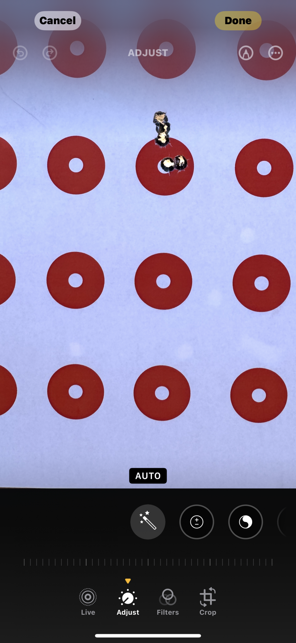

These were my 5 rounds today.
Inch circle and white circle in 1/4.
What's the time interval between shots ?. Try 0.035" off lands . It may be something as simple as powder preference ?. I learned that the hard way decades ago ,so now days I load up #3 groups of #5 each low ,med and high charges of various powders and see which the weapon prefers before actually doing any serious load developments . I also shoot #3-5 fouling shots before shooting anything for evaluation . N540 N555 are excellent VV powders out of mine ,as well as BL C2 .
HMM, ya I don't like that verticle poi spread. Something is telling me that the small a speed variation you see may to be too little to cause that much vertical poi dispersion. It it "walking" low to high on you, or hitting random hi/lo poi's?
Random hi and low, then a good group.
Ok so that tells me that you may need a slight drop in powder charge, you are likely right on the cusp of what velocity node that gun will tollerate with that bullet/powder. Might try a 42.3 and 42.1 and see if you get a better SD and more consistent grouping with less "walking on you". Also make dang sure you are shooting off a very solid rest and have as little wobble zone as possible. You probably know this but the heart rate can make that bullet jump the amount you are seeing. Not that you are shooting wrong, but a natural respiratory pause, then send the round between heart beats. I was shooting a while back and was amazed at the amount my heartbeat would influence the movement in the reticle. Since then I changed my shot process, striving for a NPA natural point of aim, and my groups shrank by about 1/3 to 1/2 of what they were before. Come to find out, my "issues" were mostly ME,, the nut behind the scope.
