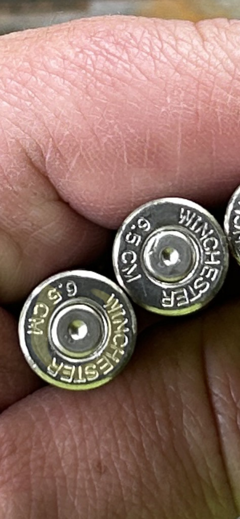

I highlighted what I’m concerned with

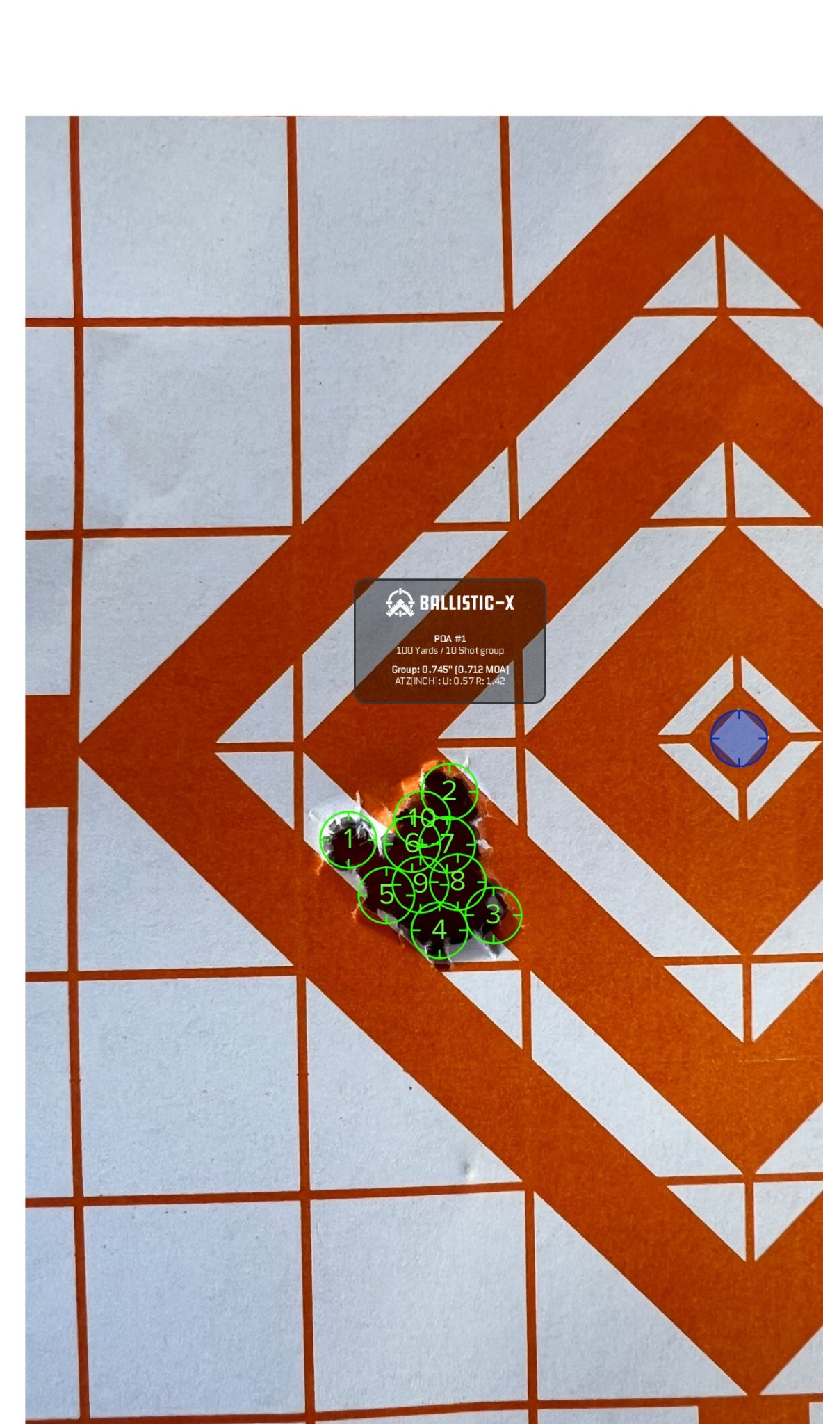

Still doesn’t seem to be bad to me from the pics. Definitely be your own judge obviously. I’ve never used that powder so maybe some one else can chime in if that seems to be a normal load or not.

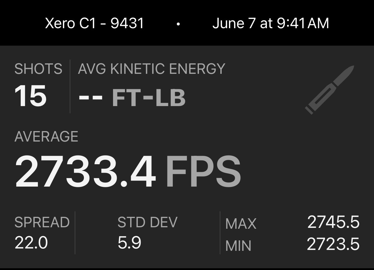

I'd say those velocity variations are equal within sample noise, are you using a lab scale or beam to finish the charge to target?
What projectile & barrel lenght? What powder?
If that's "old" winchester brass should be fine, the new stuff seems to be hard but thinner in the body, lot of people getting cracking with low fire count on new stuff but the old ones seem to last a long time. If it's the older brass it may get light ejector prints at reasonable loads, I can see faint ejector marks on my 6br norma brass from about 3 grains under what everyone runs, my velocities line up pretty much exactly with all the 6BR/Accurate shooter load guides too.
Primers look fine. Extraction ok?
If that's "old" winchester brass should be fine, the new stuff seems to be hard but thinner in the body, lot of people getting cracking with low fire count on new stuff but the old ones seem to last a long time. If it's the older brass it may get light ejector prints at reasonable loads, I can see faint ejector marks on my 6br norma brass from about 3 grains under what everyone runs.
Bear in mind that headspace can also be a problem separate from charge weight.

With 6.5 Staball I haven't been able to achieve as low SD as I can with other powder choices such as H4350, RL16, RL15.5, N555
I don't think you ever told us the speed you got or what rifle/barrel you've got. That is an important piece of the equation.
42.3gn-2662
41.9-2648
Aero Solus in KRG Brovo
