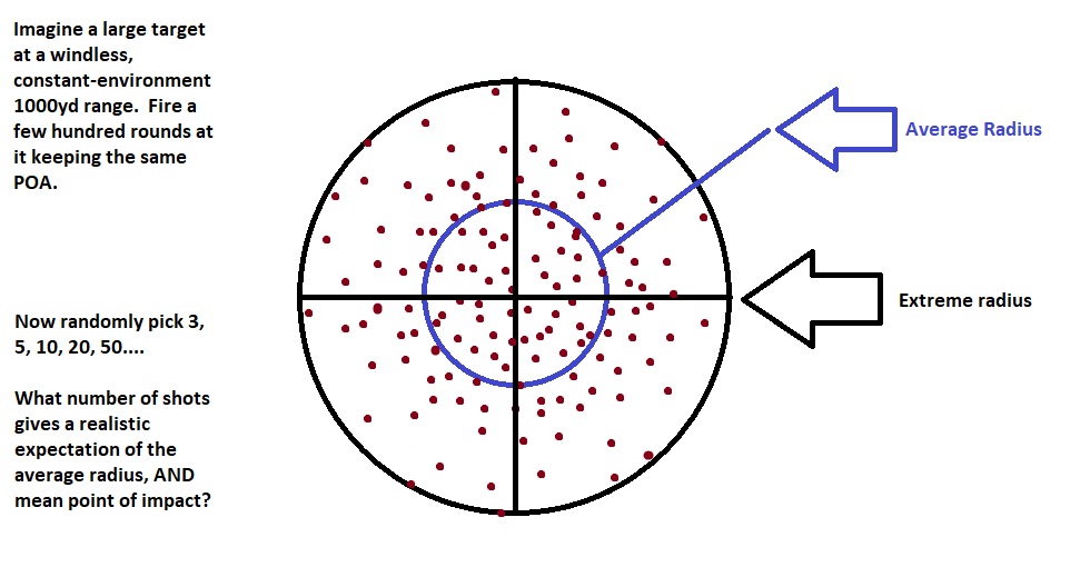

Realistically though, the way statistics works and varying charges work, as long as he isn’t over max, he will be fine. More charge equals faster bullet. The whole “node” thing is baloney and is just a matter of not enough data points.
Pick a charge about 3/4 of the way from min charge to max charge, then work on seating depth and voila’! There you are.
3 or 5 rounds just does absolutely nothing because of insufficient data. One group may look better than another group, but it is an illusion.
Randomly pick any 5 rounds from below, then pick another 5 rounds and one of those groups will look better than the other. But realistically it isn’t better.
Agreed ; Minimum rounds per charge ( after #5 round per charge evaluation ,In My case ) , should be minimum of #20 rounds .
Shot in 4 groups of #5 rounds ,this gives a Good indication for all data . Loading ever so carefully one can actually adjust OAL on each group ,so as to see where the sweet spot lies for any particular weapon ,IMO . I generally find best accuracy is 1.0-1.5 grains less than maximum charge .

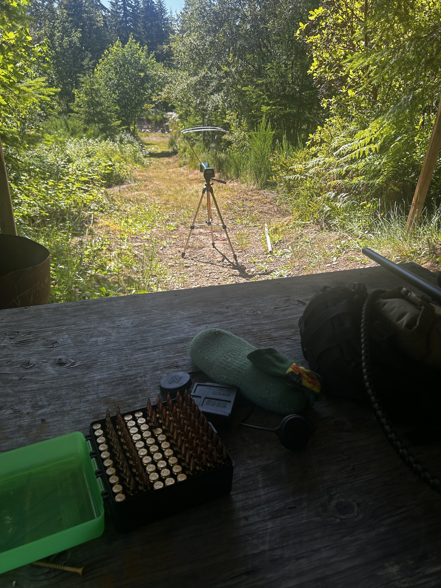

No idea why you are loading those so short. What rifle and chamber? If a SAAMI chamber then you should try loading them about .020" off the lands.
Loaded to 2.880
Then matched ogive measurement the rest of the way. These are the speeds so far and with the exception of this last group, they were all 1” or bigger (this last group didn’t register on chrono
37grns of H4350 is very low. I'd bump that up and you might see better groups.
I’ve got all the way up to41 gr. It was so bad I moved on right away they’re here loaded. I’ll make em the next volley. FYI I’m at the range now. If I don’t see some improvement though I’m about to storm off like a Child and go play with the kids in the pool

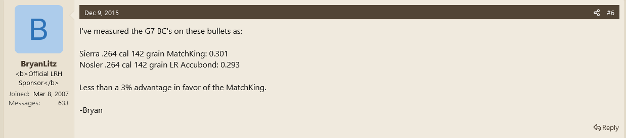

For a budget friendly solution give the 142 SMK's a try. Should hit lands loaded about .030 shorter than the ABLR's
Those 2 bullets are so close BC wise you could use the same dope for hunting to 600y.
Don't fall for the Nosler BC hype.
I just picked up another 400 of the 142smk's for $99. What did those ABLR's cost you?
BTW if you want accurate G7's to plug into your solver. Sierra's G7 can be difficult to find.
