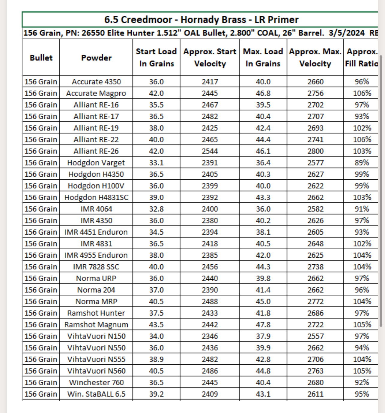

I find it interesting with book maxes:
Hornady says book max for IMR 4350 and a 140 grain bullet. At 42 grains for 2750 fos
Lyman says 140 Amax = IMR 4350 @ 39.xx something is max.
velocity also low on every powder all maxed approx 2660fps. In this manual
This is a classic illustration of different rifles, and different reloading details. For instance, none of the above mentions pressure used or friction of the bullet to cartridge at contact point. I am well aware of the potential inconsistencies because I treat my bullets with hBn. Makes yet another difference between my results and the “book” results.
Don't know about Hornady but in Lyman's LR Precision Rifle manual they like Sierra use a universal receiver , so their results depend on the barrel make as well as length and several other factors
Manuals are just reference points. Not anything carved in stone. Use them for a starting point and go from there.

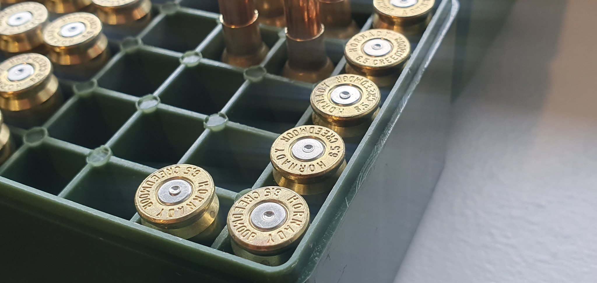

Please advise if this is normal for primers to look like this (heightened edges like it is popping out?). I previously used CCI200 with "normal" signs but no more local availability. Exactly the same very mild load of VV N150 36gr with ELDX 143gr, RWS 5341 standard LR primer @ 2.860 COAL producing 2535FPS with a 20" barrel. All normal. GRT thinks this is ca 43-44k PSI load. I also tried VV N555 with ca 53K PSI load and got exactly the same primer picture as shown. CCI200 acted Normal under the same pressure.
Anyone else has used RWS 5341 primers? Is this ok and safe to proceed? Absolutely no other pressure signs shown - no heavy bolt lift, no ejector marks, primer edges are nice and round etc.
