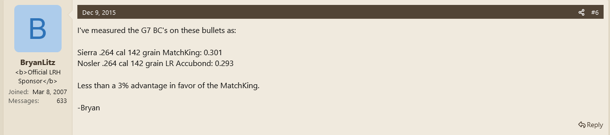

For a budget friendly solution give the 142 SMK's a try. Should hit lands loaded about .030 shorter than the ABLR's
Those 2 bullets are so close BC wise you could use the same dope for hunting to 600y.
Don't fall for the Nosler BC hype.
I just picked up another 400 of the 142smk's for $99. What did those ABLR's cost you?
BTW if you want accurate G7's to plug into your solver. Sierra's G7 can be difficult to find.

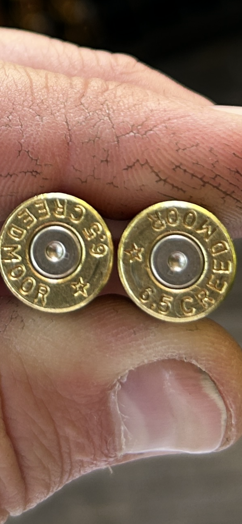

Ok feeling better (not knowing what to look for is scary) came across my first pressure signs. I have flattened primers (the ring marks around case head was there on 37 gr of H4350)

Left was 37 of h4350 right was (going off memory) 43.5??? Of stayball. The primer does look a little flattened, when compared to the one next to it. Are you saying that is normal and not flattened?
The one on the right has a slight ejector mark over the C, so that is mild pressure sign, I would not go higher. The other signs to pay attention to is stiffer bolt lift or clicking at top of bolt opening.
