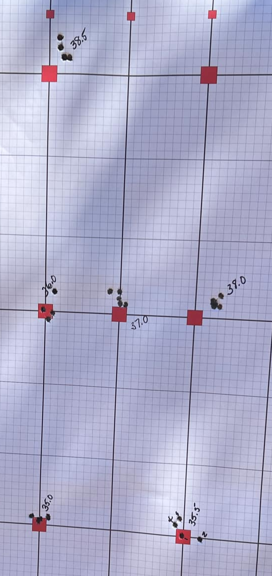

Tested different loads today that were put together by my uncle. Curious which ones y'all might go with. These were Hornady ELD Match 130gr with various amounts of RL-15 as marked on each group. Thoughts?
PS Sorry if I attached the photo incorrectly.

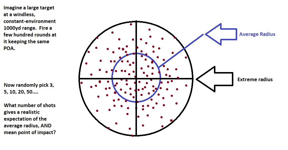

A decision based solely on 3, 4 or 5 shots is shaky at best. There is always a chance of randomness involved. If you shot 100 rounds (not suggesting you do, people lose their sht over this) you would have a scatter pattern. From that scatter pattern any 3 are possible combinations (or 5) which either looks really good, really bad, or an odd looking shot that seems to exist outside your pattern. That’s when people will say “I pulled that one” when it is just a part of the statistical possibilities.
Scientifically there is this: the more powder you use the faster the bullet will travel. The so called speed nodes are just another application of the below pic. Pick a safe charge (I usually go about 75% up from minimum towards maximum and that’s my chosen charge. I think there is an effect regarding vibration which I have been working on predicting using software and RL results but I have no conclusions yet for that.

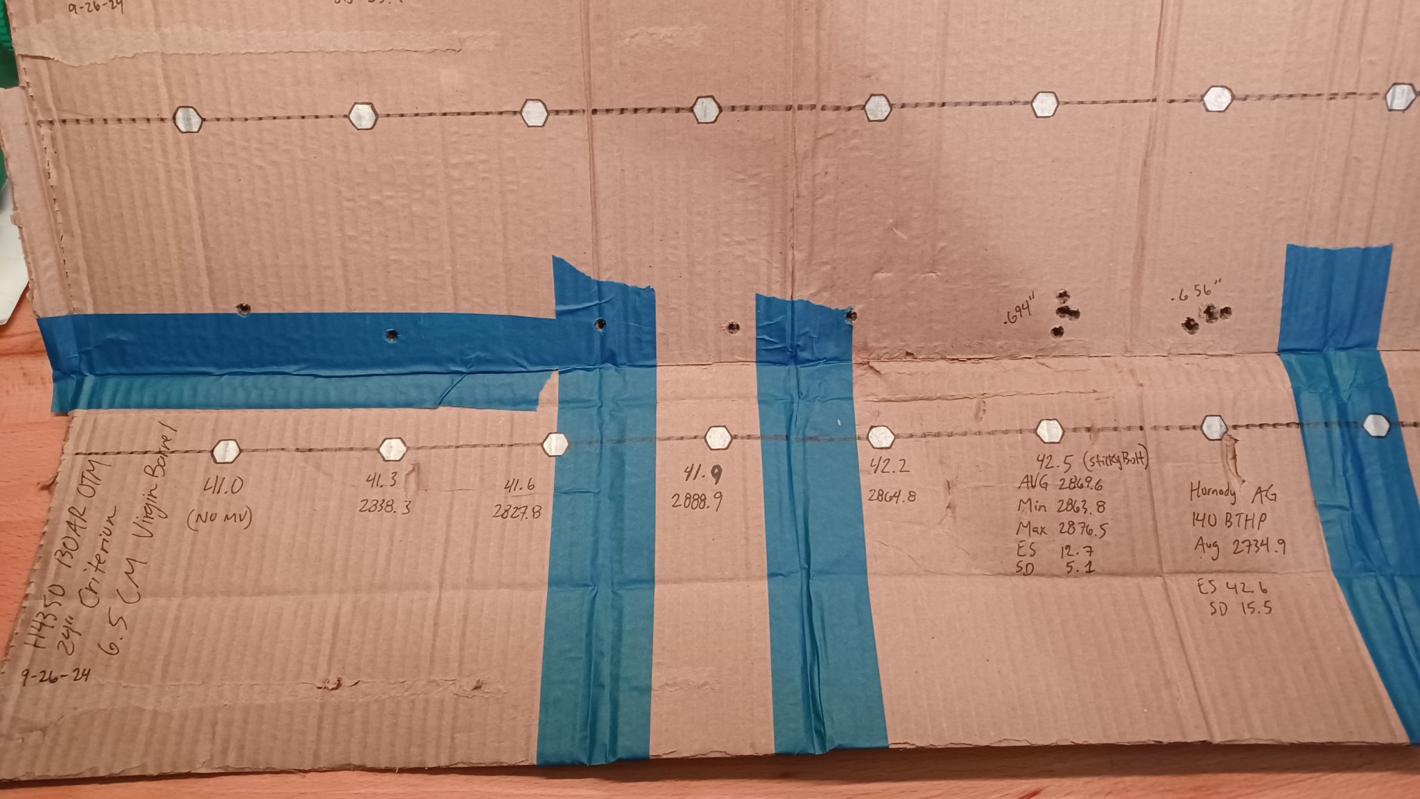

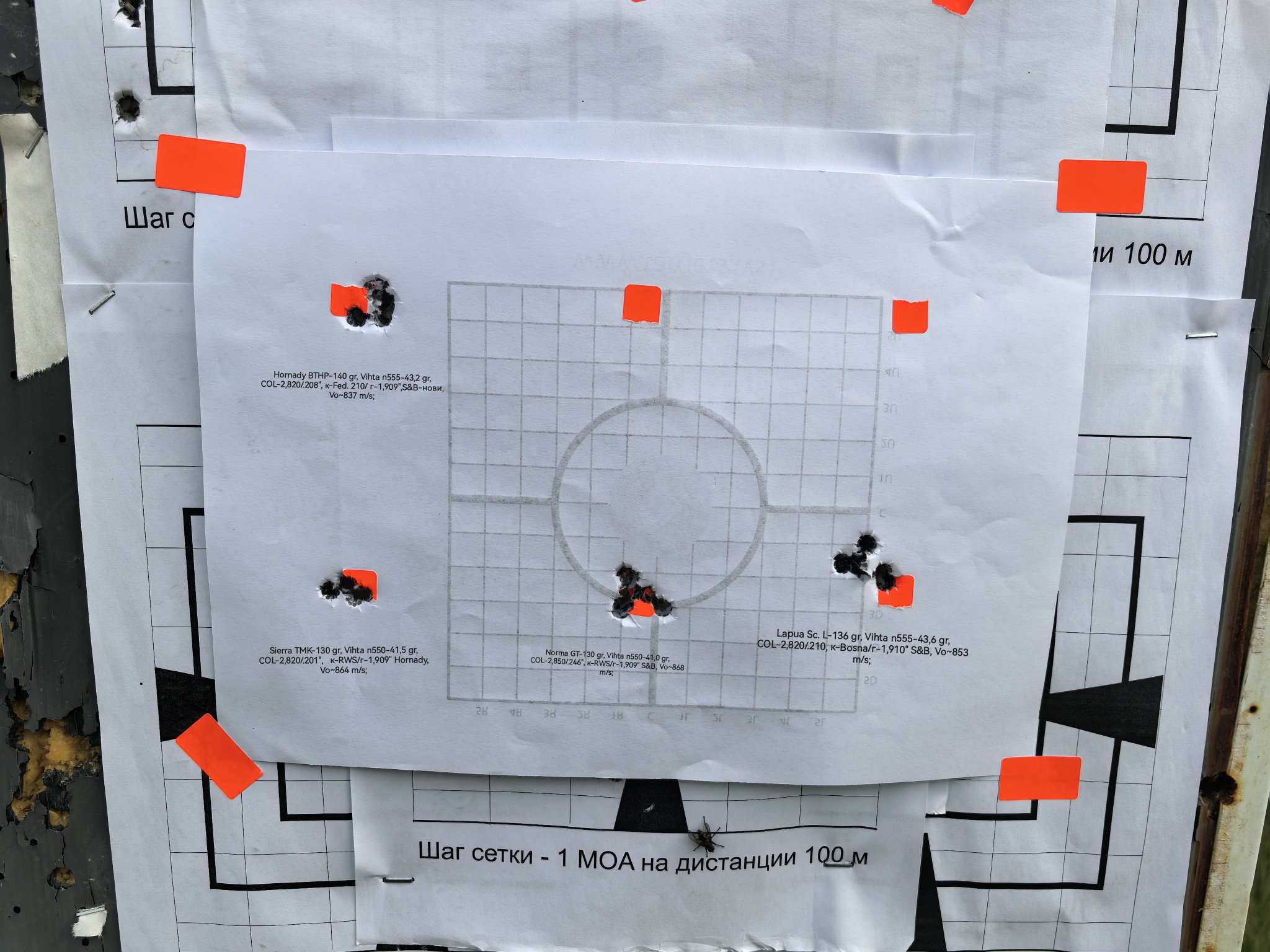

Went out with my new barrel. Shot one of each just to get MVs. Since my previous barrel liked 42.5, I had a bunch loaded so i decided to take 5. Anybody care to share how I should proceed.
I was thinking for the first 200 rounds, just shoot a generic load of anywhere between 41.3 & 41.6.
Then fine tune or do load development then, once it has sped up already.

With a new barrel which should speed up at some point, your speeds are too high. I would drop down to 41.0 gr and see what it does. You may even need to drop down lower than that. JMHO The advice is free and worth just a little less than what you paid for it.
Reactions: Bbracken667
Yes that's fair. How much do they usually speed up in your experience? This is my first time ever doing a barrel swap so I'm not savvy in that regard.
These are 130s and not 140s though. Although it still might be a touch fast.
My previous barrel, which was the factory barrel, was at 2847 with 42.5.
It depends on the barrel I guess but I've seen 50-100 fps as they settle in. I had one that sped up and then slowed right back down. Hard to figure out where you're at when it does that.
I did think you were running 140's. I saw the 140 BTHP on the right side of your target and assumed they were all 140's. So the speeds aren't as hot as I thought. I still wouldn't push it too hard until I had a good feel for what the barrel was after.
2825 fps seems like a good targeted speed after the barrel speeds up. Maybe some 130 shooters will drop in and clarify that.

Yeah, the 140s were just hornady American Gunner factory ammo. It was one group I shot just to have a "control" I guess.
I really like the 130s at the 2850ish range but I do see people dip into the 2900s.
It should be noted too that I am doing this on a 24" barrel. I don't mind slowing down either.
I'll do a more refined load development once I meet the 200 round mark.

I ended up throwing a random charge of 40.9 with once fired brass from my previous barrel. I headapaced this new barrel off full length sized 1x fired brass (with shoulder bumped 2thou) from previous barrel. Used the case as a go guage, and a case with tape on the case head as a no guage. It worked great.
This new charge of 40.9 on said brass, got me an avg of 2777.8 over 29 shots with an ES of 36.2 and an SD of 7.8 so I think it's going alright so far. Once I hit the 200 round mark, I'll do proper load development.
