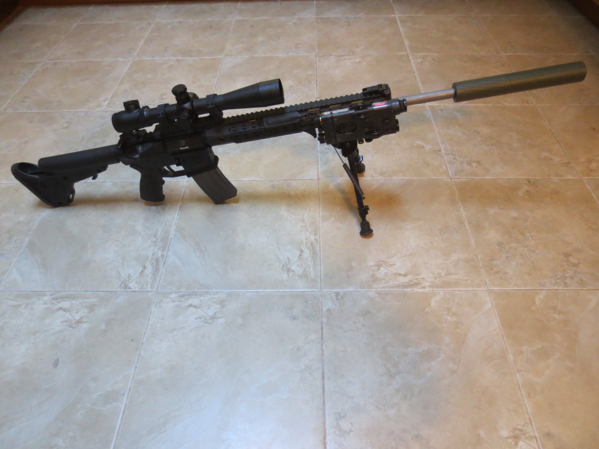

I like the VLTOR uppers for these and I used a 2nd gen. Noveske lower. Noveske makes one of the best receivers you can get, better than the KAC lowers IMO/E. They make a matching upper but the VLTOR MUR1 matches it like it was made for it too (Noveske uses/used a lot of VLTOR stuff). Geissele Hi-Speed. I usually use a JP Ent. FMOS carrier but this one has a carpenter steel milspec type, PRI gasbuster handle. URX4 keymod, MIAD grip and UBR A5 stock assy. This one has a Larue gas block, it's solid and Satern cuts use a long gas block. TBAC 6.5 Ultra 9 suppressor is the tits with these rifles. The 3.5-10x Mk4 is getting the job done; the Badger mount is high to accommodate night vision.
