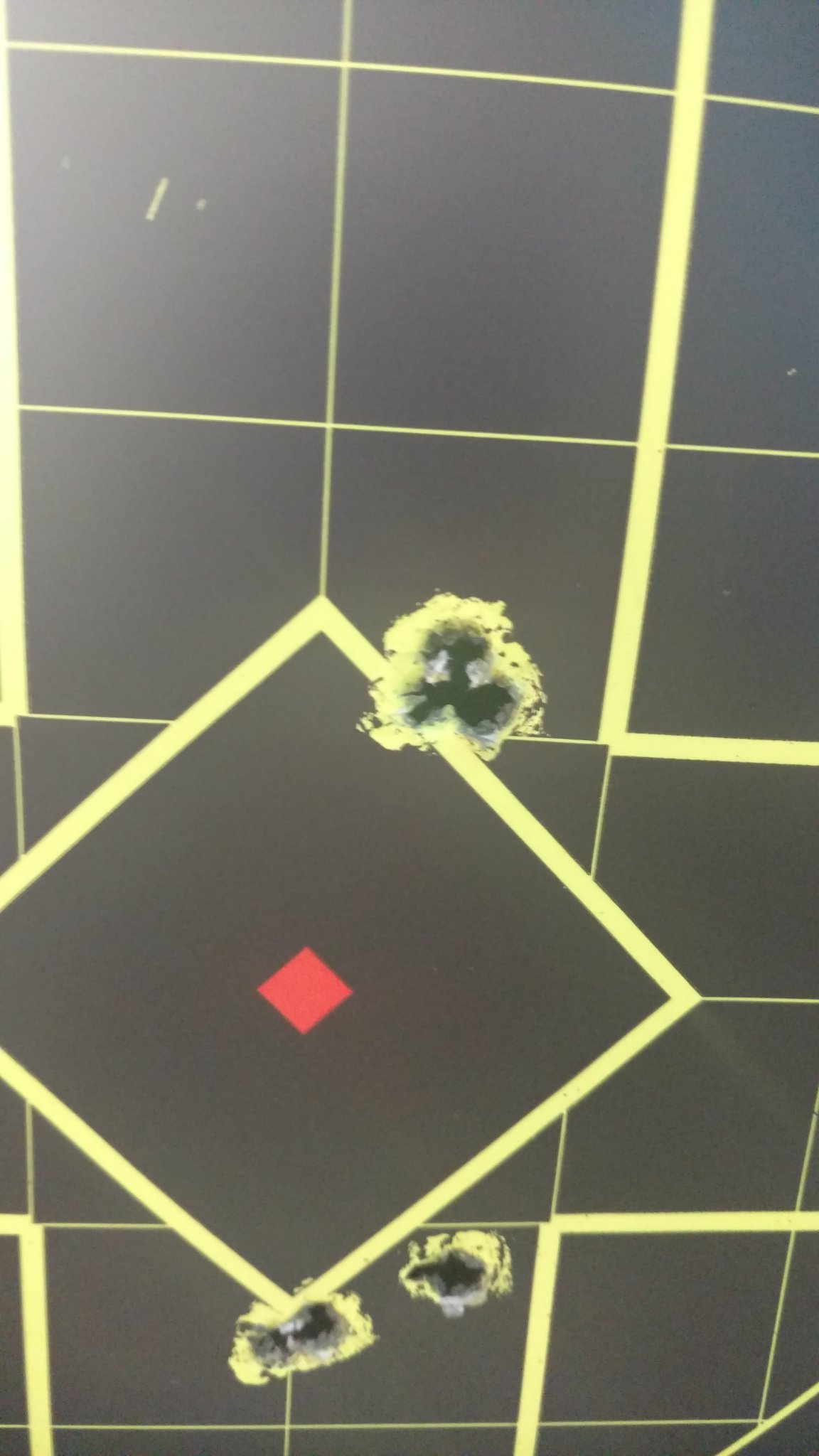

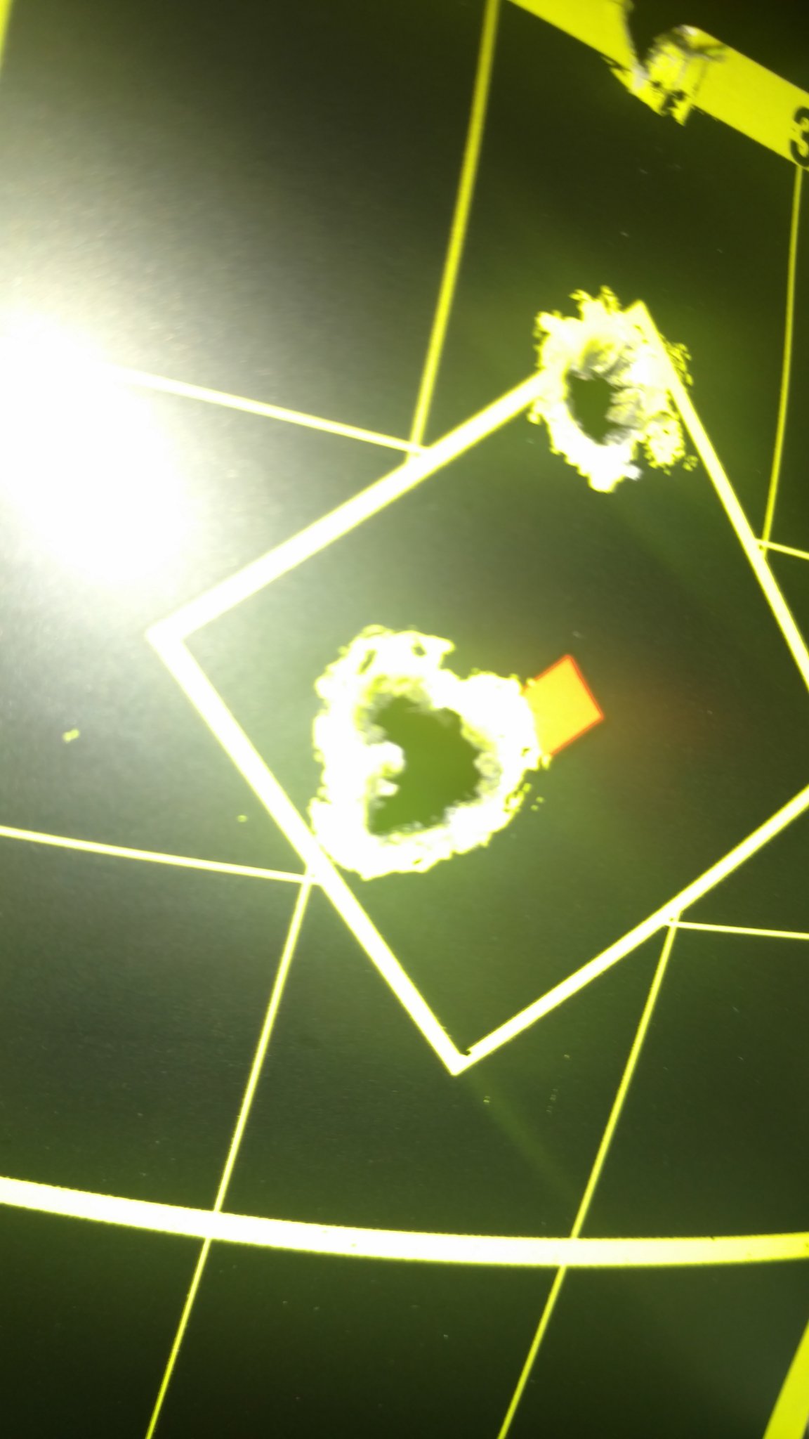

Thought I would share some info I have gathered working with my new 6.5 PRC.
Plans are for 130 grn bullets and try some 140s later. So far it is a pleasure to shoot. Very little recoil, less than 308. And is a Lazer flat to 1k. Shot some Hornady factory 147s that chrono'd about 2850, which is 100fps slower than advertised on the box.
Also ran a little H1000 and 4831sc. Never got a real good chance to group them mostly due to constant CO wind. But got some Chrono #s that should be helpful.
Rifle is Remington 700 action trued with Bartlien 26" 8 twist and APA little bastard brake. Pillar bedded Manners stock. Nightforce 3.5-15 nxs. Magneto speed Chrono.
Here is what I got so far.
H1000, br2, new Hornady brass, 130eldm.
All three round groups
59.3grn avg3040 es23
59.6grn avg3051 es55
59.9grn avg3078 es30
60.2grn avg3095 es18 (best group .2")
60.5grn avg3123 es13
60.8grn avg3133 es38
61.1grn avg3158 es34
61.1 still held primers and just started to show very very slight ghost of a ejector mark.
I am not pushing hard for velocity, but consistentcy.
H1000 just did not click with me. I felt like it was missing something.
Soo...
4831sc, Br2, new brass, 130eldm.
All three rnd groups
55.0grn avg3034 es24
55.3grn avg3050 es12
55.6grn avg3065 es9
55.9grn avg3085 es9
56.2grn avg3100 es10
56.5grn avg3111 es17
56.8grn avg3115 es23
57.1grn avg3137 es12
4831sc alot more consistent! Definitely going to focus on it a little. Hopefully if the wind stops I can shoot some groups. Pressure seemed lower with 4831 as well. Also have some 7828ssc I will try.
Everything I shot had pretty flat primers. Even the factory stuff, so I stopped looking at that for a pressure indicator. Never got a sticky bolt or a brass flow into ejector. I think everything I loaded could be pushed harder if you are into that. I try not to blow my face off though.

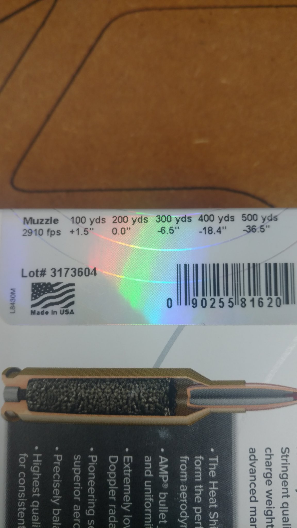

Thanks for posting up.. That 147 factory speed is a little disappointing, I can beat that with 6.5CM. I was hoping H1000 would be the go to on this, maybe not. (since I have 20lbs :oops:) Keep posting up with findings, good info!
Reactions: dukerugger25
My mistake the factory ammo is rated at 2910. My avg velocity was actually 2862. First rnds through the barrel. Might speed up a litte as it breaks in.

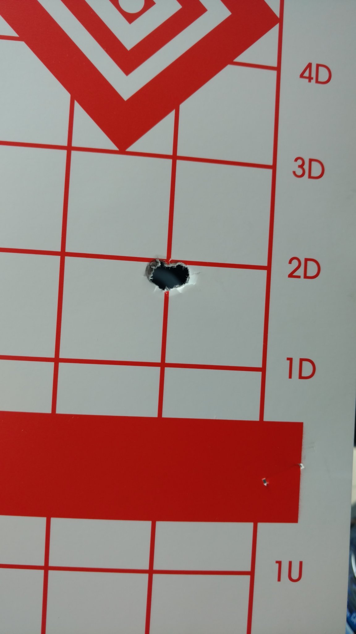

Here is some 140s
4831sc, br2, new brass, Nosler 140RDF,
53grn avg2923 es35
53.3 avg2952 es11
53.6 avg2948 es12
53.9 avg2973 es15
54.2 avg2981 es29
54.5 avg2983 es15
54.8 avg2991 es12
Nice velocity flat spot between 53.9 and 54.8. also got some nice groups at 53.9 and 54.2
