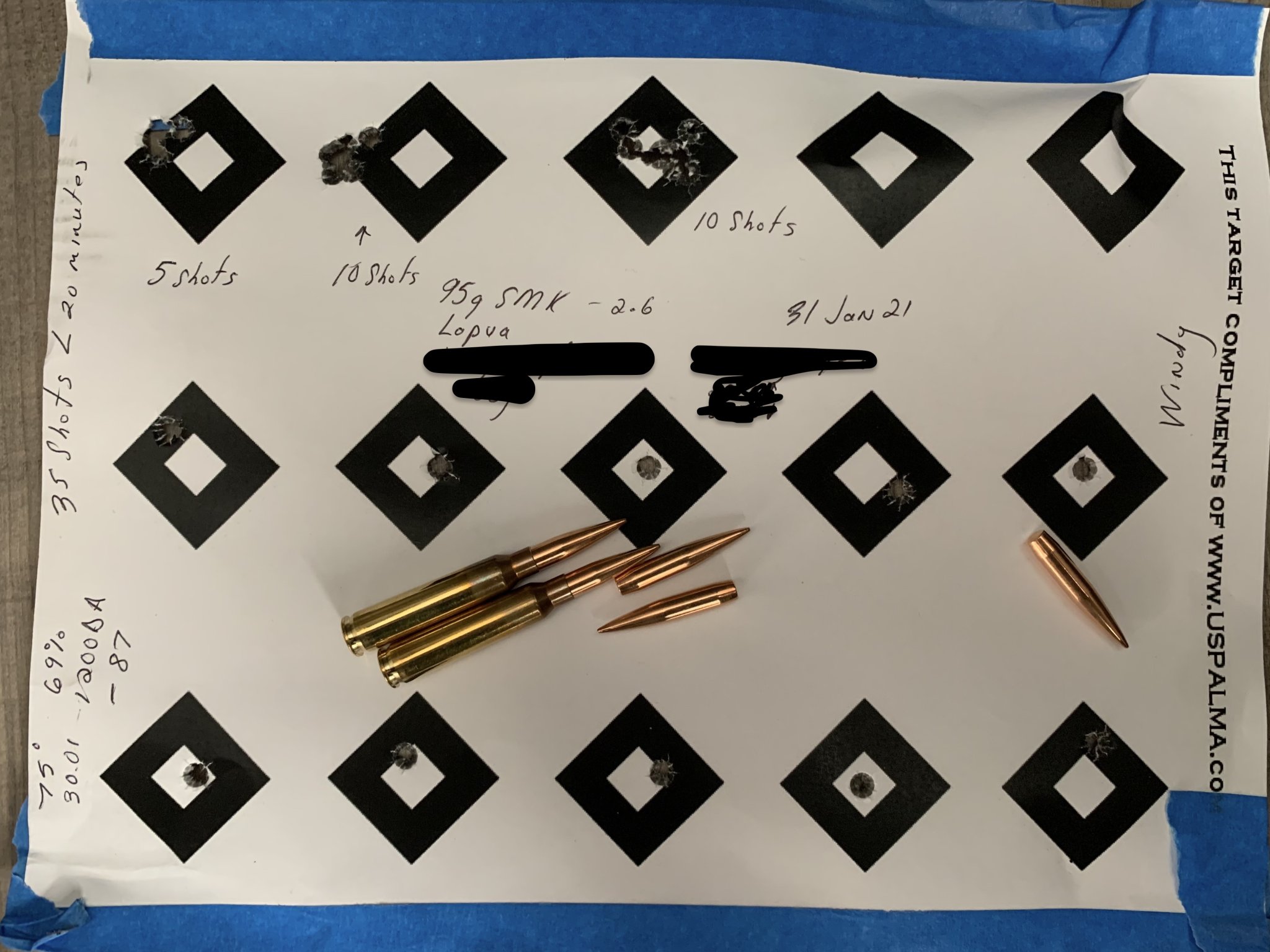

Current barrel is 28" with Varget. Throated L O N G. Much longer than the typically long .169. I didn't measure, rather I gave my smith a dummy round seated as long as my modified accurate mag would hold. I don't have pictures of my 75ELD groups, so the 95s will have to do.

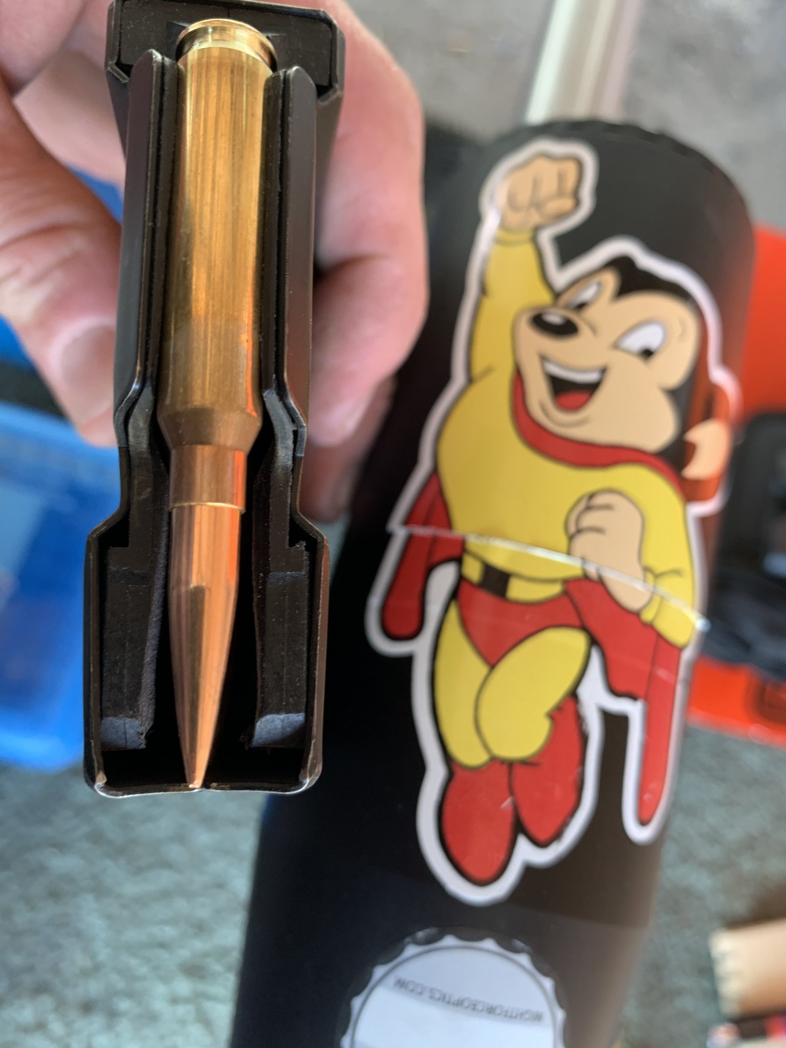

I've put together a 223 PRS type rig and will be shooting my first match in Feb at Tehama Gun Club. The rifle is an ex-Palma rifle, throated specifically for 80+ grn bullets/trued up M700/Krieger and I put it in a KRG Bravo stock. The rifle, set up as a Palma rifle, was a laser with any 80's, but I only shot it slinged up/prone (you'd be surprised how small a group you can shoot at way). Looking over my load data from 20 yrs ago, it was shooting 80's between 2900 and 3050, depending on powder (30" barrel)....and I still have a buttload of ammo loaded for it. Shortest distance I ever shot it at was 300....anyway, I'm gonna shoot it w/whatever and I don't care what class I'm in. The days of me being at the top of the leader board are long over/I don't care....I'm just gonna shoot to have some fun. And....one of my ex-course rifles is a 6mm/107 Sierra's at 2950, which would be perfect. Got a ton of reloading components it to and am in the process of turning it into a PRS type rig.
What mag is that?
Is that 2.6 the COAL?
It's an Accurate Mag 223. I modified it a bit more than people usually do to get over 2.6". I completely cut the front portion of the clampshell insert off rather than just sanding/filing down the front nub that gets you 2.5". I'd have to go back and measure exactly, but it's over 2.6" which is why I put 2.6xx".
