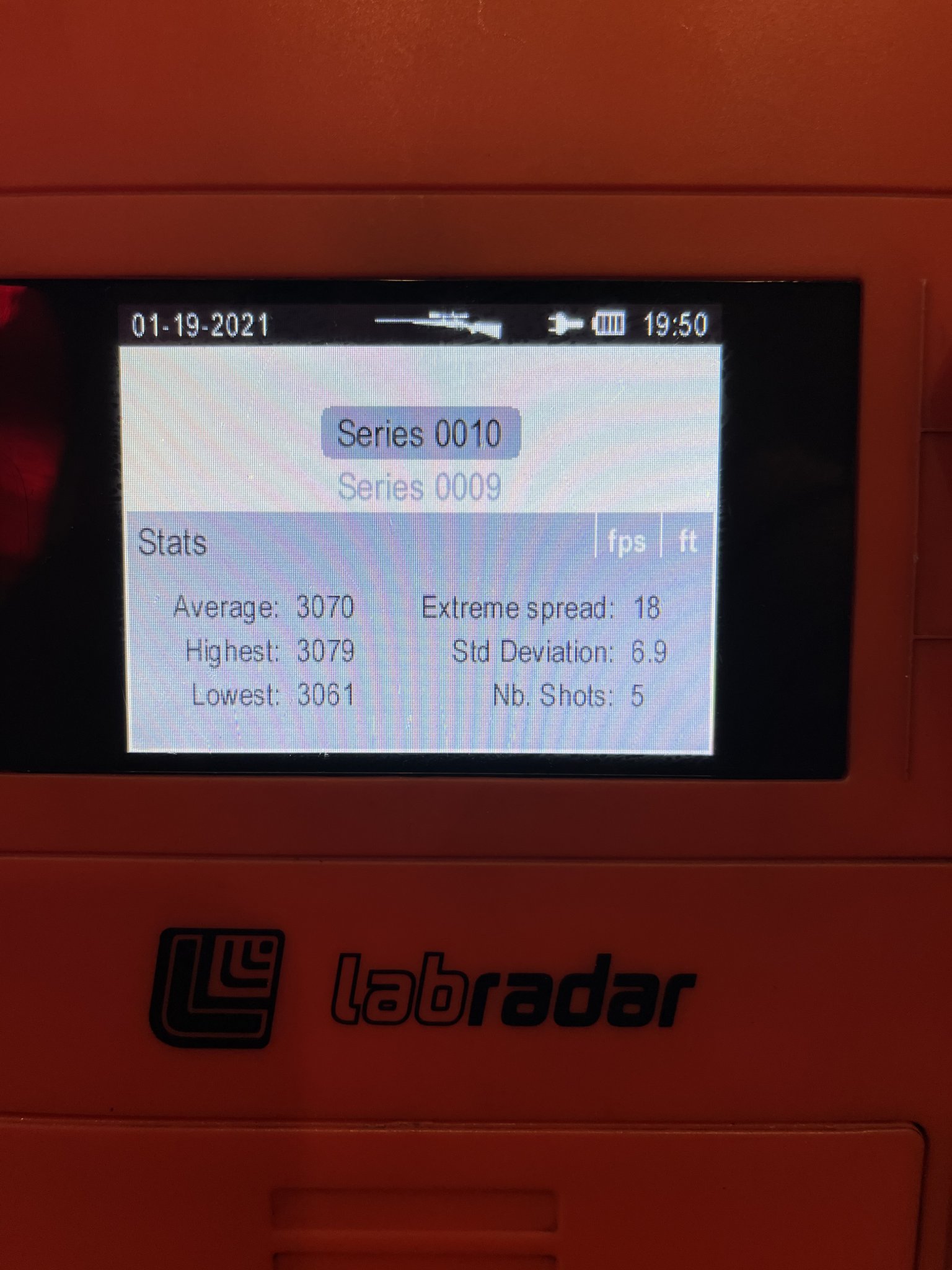

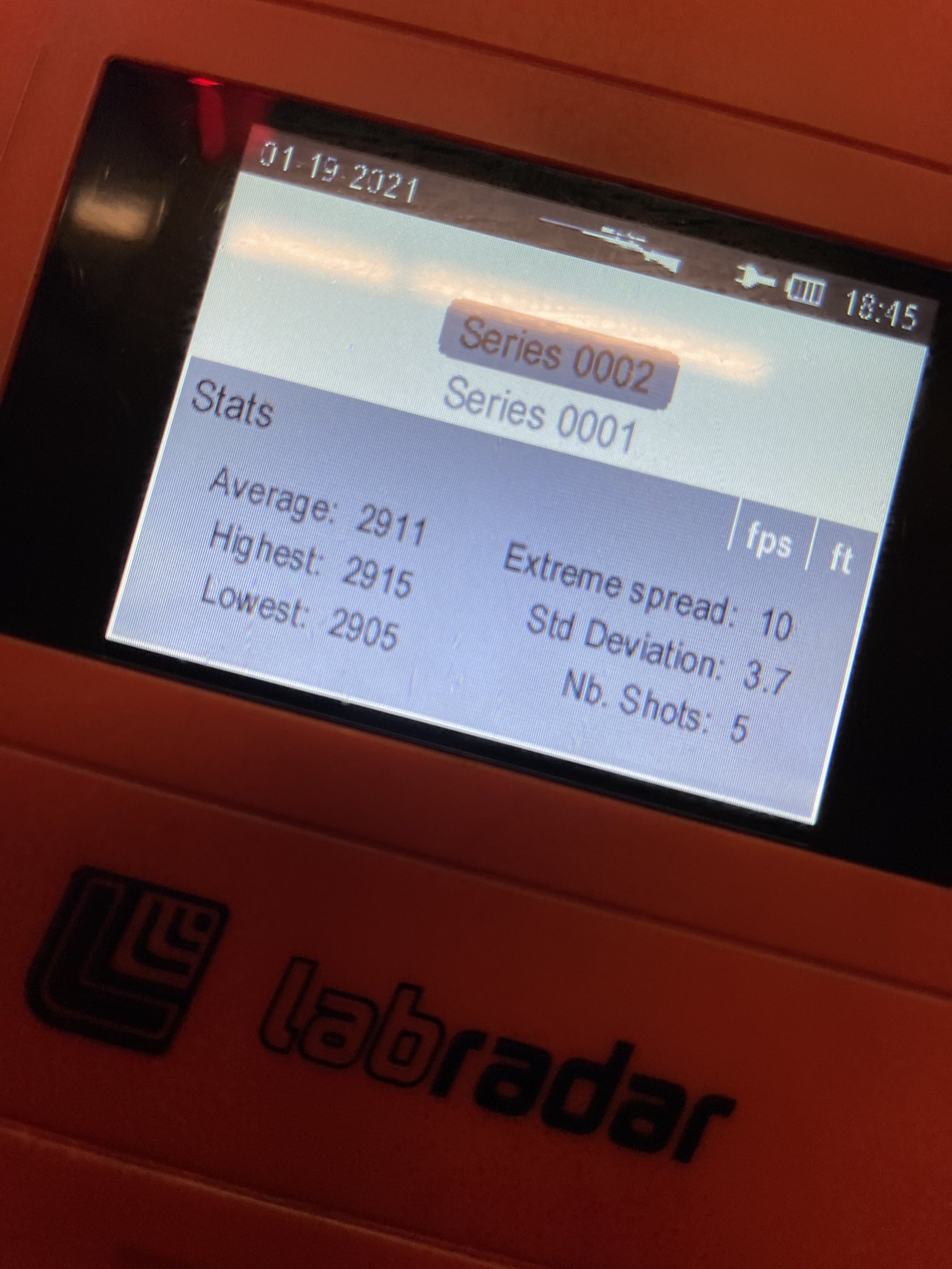

I get 3100 fps on the nose out of my 26" barrel using Berger Match Hybrid and 42.0 grains of H4350.
So, I would say no. You would probably get around 2900 with 105's and less with 115's out of a 22" barrel.
Really? Which Berger hybrid are you using? Every results I’ve seen of 105s with 22~24” tubes have hit 2950~3050 with ease. Thinking of trying 6.5 staball. Book says 3000fps out of a 24” tube with a 115 granted not sure which 115. I know the 115 is a different ball game but I’d be shocked if i couldn’t hit 3000 with a 105.
105 Berger Match Hybrid Target
26" Bartlein M24 barrel
42.0 grains H4350
Lapua brass
Fed GM205 Match primer
3100 fps average of 10 shots

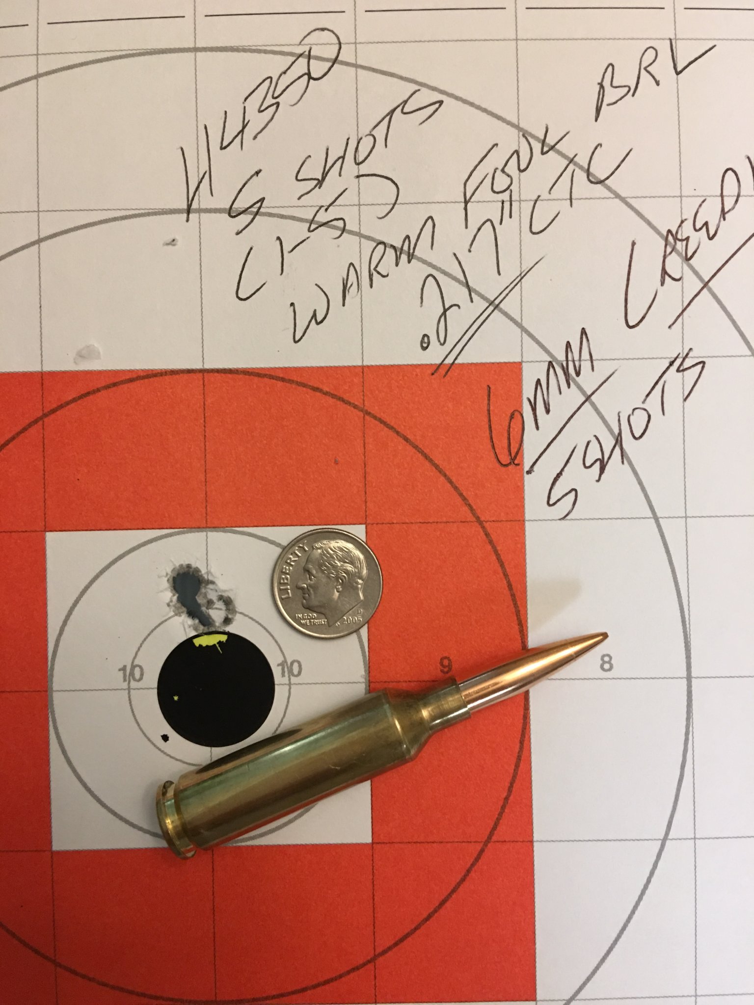

When working up loads for my 6CM, I got the 5 shot group below so, I stopped. Most guys shooting PRS are downloading slower for barrel life.

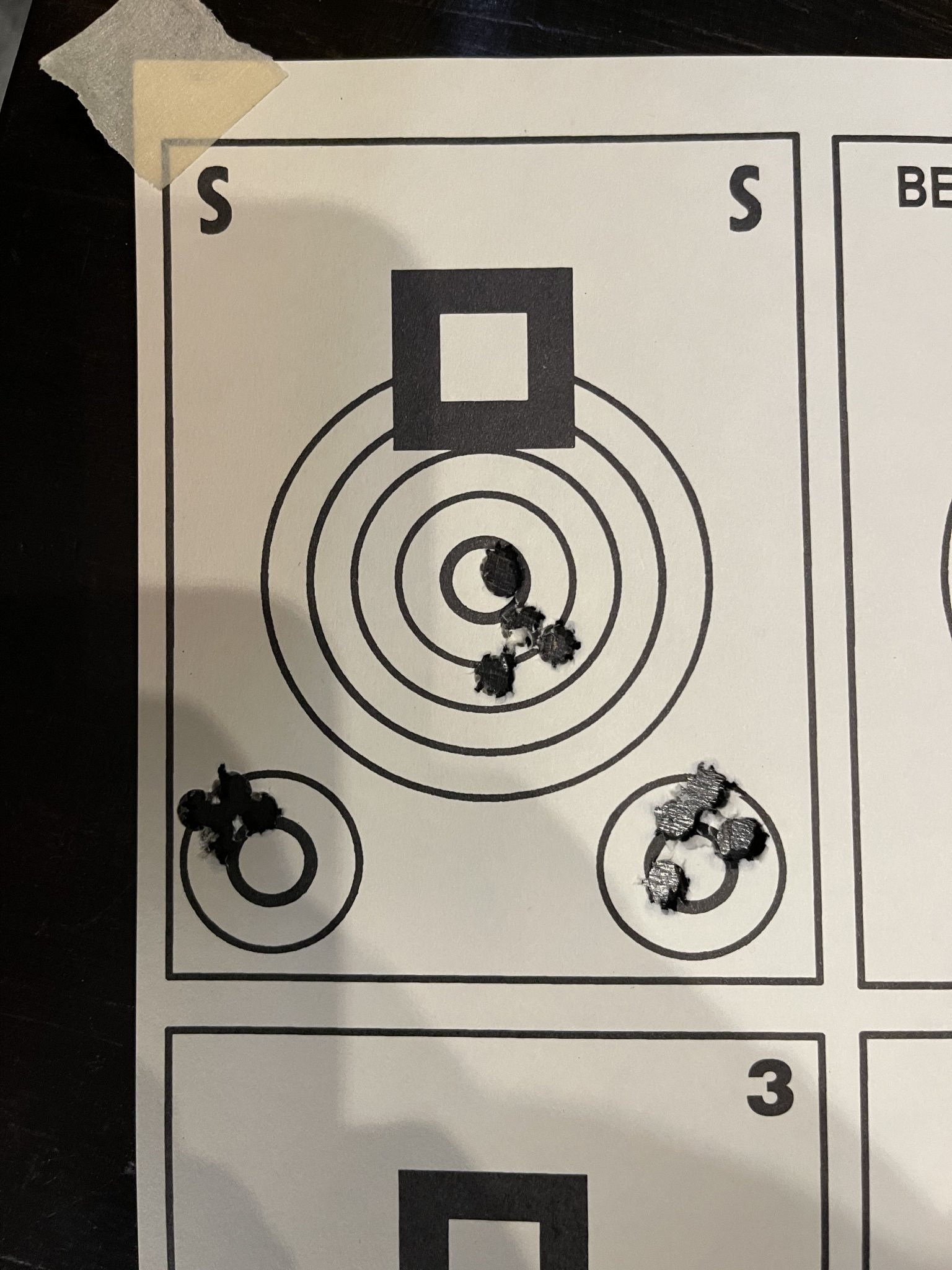

Ok, how plausible does this seem to the more experienced reloaders than me?
180 rounds in
26” 1-8T Hart barrel
42.1 grains H4350
Lapua brass
CCI400
105 hybrids .090 (!) off the lands
Is anyone else jumping the 105 hybrids that far? That’s where it seems to shoot best.
