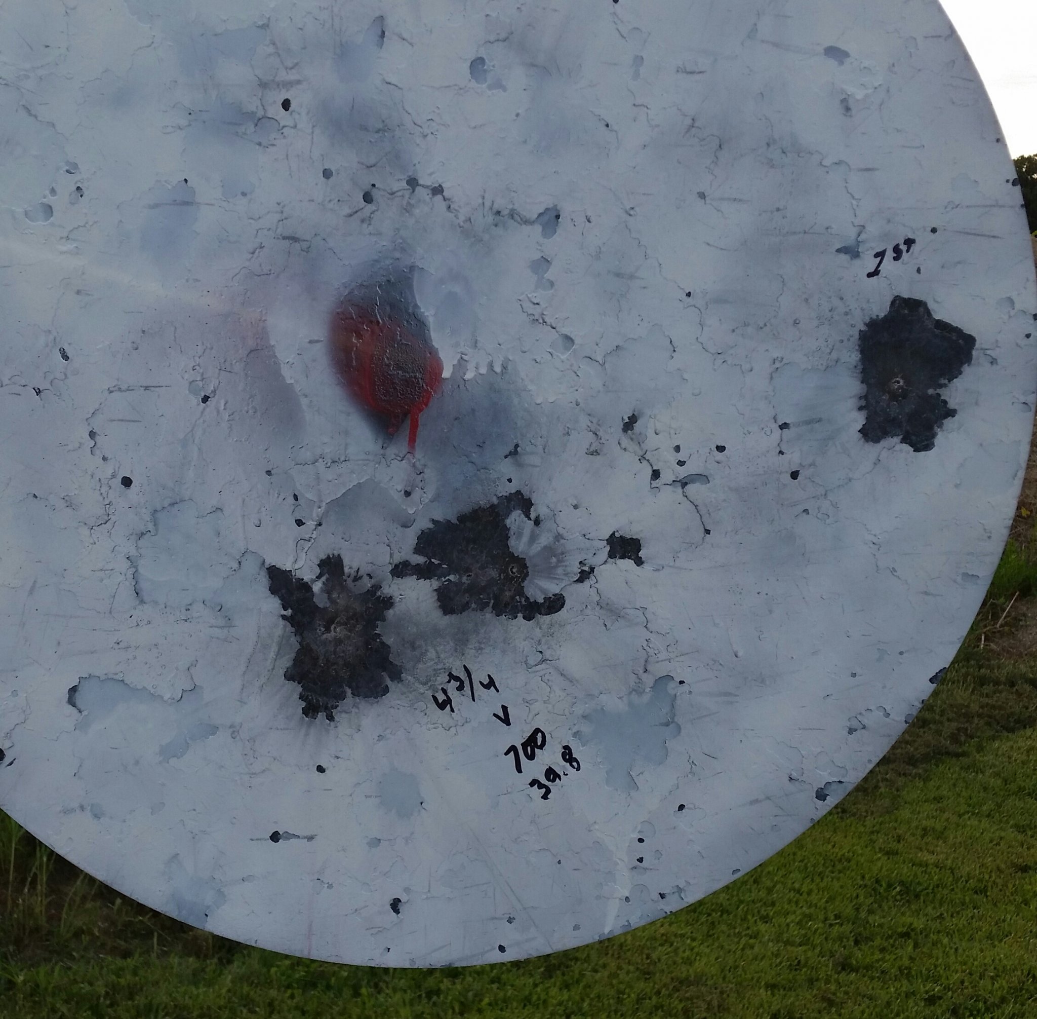

First up 39.8, 1st shot I overestimated the wind and it went a little wide.

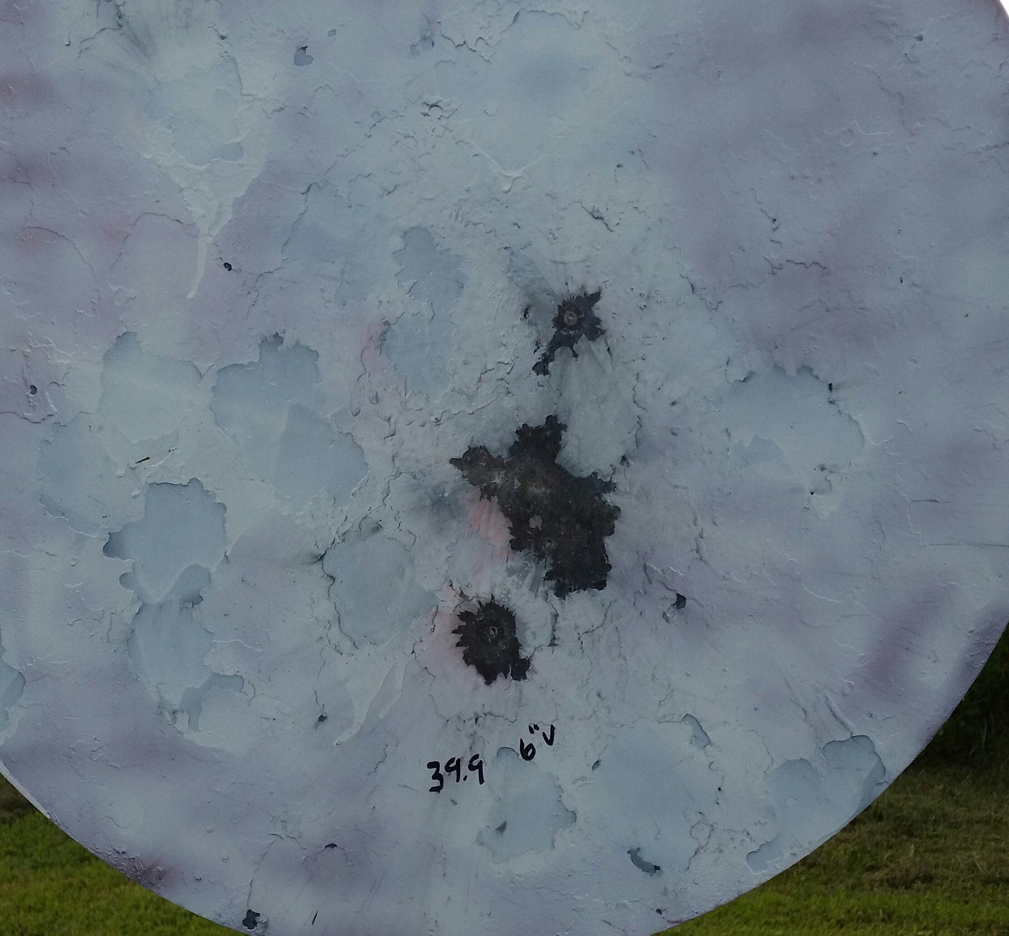

39.9 had the best velocity numbers

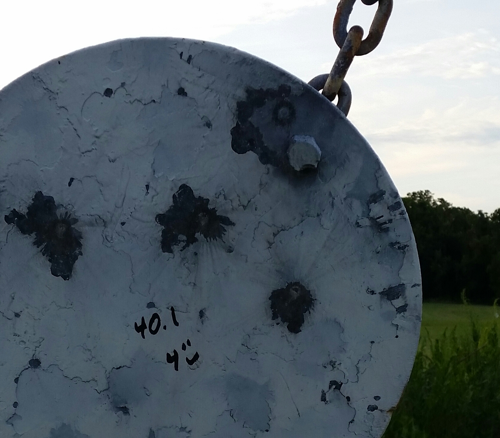

40.1, I added 2 tenths elevation, the wind switched a little and shot number 3 was wide and just off the plate since I was using a small plate this time.

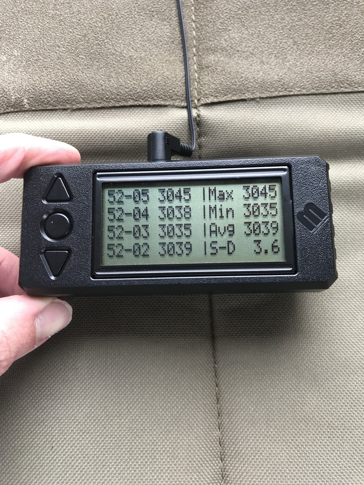

Finally chrono’d my two loads with the 108’s
40.6 of RL16 gets me 3039 w/3.6SD
41.5 of H4350 get me 3120 w/ 5.7 SD
Only 5 shots, but It’ll do
