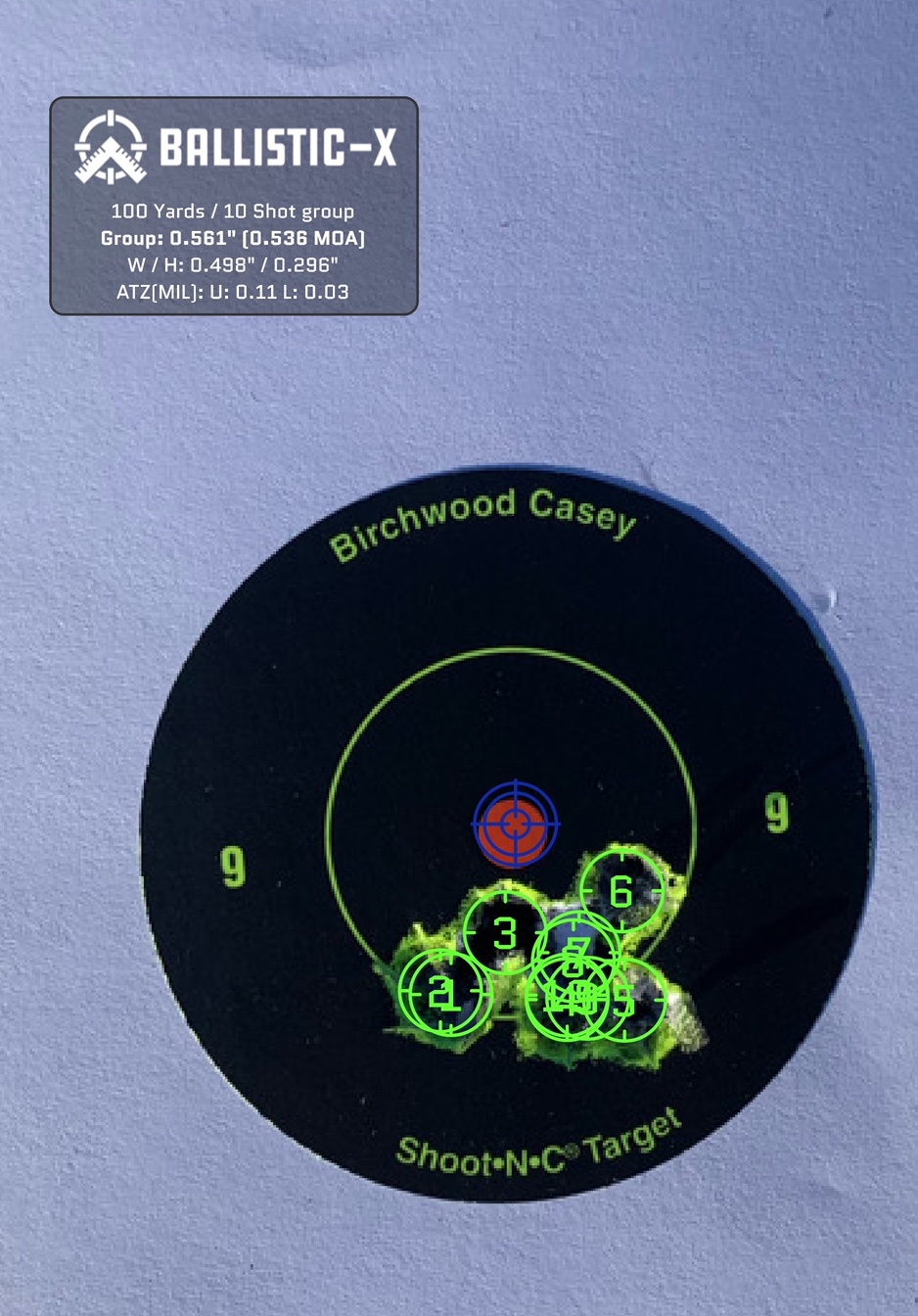

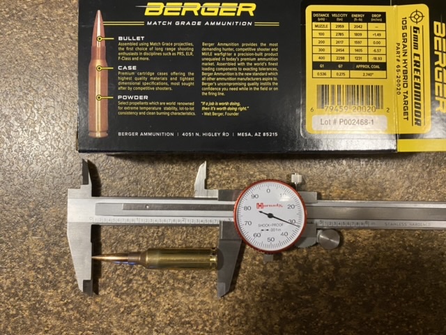

Need some help. Buddy let me try some factory Berger 105 hybrid 6mm Creedmoor ammo. They shot great. If anyone has some, can they measure the overall length, not base to ogive, but the entire length. Thanks.
Looks like 2.730 +\- 5 thou

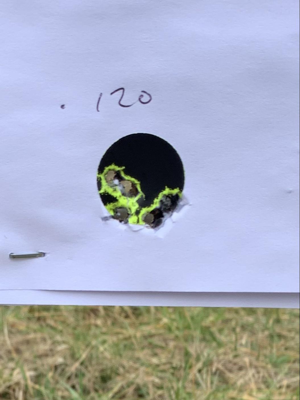

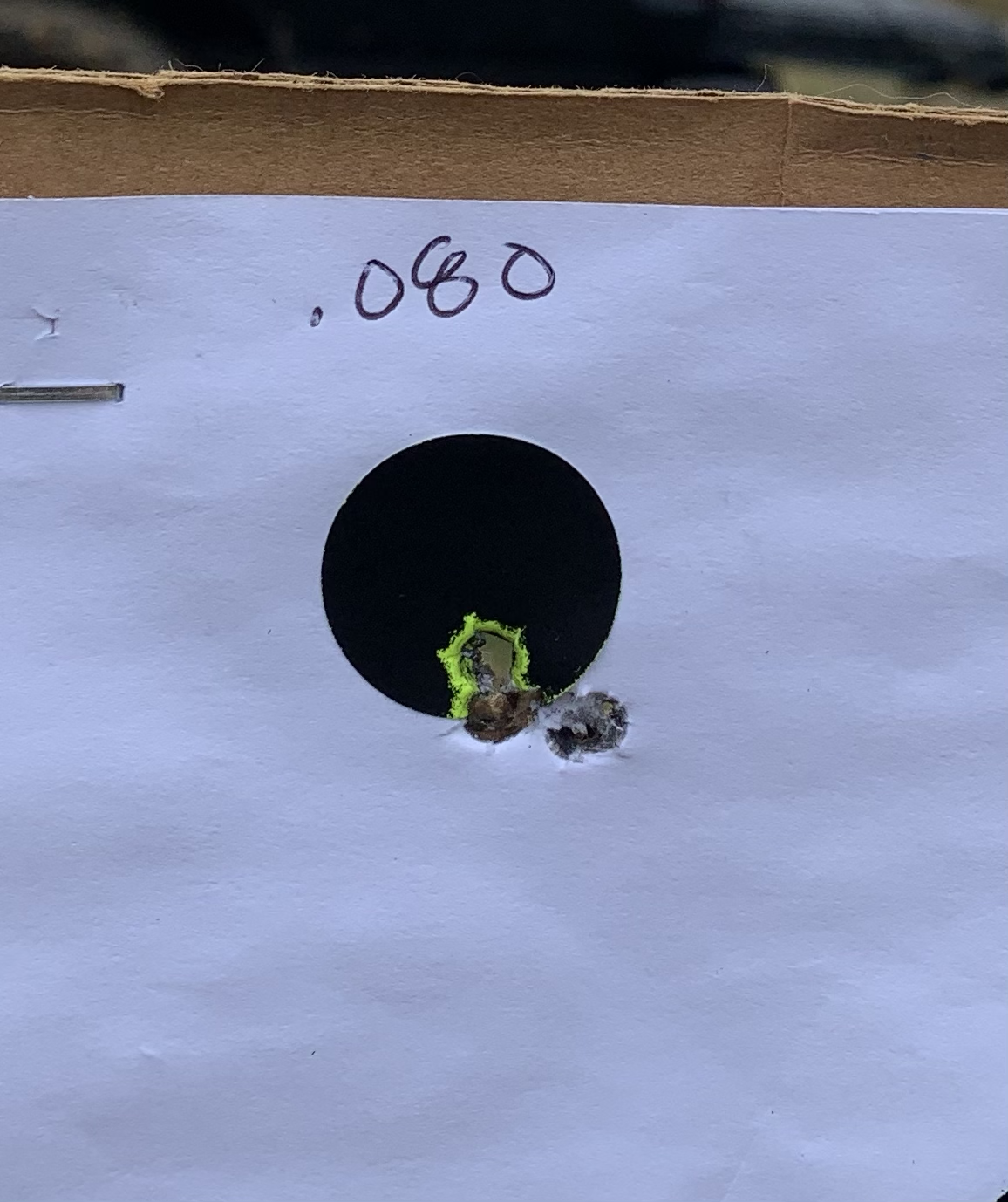

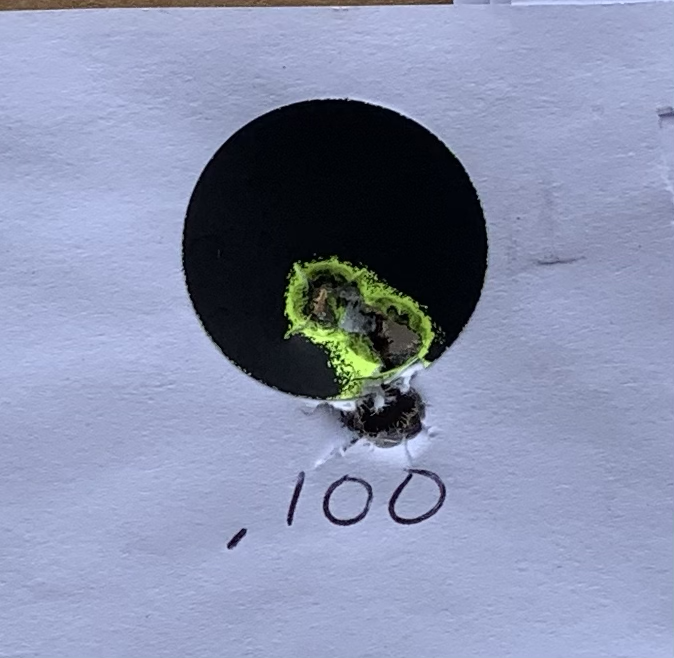

Here's a few 5-shot groups at 100 yards from today, shot pretty damn fast (maybe a minute between shots at most) and I suck mucho at shooting groups too (most of the windage is probably me). The dots are 1" and my POA was the bottom-middle-edge of the sticker:
This .120"-jump group doesn't look very impressive, but it was the last 5 rounds of the day on a hot barrel and me not really giving a shit, but the other .120" group I had shot earlier looked nearly identical, so that's all 10 rounds I had in ~.5" without trying too hard. So as the throat erodes and my jump increases I'll be "backing into" this until I make an adjustment. I'll take it.

The groups at .100" were probably the best actually... but .080" and .120" were ok too. Since by most accounts 6CM's seem to cook off their throats at a rate of around ~.005" per 100rds, starting with an .080" jump I should be good for ~800rds before I should have to mess with anything. Beyond that, I've got plenty of room in the mag to go .020" or even .040" longer on the rounds to put me right back in the jump-range it likes.

Load dev for my new barrel is done. Hammers (y)
Started with looking at jump first... then powder. Never easier. (Think I'm sold on doing it this way going forward...)
DTAC115, 44gr Sta-Ball, Hornady brass (8x fired?), CCI 200, trim length 1.915", jump ~.090" to jam, FL size -.002" bump, ~.002" neck tension, ~COAL 2.79" (CBTO 2.215" using Hornady comparator and insert #24 in my rifle 1:7.5t 5R MTU 26")
50 degrees, 30.32, 28%: AVG MV 2897fps SD 5 ES 10
10 shots, shot bang-bang semi-rapid fire (~10 seconds between shots, no cool off, no waiting):
Ballistic-X-Export-2021-03-06 16:40:04.230707.jpg

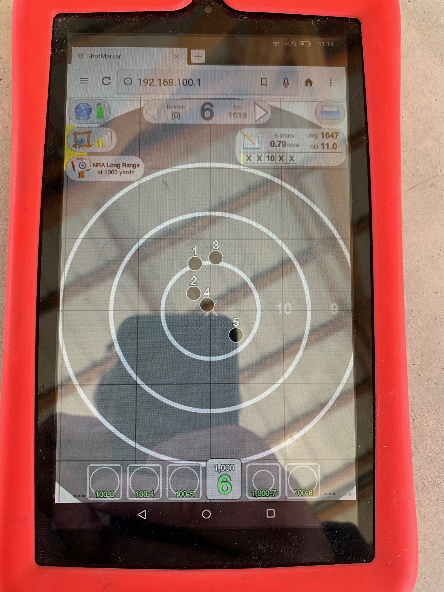

Dropped straight into cases, $50 measure, $50 scale... powder took about ~15mins to do 100rds.
1000 yards off bipod and rear bag (wasn't even the best group, just one I remembered to snap a pic of):
