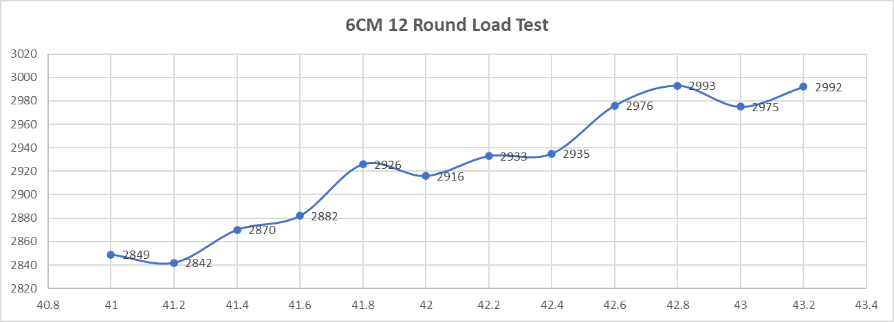

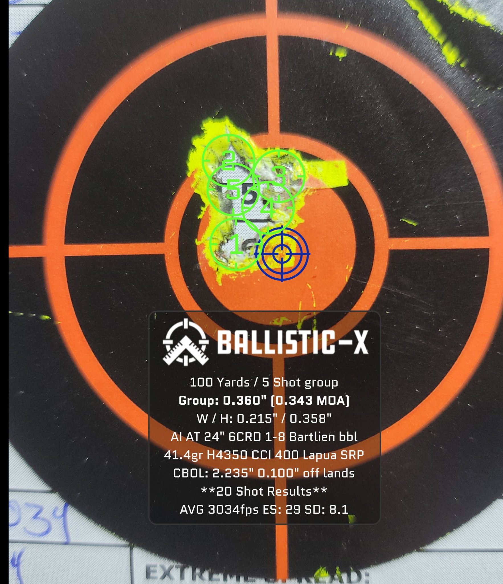

I'm jumping ~.100" (yep, one-hundred thou). For powder I'm just using Sta-Ball 6.5, 41 grains, no ignition issues.
I arrived at 41 grains with a scientific wild-ass guess and it netted me ~2900fps in the summer (TN summer = mid/upper 90's, nasty near 100% humidity). My MV has been slowing down as the temps have dropped, but not as bad as one might think since the humidity has dropped too. The gun still shoots fine so I haven't changed anything.

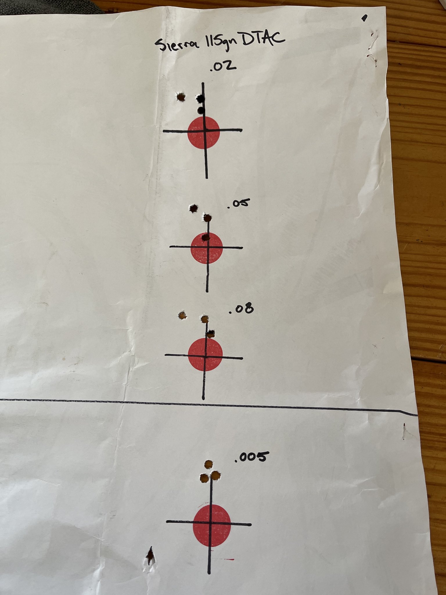

I'm also starting to load over .100" off the lands on some of my barrels. I certainly do think there's probably some merit to the idea of reduced throat erosion from longer freebores/ jumps
Yeah, something good is happening I think, shoots boringly the same, for a long time (which is great IMO).

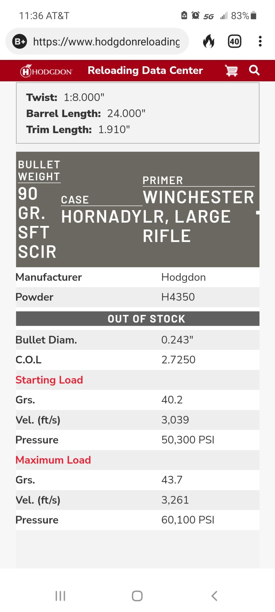

I just getting back into reloading for my 6 creedmoor, and, sadly, I am at the point of having to buy new consumables. Does anyone have any experience with Vihtavouri N540 with berger 105 match hybrids? I can get 8lbs of viht for a reasonable price, but I have only ever used 4350. It is listed on the viht site as one of the recommended powders, I just wondered if anyone had experience with it.
TIA!

Anyone have a good load with 4350 and 110 A-Tips?
Actually hoping to run them a little slower, between 3000-3050 to see how they do recoil wise.
ATips and 40.5 H4350 = 3098fps, I did no load development, shot bugholes, I,d dial powder back so my speed is around 3050. This a KRF prefit barrel for a Sake 26" .Its a fast bullet compare to 115 DTACs which Iv usually shoot.
of course start lower work up.

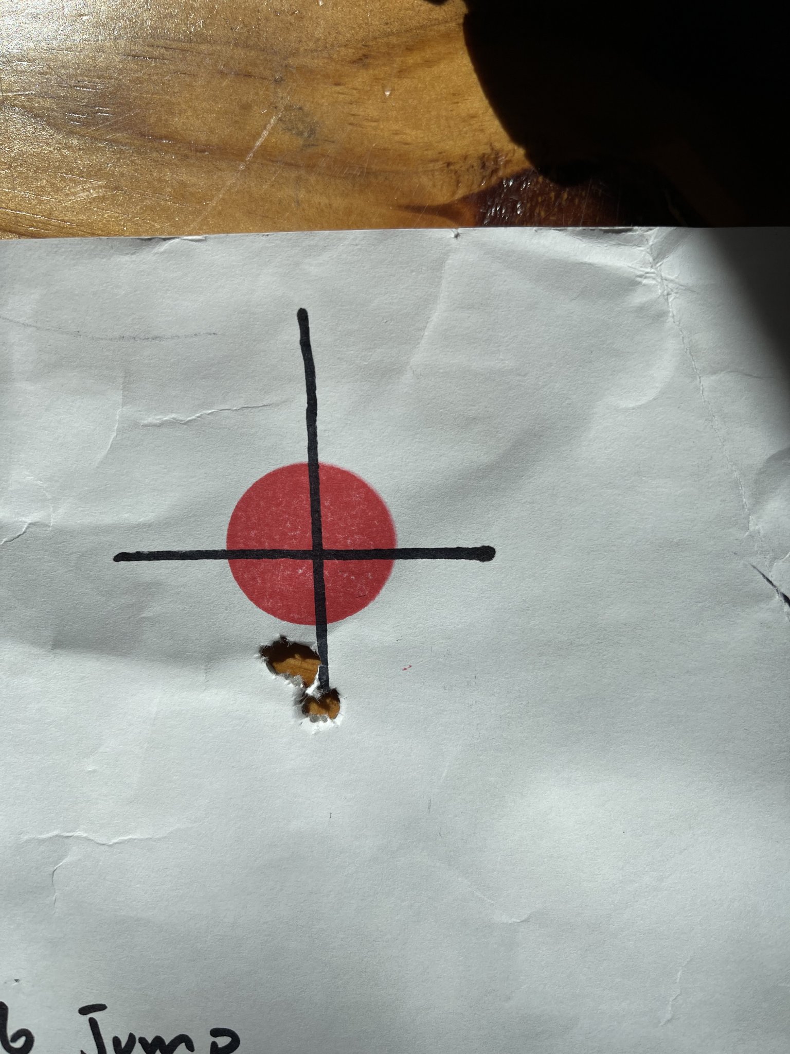

With all the talk about 6CM at Dasher speeds, I thought I would give it a try too.
Rifle: AIAT --> 26" Benchmark
Powder: 39.5gn H4350 --> 2890fps
Primer: CCI 200
Brass: Hornady 6CM --> .001 neck tension
Bullet: 115DTAC non-moly --> .005 jump
SD: 7.6
In all my other rifle loads, I use Berger bullets. Jump testing finds a standout and I'll roll with it so that was the plan with the DTAC. Testing did not seem to go well at first, so I worked my way back to the lands from a 20thou jump. Ended up with a very slight jump at .005 - so I'll roll with that for now. Was really hoping for a long jump. I guess they just like minimal jump in my barrel. Does anyone else have this experience with DTAC?
I will mention that I could watch the bullets print holes on paper, so I'm excited about the possibility of spotting trace in my scope. I've never shot a round where this was possible.

I
Rifle: AIAT stock --> 26" Benchmark
Primer: CCI 200
SD: 7.6
I’ve shot Dtacs at 2850-2890 and around 3000fps. I always jumped them from .060-.090 on a fresh barrel and never adjusted for life of barrels. At the lower speed it’s much nicer to shoot and spot trace and impacts. There’s no real performance loss at the lower speed
Reactions: impactaddict
I'd advocate trying the longer jump again, worth a try... chances are (and this goes for all of us, all of the time) the groups we see on paper are as much about how good of a day we're having, as much as anything else we're up to... that's why it's probably a good idea to try anything/everything again just to be sure it wasn't a fluke before getting locked into cement.
I've shot thousands of DTAC's (when we could get them 😩) and they worked from .060" off and further back for me, think the last barrel I ran them in liked them with around ~0.080" of jump IIRC. YMMV.
And as I've already been sort of preaching, I still totally dig running the 6CM like a Dasher... accurate and fun, and haven't missed a shot yet that I could blame on the round moving too slow lol.

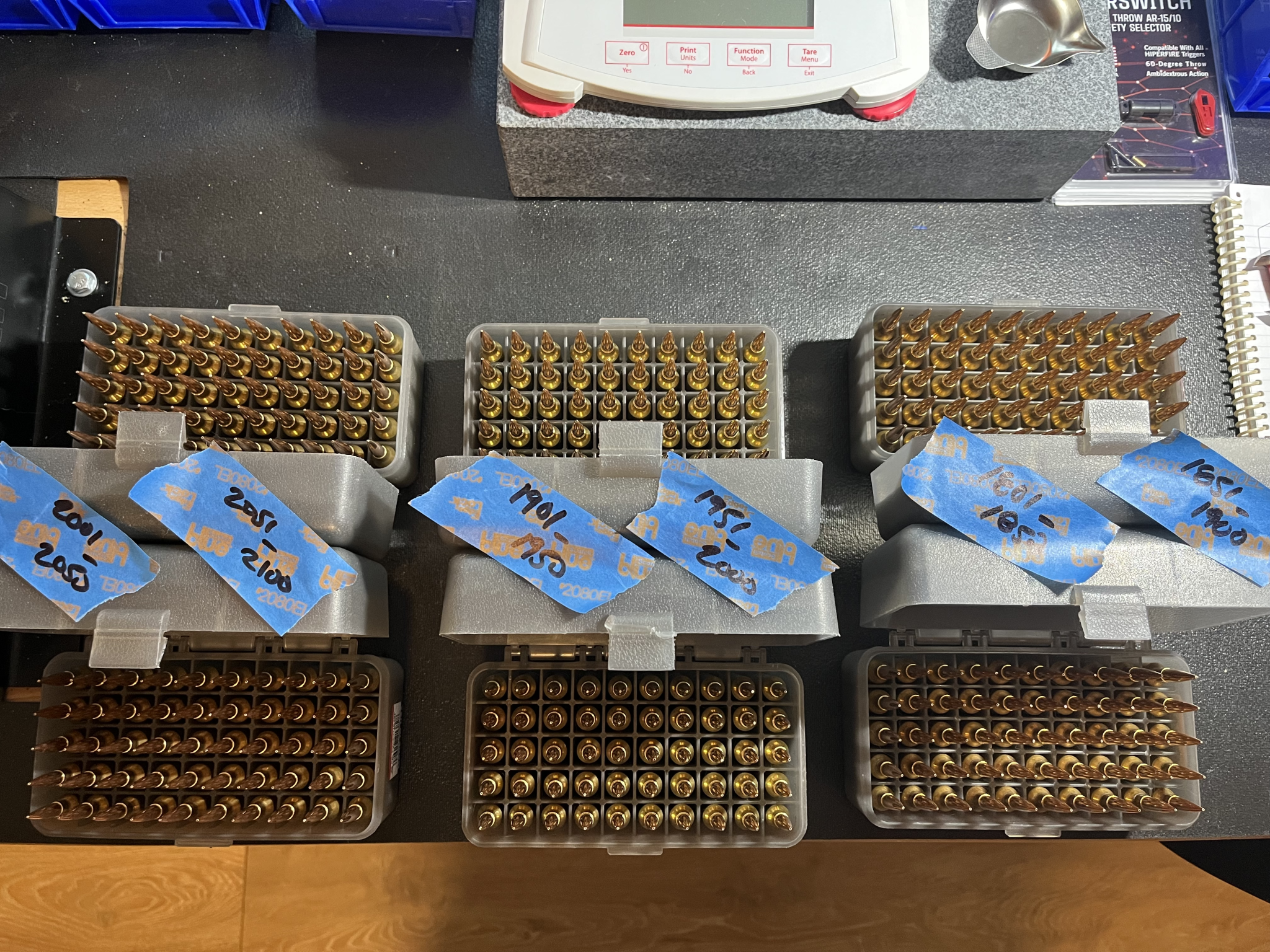

>-> To follow up on post #594 - between working too much and shitty weather, I just got my current barrel up to 2000rds.
I had a mishap with my original piece of brass and bullet I was using to measure throat erosion (dropped it and it took a good hit off the floor, then nearly couldn't find the sucker, and then ruined the bullet because I forgot to chamfer the case when resetting it). So no data for rounds 1800-1900 as I'd planned.
Cleaned the barrel/chamber at 1900rds, measured distance to the lands with a new brass/bullet combo using the Deep Creek Method, and got 2.248" BTO (BTO measured using the Hornady comparator with 243 insert).
Shot another 100rds, rounds 1901-2000.
Cleaned the barrel/chamber again, measured distance to the lands with the same brass/bullet combo as at 1900rds (using the Deep Creek Method and Hornady comparator again), and got 2.249" BTO (maybe 2.2495", or add another .0005" to be more conservative, say 2.250" ).
So, seems crazy, but by never running this barrel faster than 2900fps, never loading closer than .100" off the lands, I'm only seeing ~.001" - .002" of throat erosion per 100rds... and I'm still hitting 1/2moa plates at 1000 yards and don't seem to be having any more hardship than usual hitting anything else out to 1250.

Reworked some loads to account for a year/1200 rounds of throat erosion. I've shot 200 rounds of Hornady 108 ELD-M factory ammo and 1k rounds of 110gr Atips w/41.4 gr of H4350 0.030" off of the lands.
By my figures, I had 0.032" of throat erosion in those 1200 rounds.
I measured the distance to the lands w/a Hornady tool, then loaded 41.4gr @ 0.030, 0.060, & 0.100" off of the new measurement. Surprisingly, the 0.100" off of the lands shot the best, picture below.
AI AT 24" 1-8 twist Bartlien bbl
110gr Atips
41.4gr H4350
Lapua SRP twice fired
CCI 400
CBOL: 2.235"
  • Ballistic-X-Export-2022-02-27 19:11:48.551638.jpg
Hey Everyone, I am working up a load for my new MPA BA PMR Pro in 6CM. I have done an initial seating depth test, and found that the rifle really likes .050 - .060 off the lands, so that is where all my rounds are are seated. I just did a 12 round load/ladder test this afternoon, and want to share my results for some feedback. I dont want to go any higher in velocity and want to keep it below 3000fps, which my test has done. I am wondering if I should try out a 5 round load test between 42.2 and 42.4, or possibly between 42.8 and 43.2 (see chart). Any feedback is appreciated. Thanks!
Components are: Hornady 108 ELD-M, Hornady brass, CCI 200 primers, WinStaball 6.5 powder. Brass is all FL sized, trimmed, chamfered.
